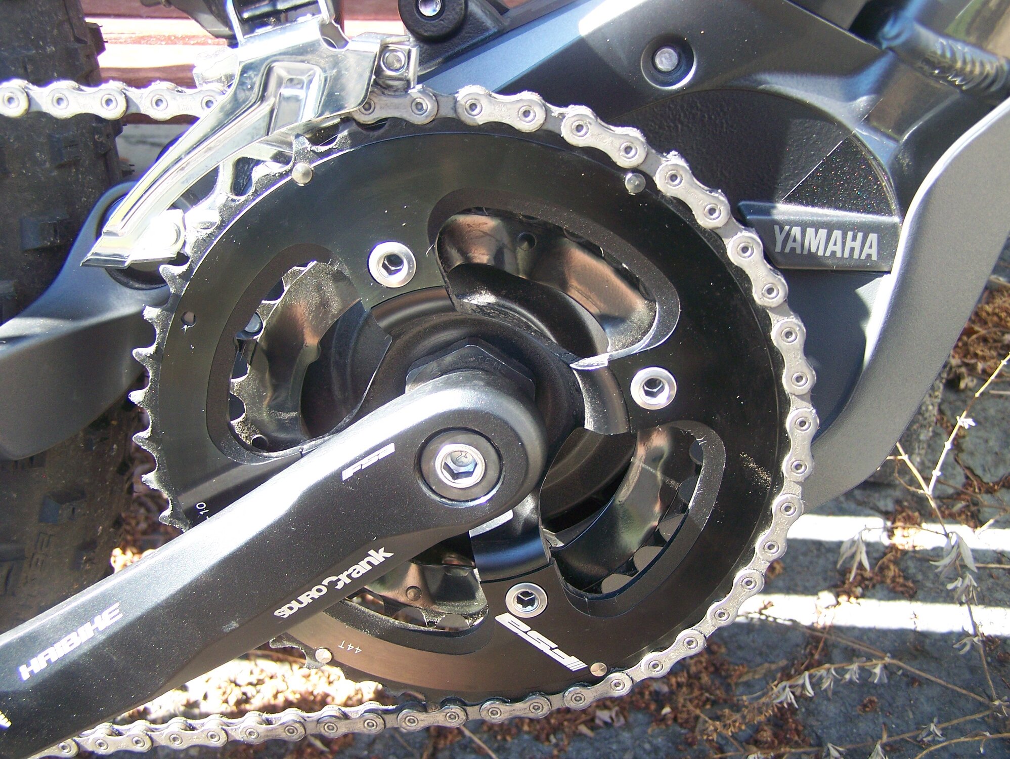

Bikes like these that come from a closed, proprietary ecosystem generally have barriers to doing something like changing their gearing. Bosch systems for instance. Bosch-allowed changes have to one of a few approved factory chainrings with only a couple of sizes available. The system then has to have its firmware flashed by an approved dealer.
Gearing changes are a simple thing people take for granted, but when you buy a bike like this you may find out there are limits imposed that you never expected.
And a gearing change is likely going to mean he kisses goodbye his top speed. My hill-climber bikes do by necessity. I'm fine with that, but that doesn't mean someone else would be.
Its a perfectly fine ebike... for someone else. It can't do the job being asked of it, and its pretty easy to see why with the low power it provides. Its fine for the seashore or somewhere flat or with low rolling hills.
