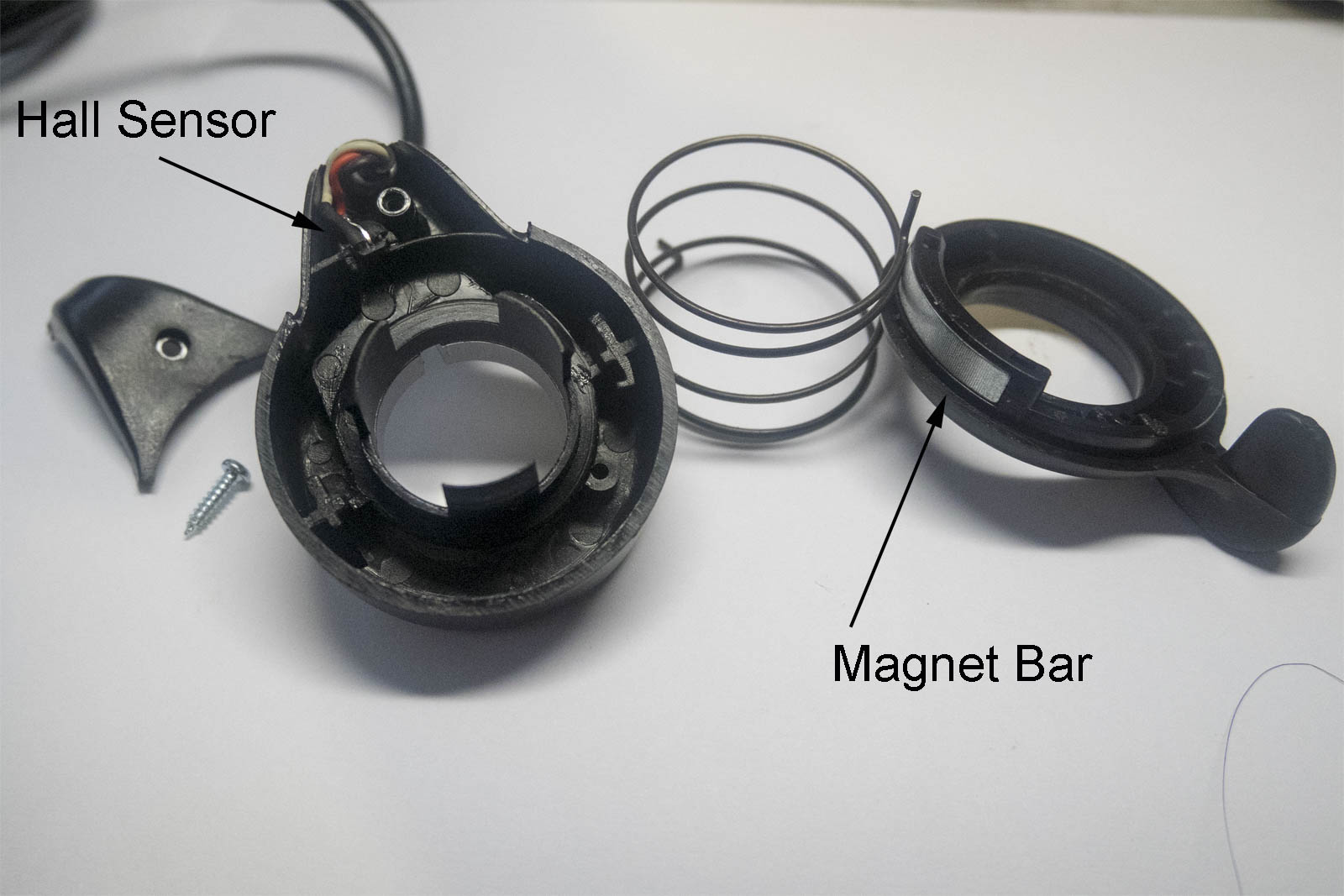

The throttle is a cool application of a magnetic sensor chip.
There's a magnetic ring that rotates past the chip,.
The chip is a three wire device, with power, ground, and output which varies from a half volt to 4 volts depending on the magnet position.
The parts probably cost about 50 cents, and it took me about a half hour to reassemble properly after I opened it up.

Thanks for showing me the innards! Spurred me to look up the Wikipedia page on Hall sensors. Never realized how indebted my daily life has become to Edwin Hall. Hug a physicist.

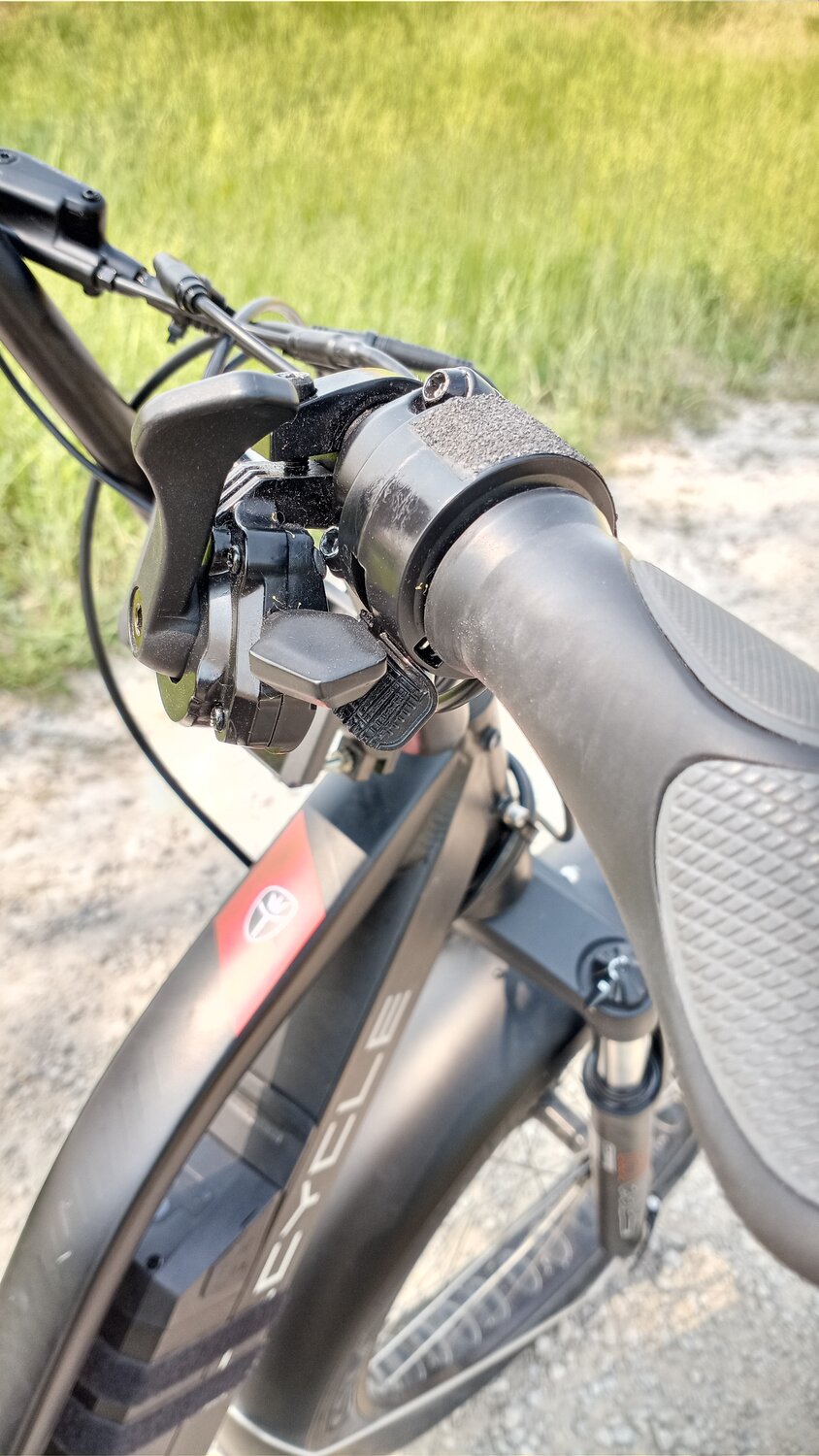

Yeah, this new-found progressive throttle technique is turning out to be a pretty handy riding tool. If I plant one side of my thumb on the throttle housing and roll the other side onto the lever, I can hold a desired boost pretty well, though probably not as reliably as you can.
This is exactly how I manage a thumb throttle! Works to hold the throttle steadier/especially well in bumpy terrain or when managing BIG power (e.g. 150+hp snowmobiles and other high powered off road toys, ALL of which use thumb throttles).

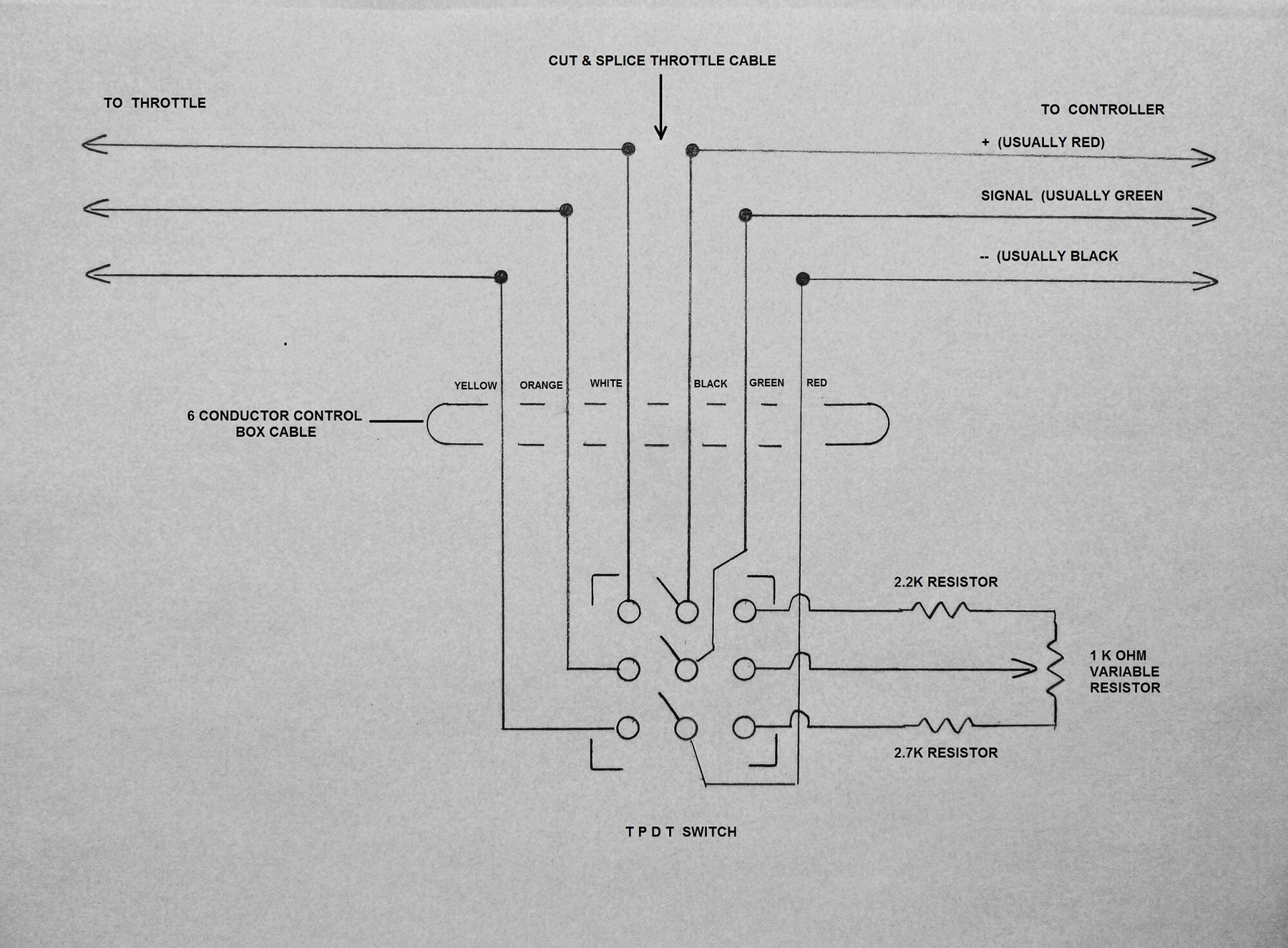

If you're a DIY'er, you can emulate the throttle hall sensor using a simple voltage divider circuit
That way, you can dial in any speed using a rotary variable resistor. The switch lets you choose between throttle or "cruise control"
I use them on all my bikes. Here's a link detailing how it's done:

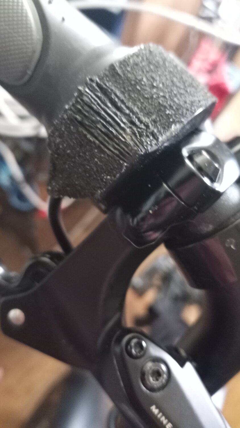

That's what I do as well.
I can give my throttle housing a tiny nudge to increase or decrease my speed by ½ kph increments.
I glued sand paper to the housing and melted lines in the plastic with a hot knife to give it more grip.
The housing is pretty snug against the handlebar so it doesn't move by accident or vibration.
