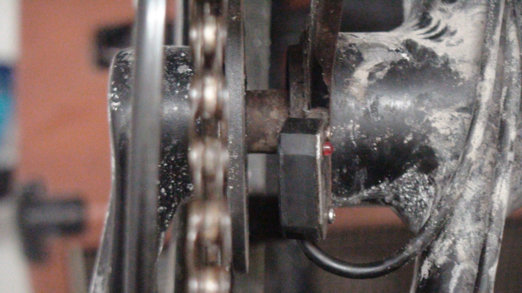

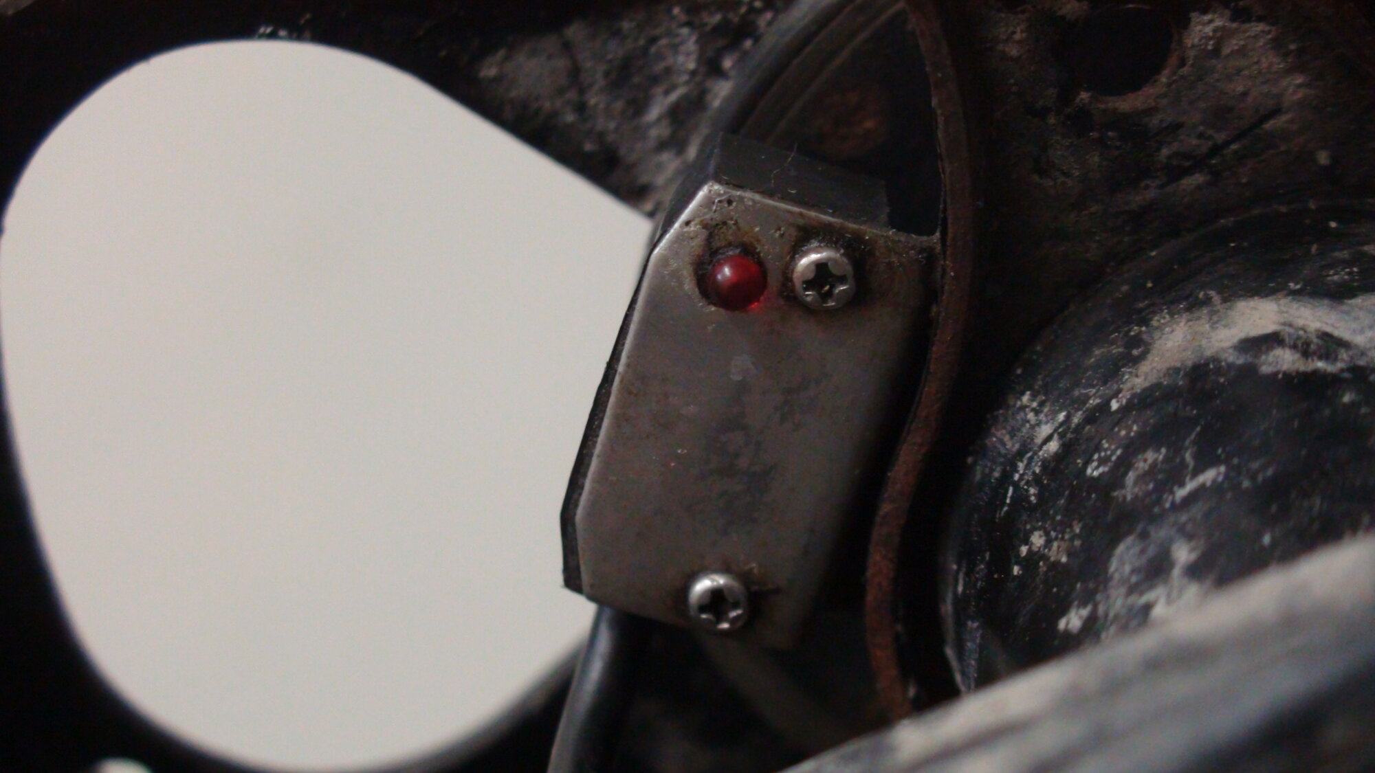

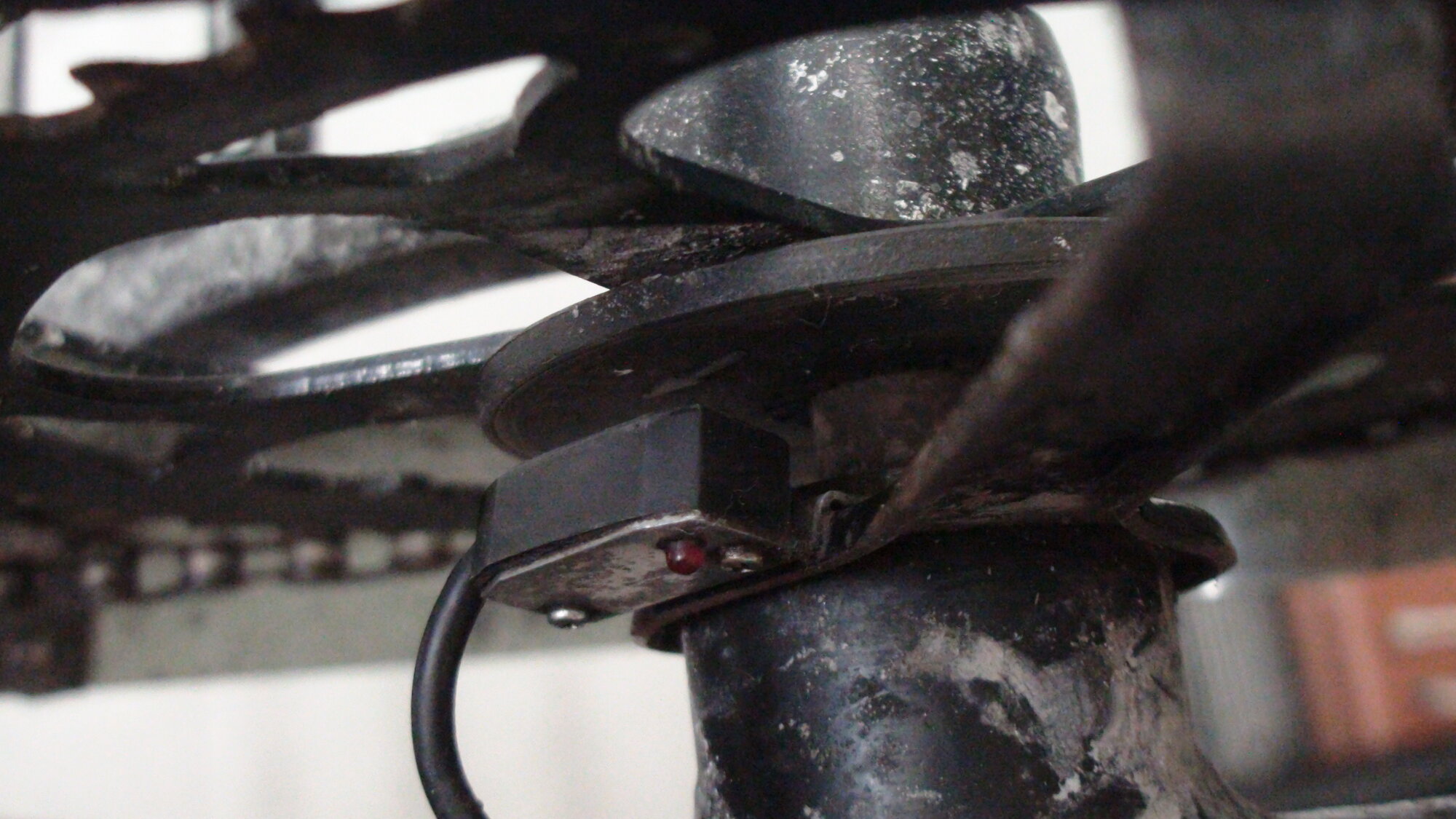

I'll post a few pics in a few minutes.
I am wondering if the sensor is close enough to the magnets. BUT i am quite sure nothing moved the sensor out of position Besides, it's really "rigidly" in place - it doesn't move so i doubt anything moved it.
However, i am also wondering about those two screws on the sensor. What if, just if my sensor IS too far away from the magnets, could i unscrew those two screws and bend the metal "sensor holder" closer to the magnets and then screw the sensor back on. Or will unscrewing those two screws unleash a Pandora's box of trouble. I don't want to try to bend it while the sensor is attached because i think it might snap off.

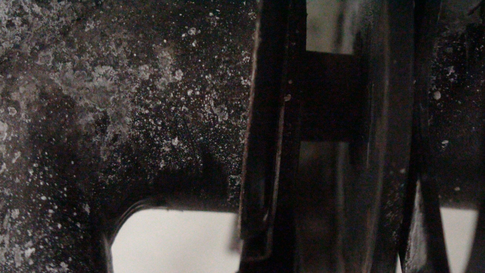

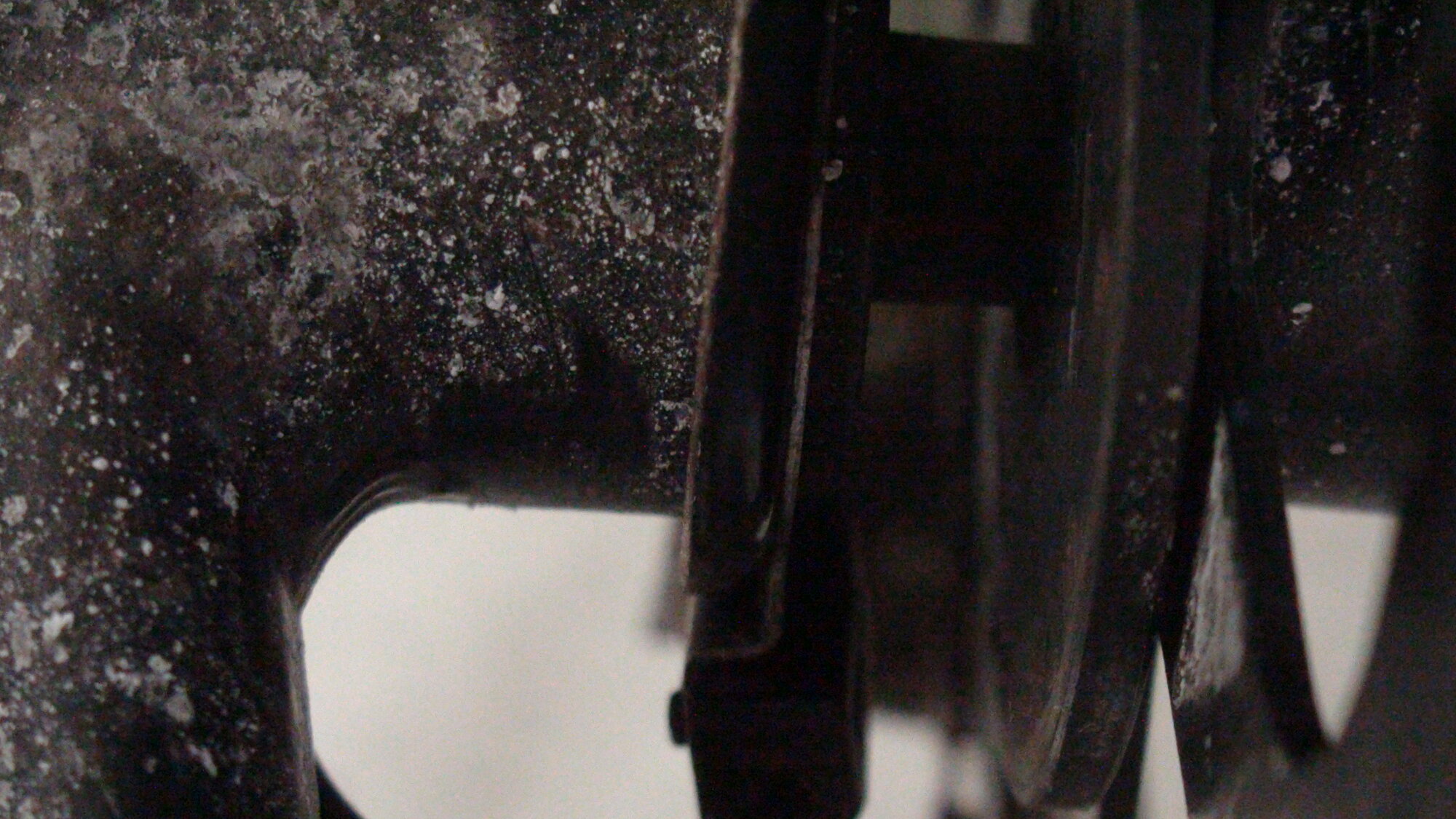

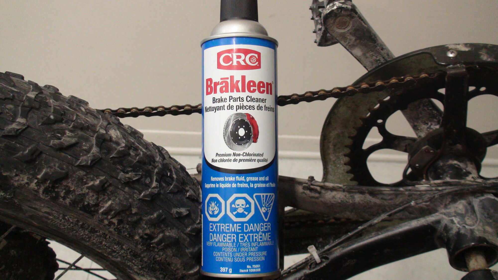

I posted some pics further down. I saw the product you suggested and i see it's alcohol based. Is that going to make a difference since using the brake cleaner and the rubbing alcohol. It looks pretty clean, now. (boy i have trouble using this forum. The quote function is kind of confusing. It's different from other forums.)
Possibly not. Brake cleaner depending on brand/type can be a bit rough on some things, while the CRC is pretty much 'safe for all things' IMO. If it's got wires or a PCB near it, I use the CRC..

I just checked the brake cleaner brand. Here's what i used.
At least it's not the red can (chlorinated). Some fun reading, but basically I'd get the contact cleaner for future use... I did go to look at the MSDS and info linked from the second link below but came up blank so some guessing involved.. YMMV

These two pics show the sensor "brace". Does it look bent?
