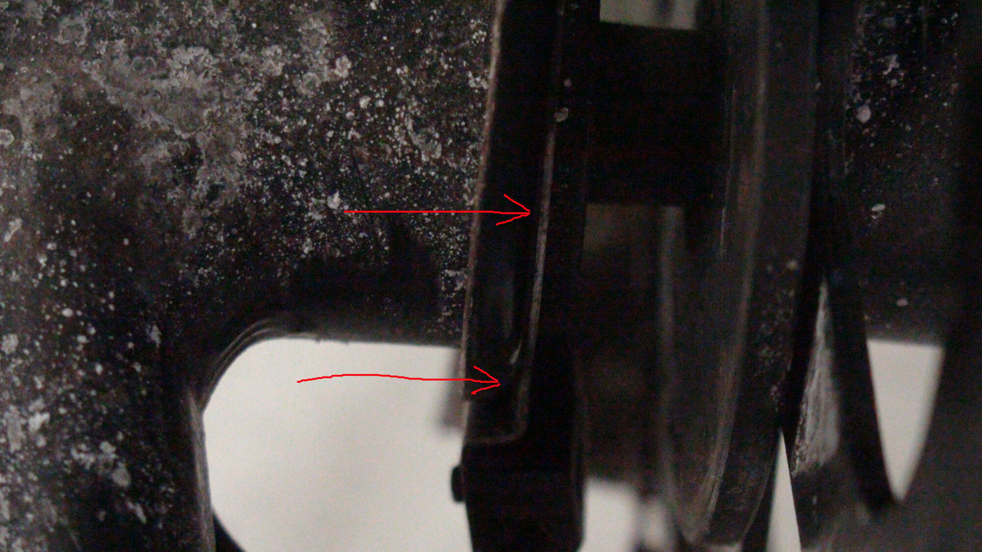

As i mentioned several times, i doubt the sensor got moved away from the magnet wheel. I posted pics of the brace that supports the sensor. It doesn't look like it has been bent. I was only oiling the chain, so nothing moved the sensor. As i mentioned before, it's really rigid in place, the thing does not move.

Geez, i dunno. Nothing banged the bike overnight as it sat in front of my apartment door, unless my janitor did something to my bike. But why that and why then (such a coincidence after i just oiled the sensors). Did you see the pics of the sensor brace?...it looks straight to me. I reposted the pic here for you.

Use your thumbs. Try first moving the magnet ring out, to within 2mm of the sensor. Magnets work at the square of the distance. At 12 mm it does nothing. If it does not budge than bend the sensor to within 2mm of the magnet wheel. What happened is oil got onto the crank arm bb shaft and the magnetic ring slid out of position.

Ok, it's a bafang hub-drive motor. Your pic of the speed sensor doesn't look like a Bafang mid-drive sensor. This is a typical Bafang motor mid-drive sensor. Might have to do some searching on greenbike or maybe post a pic of the other cable end etc. unless someone can confirm a different sensor part..

Ohhhhh. i just did what you said and the magnet wheel moved. I moved it closer to the sensor. Wow. It WORKS.
