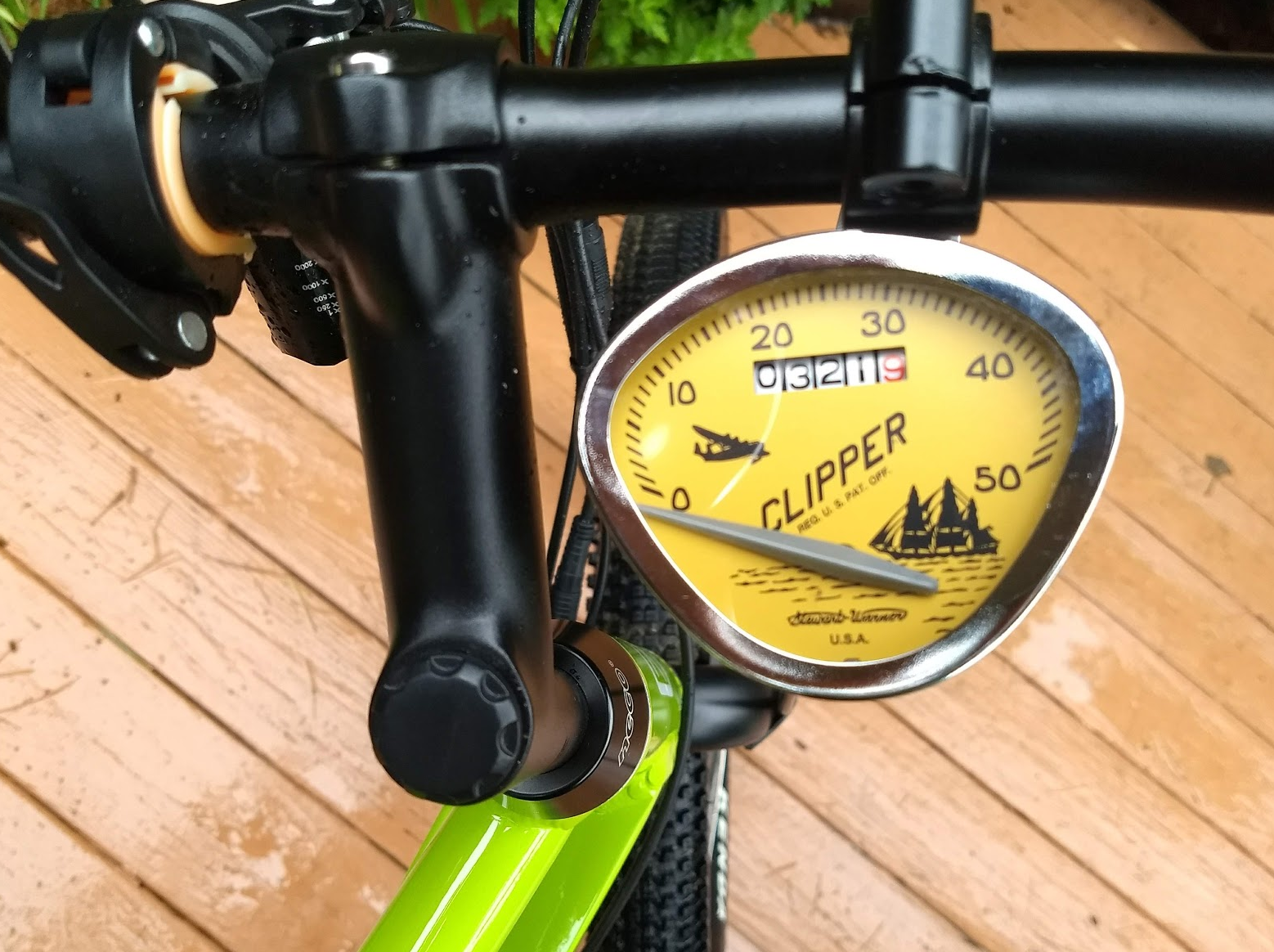

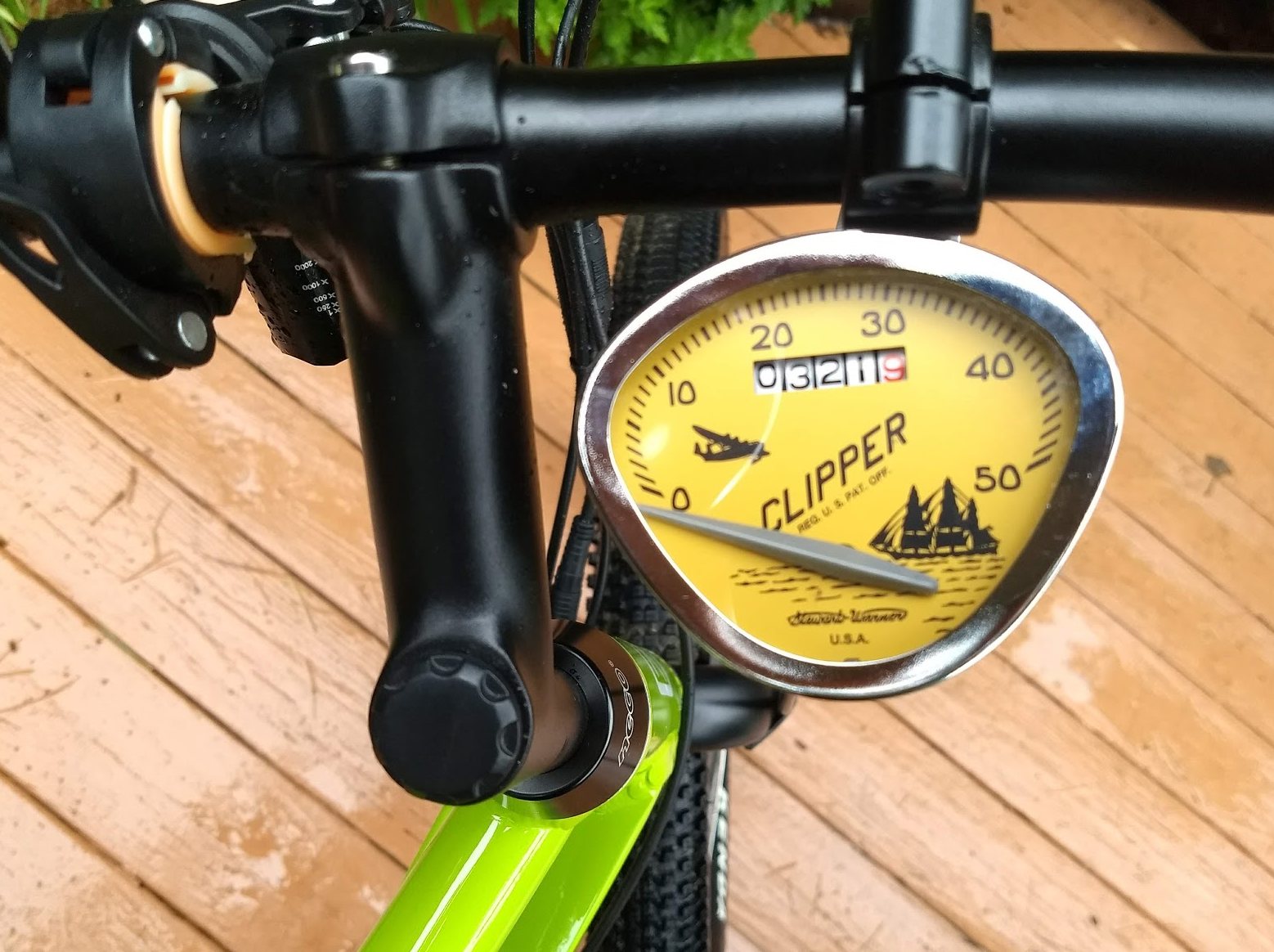

Miles are estimated at ~400. Screenshot 2018-08-13 at 10.16.52 AM.png I like the analog speedo.

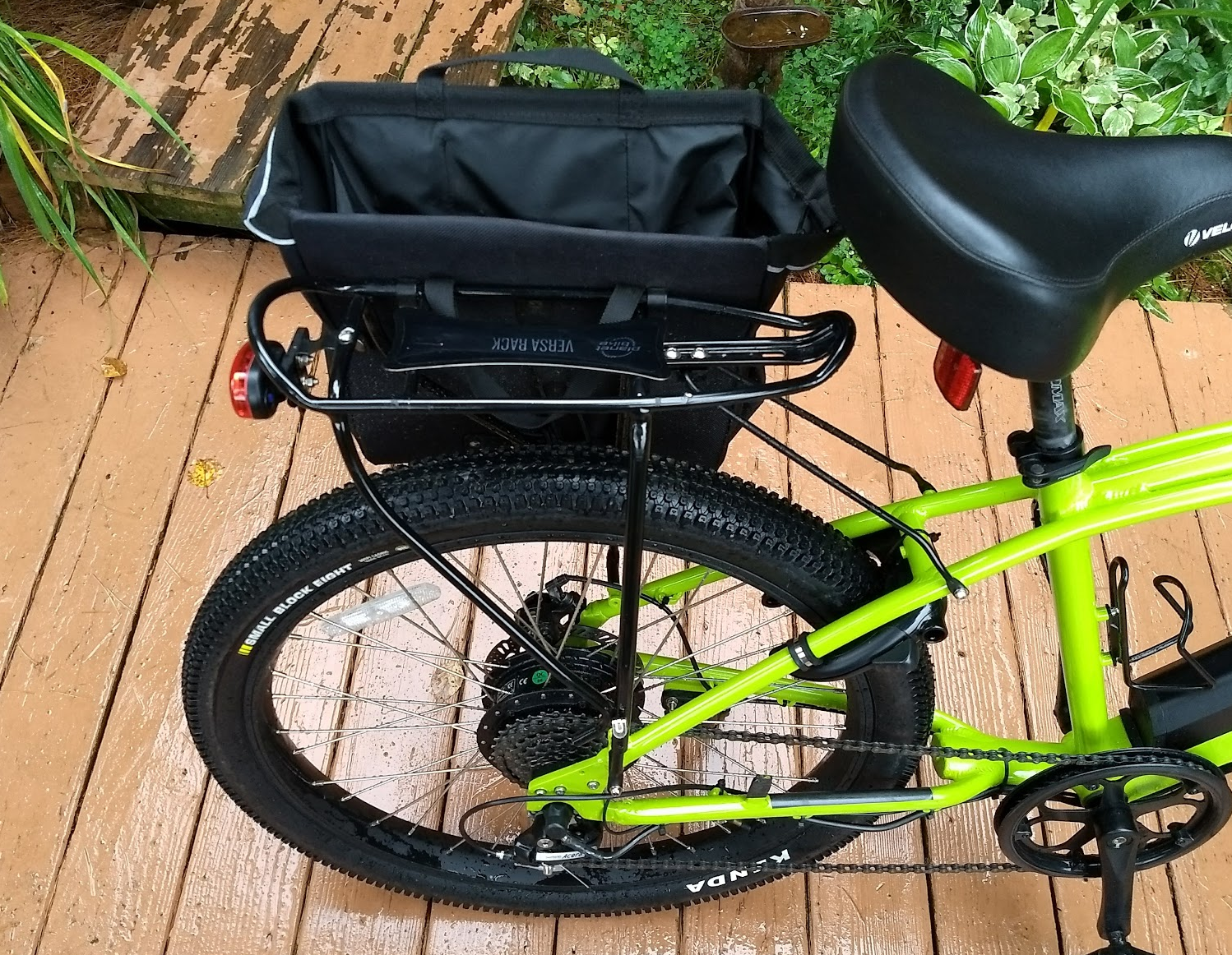

Bike rack for my bike only.Screenshot 2018-08-13 at 10.48.03 AM.png plus pannier.
Speedo above and one for my wife's bike.Screenshot 2018-08-13 at 10.50.14 AM.png

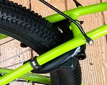

Locks on both. Screenshot 2018-08-13 at 10.52.10 AM.png Has a cable insert to secure to rack.

Miles are estimated at ~400. View attachment 24560 I like the analog speedo.

Bike rack for my bike only.View attachment 24562 plus pannier.
Speedo above and one for my wife's bike.View attachment 24563
Locks on both. View attachment 24564 Has a cable insert to secure to rack.
