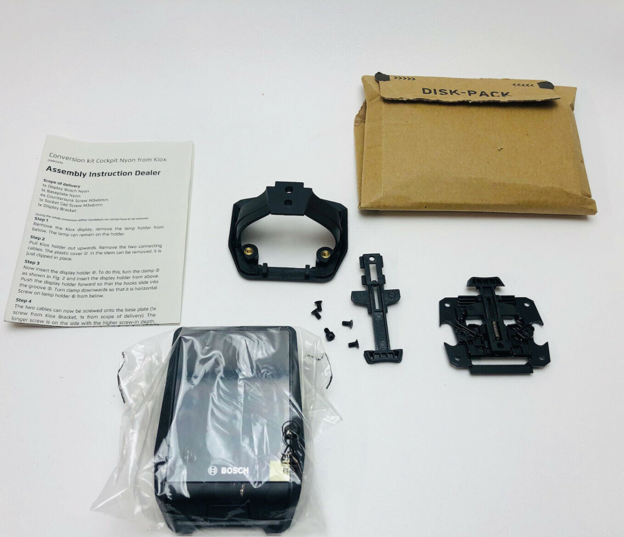

We've reached out to R&M for clarification as to whether or not the attached piece is included in the new kits (VBK0372) and also reached out to Bosch to see if it can be sourced by itself if it turns out not to be included.
Really hoping an entire Retrofit Kit isn't required for this one part + the display.
