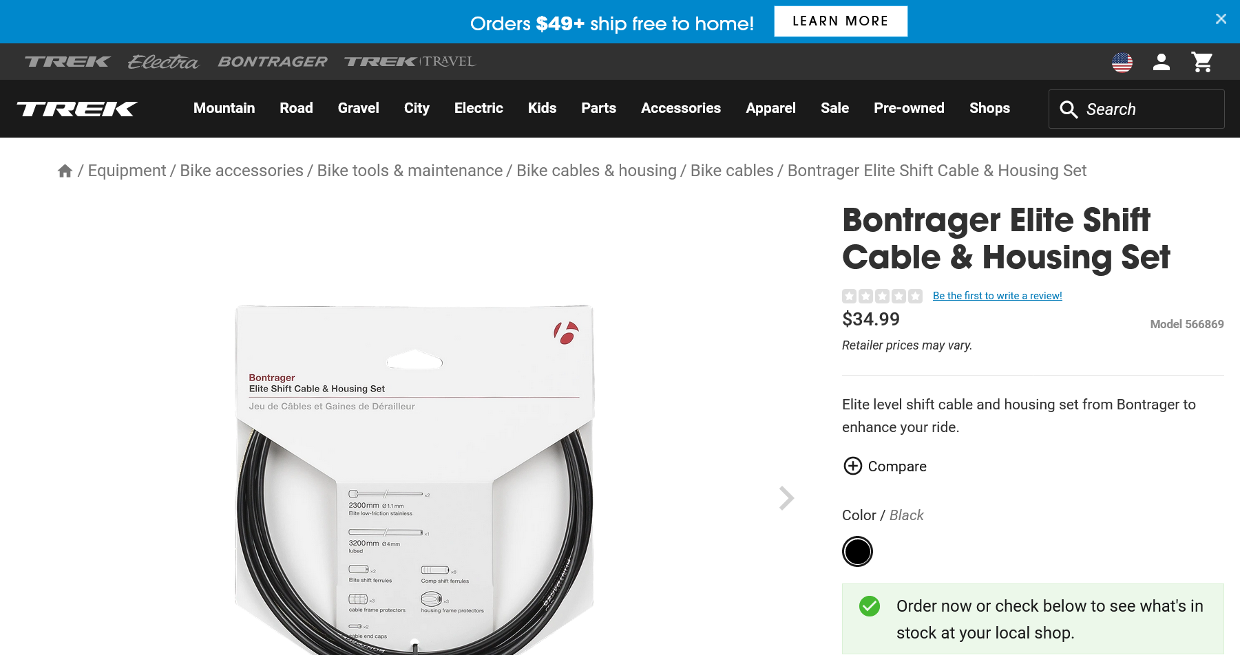

I had this on a bike. It was routed through frame. Shift cable comes in all classes. Big box store bikes typically have under $2 cables with junky housings. An NX level of build IMO deserves the good stuff. You will notice and appreciate the difference with high-end housing and highly polished, non-stretch cable. My technique may not be the same as what others do. I would first extract the housing, leaving the cable in place. Then I would use shrink tube to attach the new housing to the old cable to guide it though the frame. Then I would route the new cable through the new housing with CLP gun oil inside the housing. The derailleur has the lock button. Lock it. Be careful to route the cable through the little hole and around the pully. Oh, make sure that the shifter is set to the highest gear before doing anything. Use needle-nose Vicegrip to pull the cable while securing it. If the rear barrel adjuster is in a middle to fully lax position you can adjust the tension either way. The Bontrager Elite Kit from your local Trek dealer gives everything you need and it is the good stuff.

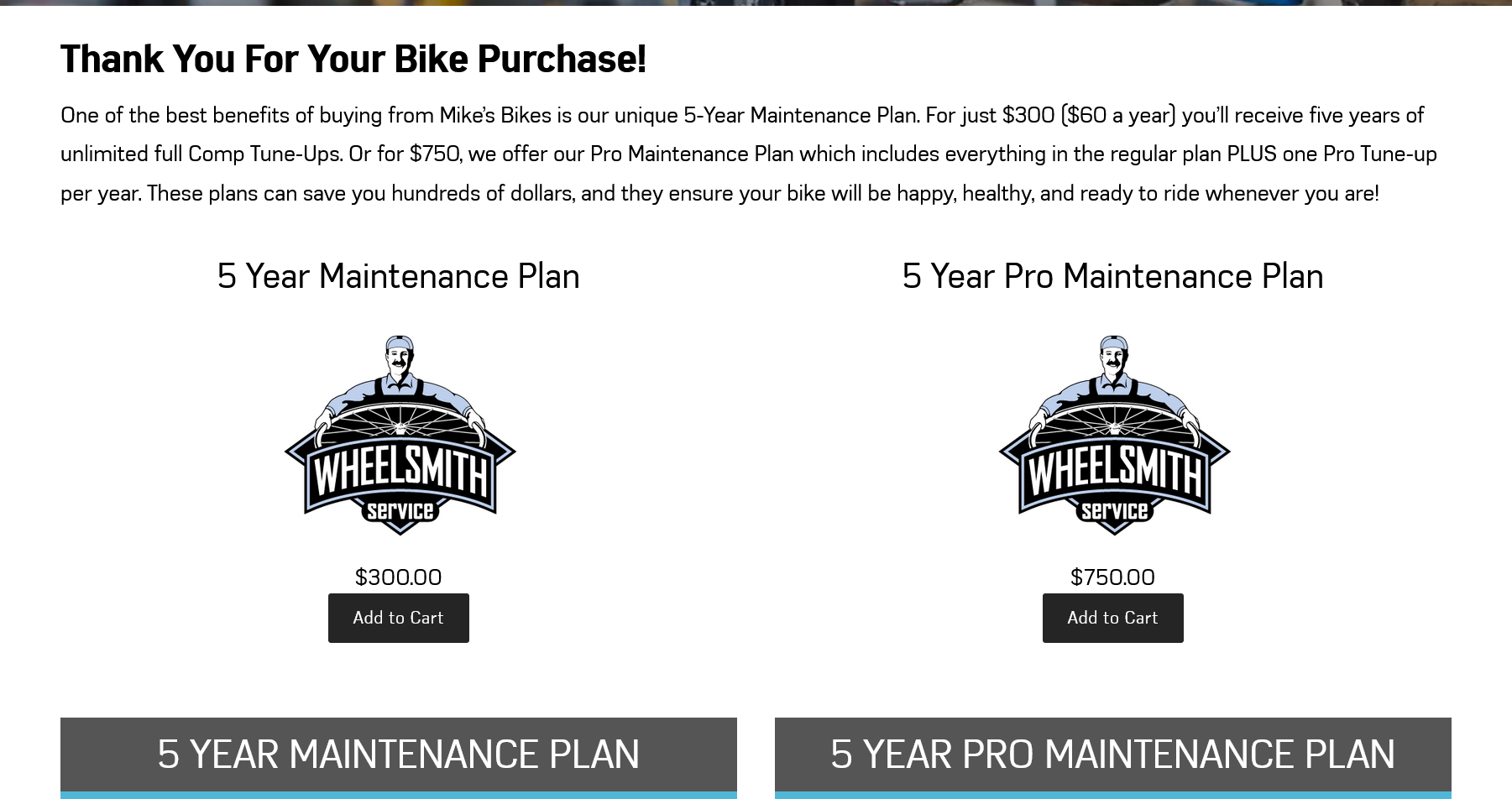

Around here there is a shop that will sell you an electric bike with a $600 five-year maintenance plan. The plan does not cover any parts. It also does not include the motor, battery, display, wiring or anything electronic. It also does not include ware and tear items. It is not transferable.

I was wrong. A little self-doubt goes a long way. It is $750. When it includes a 'Pro' tune-up.
Sounds expensive, at first. The Pro plan would be great, because you’ll have issues taken care of before they actually become an issue (in theroy). The real bummer is when a repair has your bike out for multiple days or you wait for parts.
