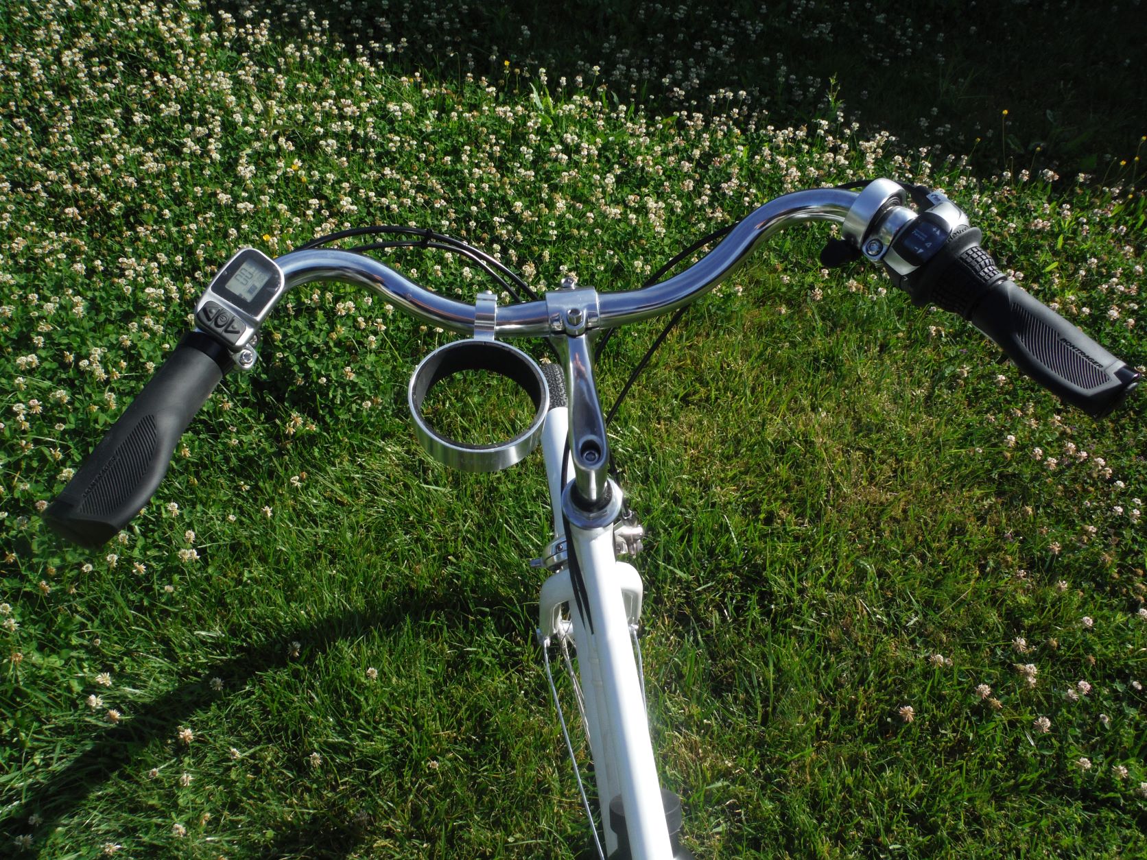

I will be making a house call to repair a HB throttle bike today. I am not opposed. But, HB throttles are just not needed for most riders. HB is handlebar. If it is in your foot with pedal pressure like a car, not cadence, than it is redundant on the HB. HB throttles detract from the aesthetic of a bike because they require more and thicker wires and a messier cockpit. It makes practical sense to just shift the throttle into the pedal. Yes, a case can be made for hand controls with cars too for certain cases. Push foot go.
LOL, HB?.... Where else would you have the throttle???
