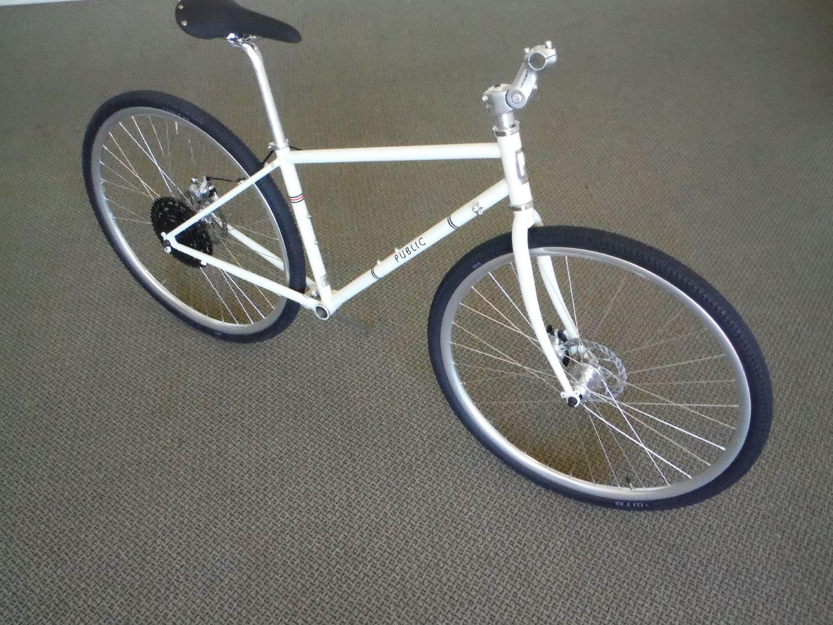

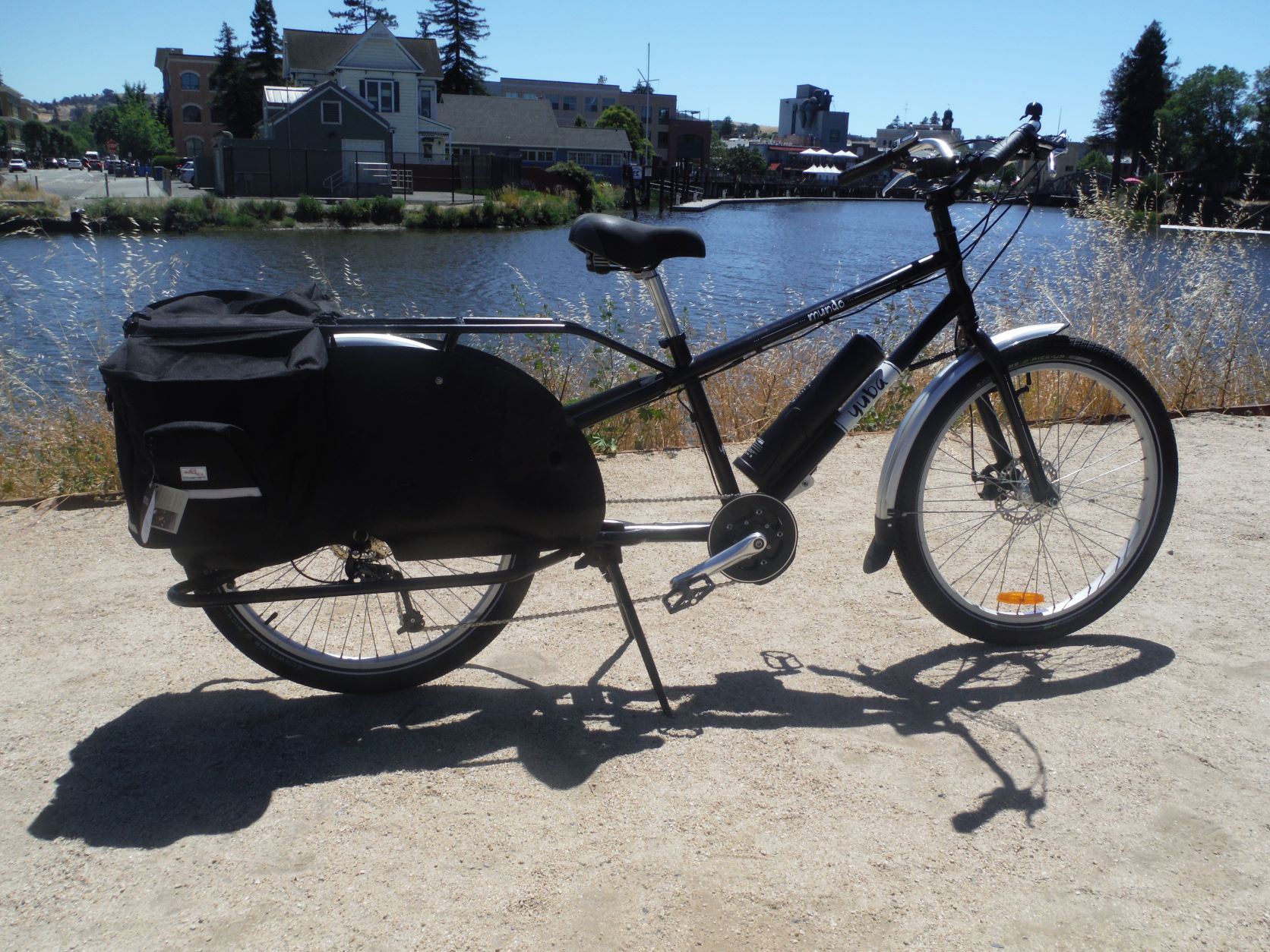

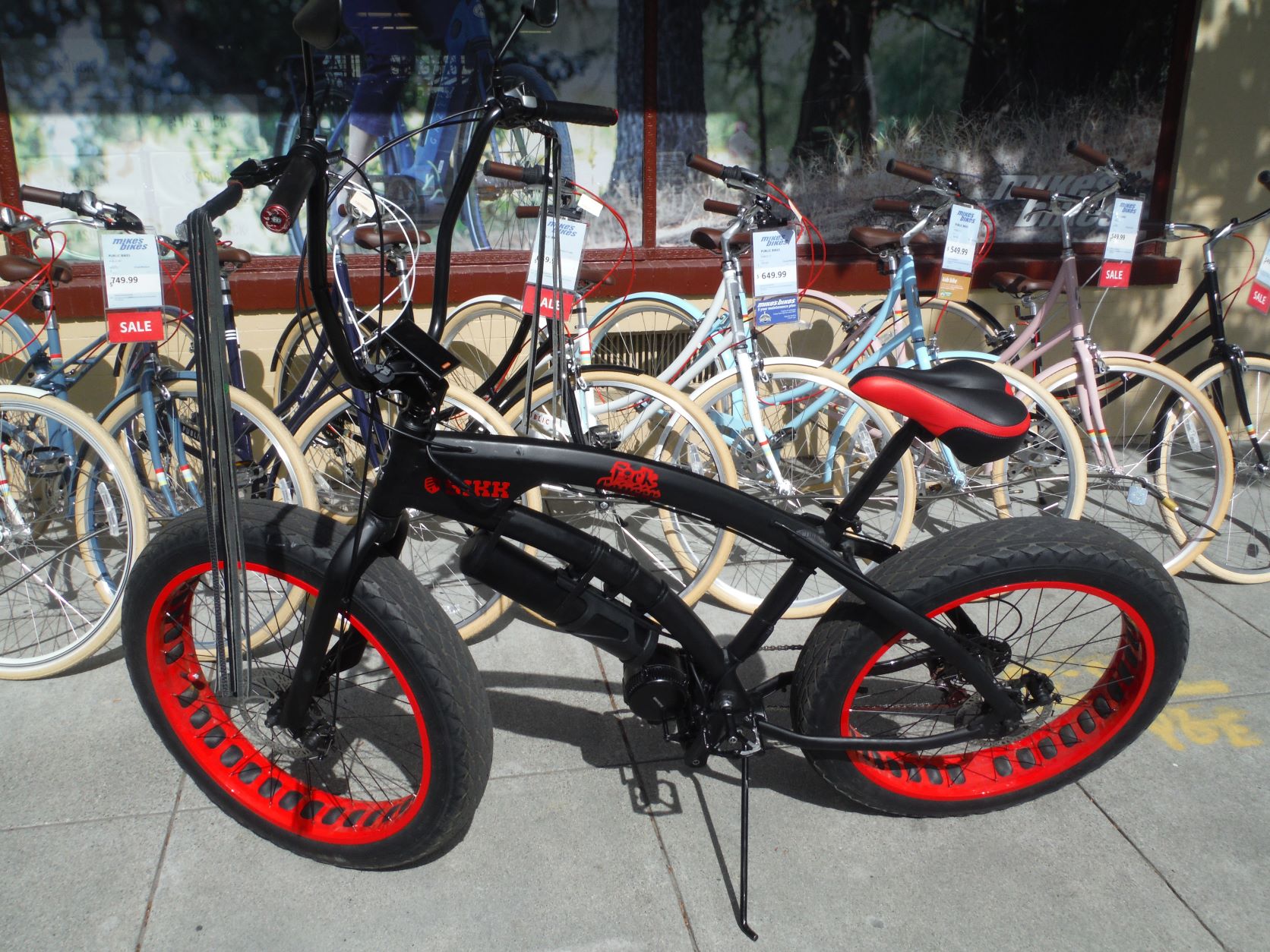

I am making one today with disc brakes, comfort bar, road style frame that will be Class 1 or Class 3. The chain guard will be a polished chainring. If you are visiting the interior flats you can manually swap to it and do 28. For the SF Bay mountains and Western Marin/Sonoma hills use the smaller interior ring and at a cadence of 80 steady climb 15% grades at 5 Mph in Class 1 mode.

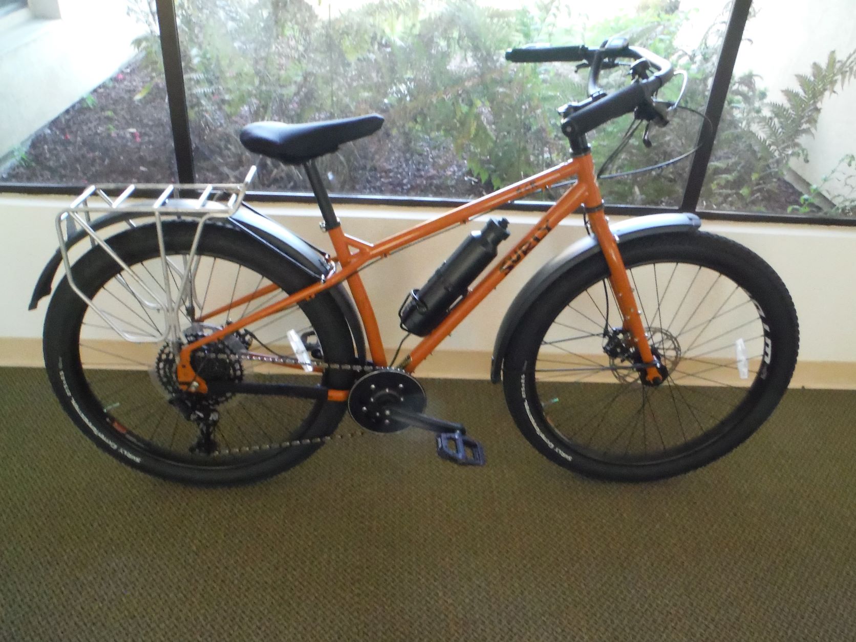

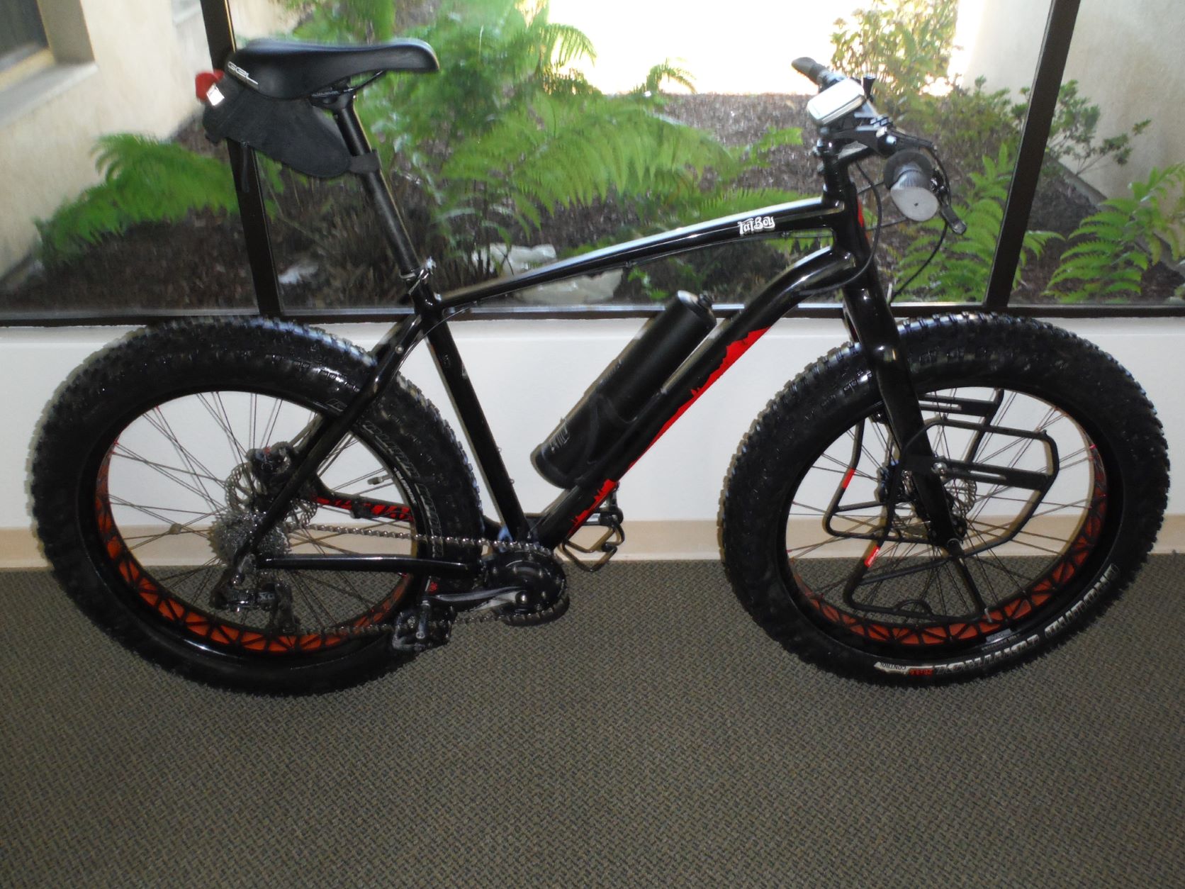

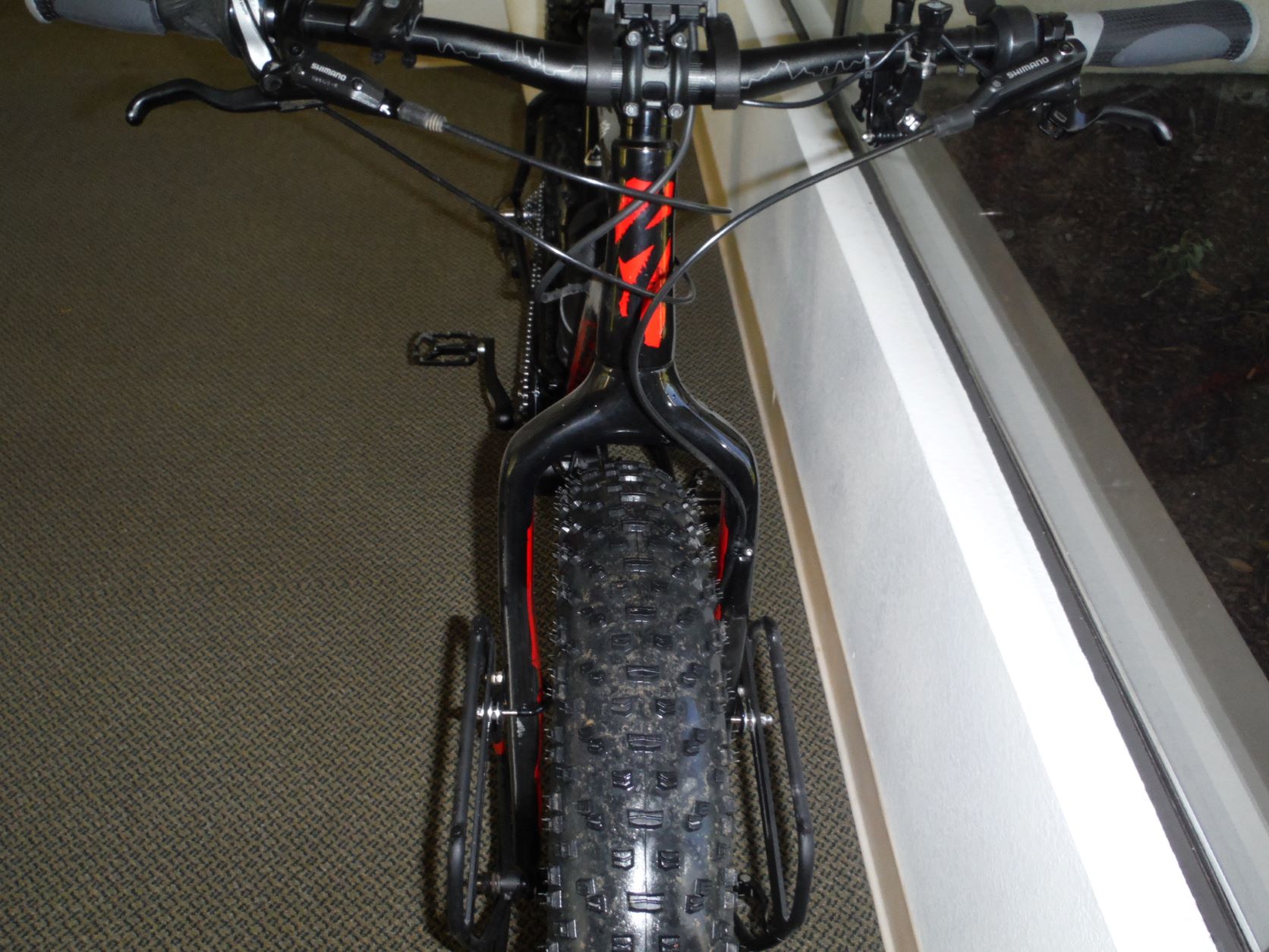

This one has a throttle. But the ring is 36-t so it will only do 20. It is meant to be a climb monster. These tires can pull a skier. They are 115mm's wide. That is 4.5 inches. The PAS wasn't working. It had water incursion. I replaced the internal controller and most burred part, the torque sensor. PAS still was not working. A head scratcher. The cadence pickup was 1mm off from the magnets. It won't use the torque signal alone. So, if you are stopped at an intersection with your foot on the pedal, it won't launch. You need to be moving the pedals And applying torque. Now it tests perfectly.

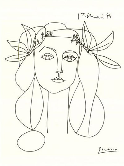

I knew it was legit at first sight. When I was a little kid I was a Picasso fan. We had a book about him showing him in the creative process, living with goats and models, gardens and studios, creating art and living artfully. We were not far from NYC and my mom was an artist so, she would take us to museums and galleries. People in my opinion get confused. They are so used to being in a commodity mindset. Art is a verb, it is the act. An artifact is what remains like a discarded shell or a snake's skin after it molts. This is the second one I am working on today. The bar order didn't go through because of a very nice new clerk, so I will have to wait until mid-week for it. The rest will be ready for that one last component. Thank you @Djangodog! That is the highest complement. Each bike is different because each ridder is unique. The first time I saw a flounder with two eyes on the same side of its head at age six, I declared it a Picasso. He could also capture an essence in minimum. That is very hard to pull off.

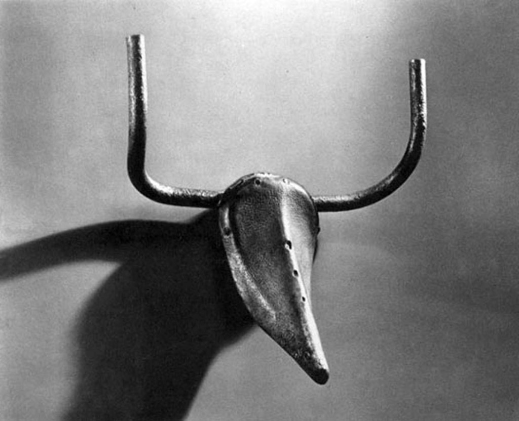

Picasso had a Bianchi bicycle in his Vallauris studio and thought of it as “one of the most beautiful and purest sculptures in the history of art.”
Who would disagree.
