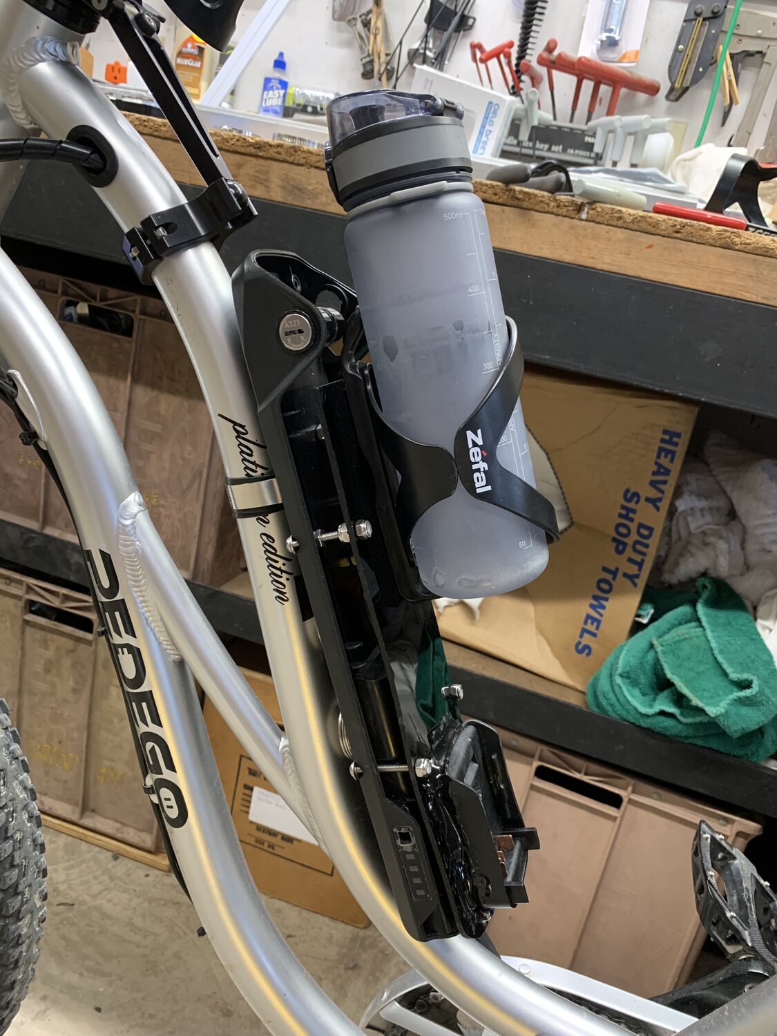

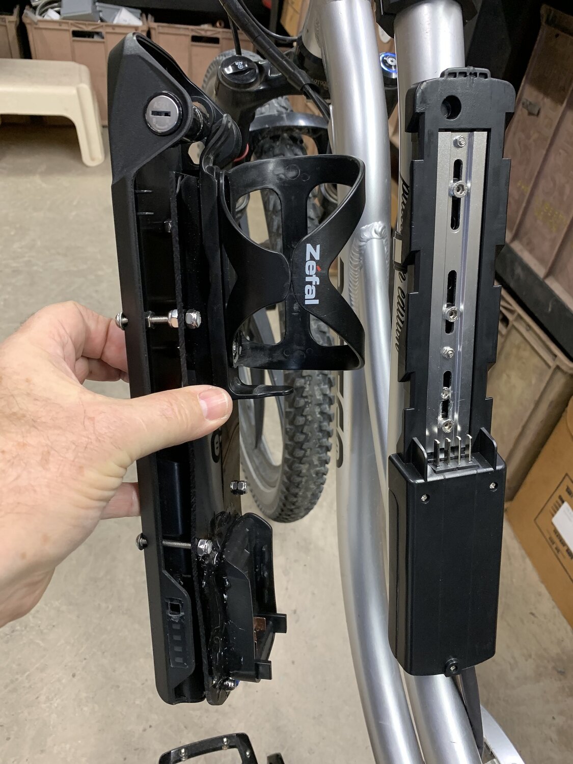

When I'm not using the downtube range extender battery, I made this water bottle cage adapter that fits on the battery mount:
