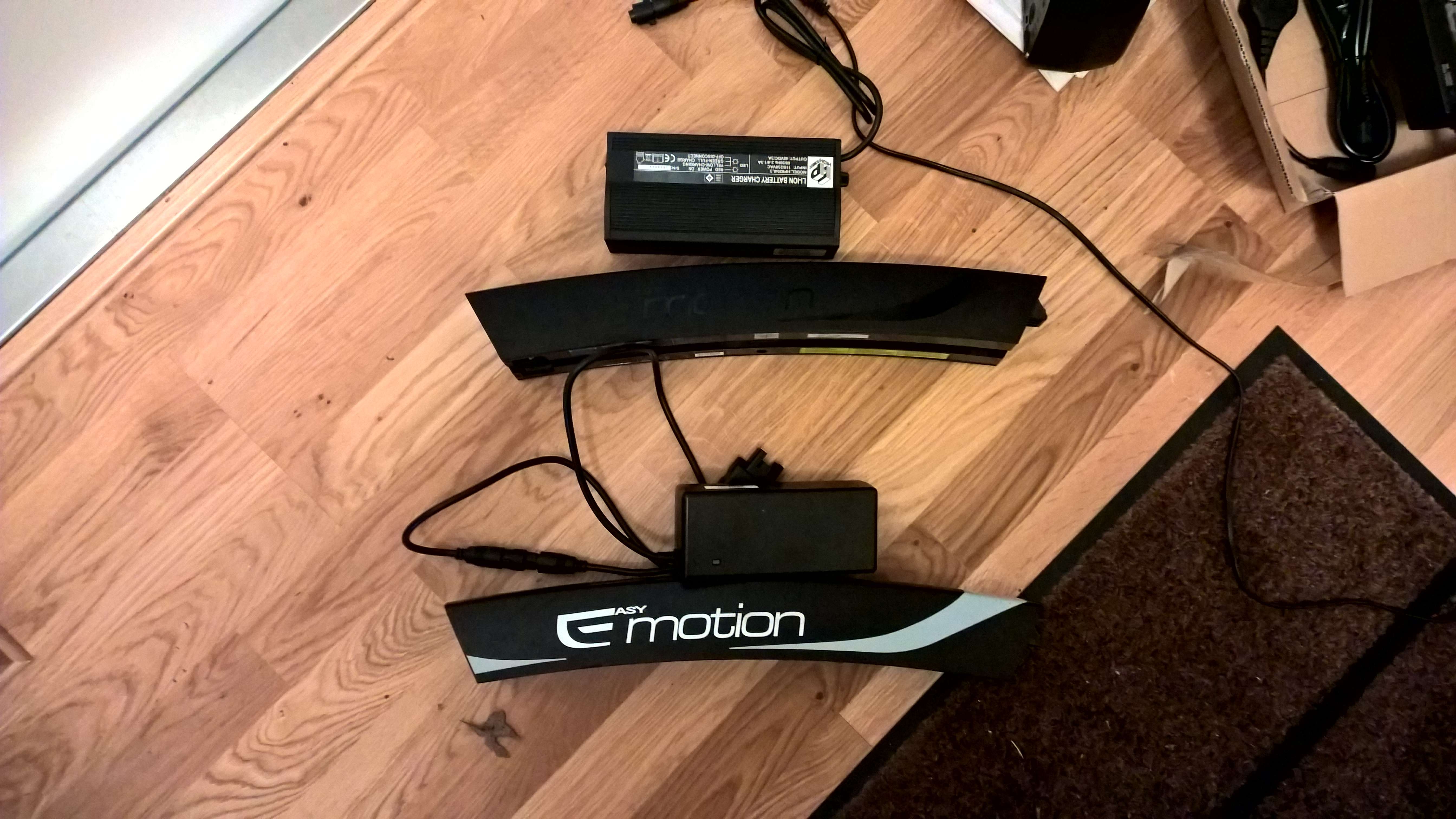

Ok, I will make a more extensive report later. I went to the post office and received my package. Had to pay a hefty toll/tax fee, oh well :-/
I replaced the battery then and there. An immediate difference was the sound from the motor. I could hear it worked harder or "gave more" or how to describe it.
And the speed, yes. Definitely an improvement. No placebo effect.I couldn't try to max it on the roads from the post office to my house, there are too many bumps and turns. No good flat asphalt.
Immediate con: The sound from the charger. Here is a clip where you can listen to an example:
Here is a picture:
Here is a picture:
54V chargers do have inbuilt fan and make noise.
Also, from Warranty perspective, I wouldn't suggest a 350W motor at higher voltages for long periods of time. 500W motor is suited for that.
