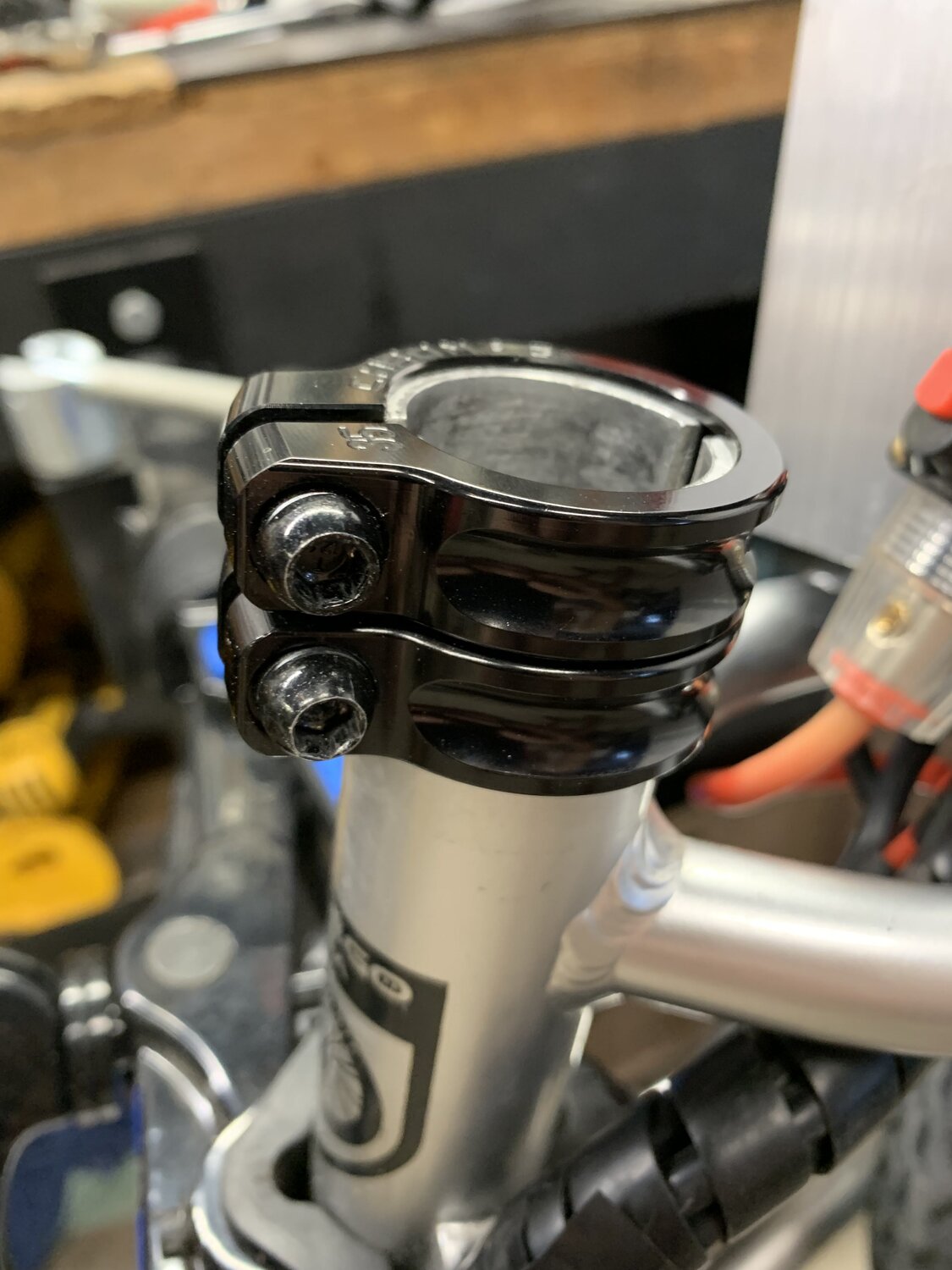

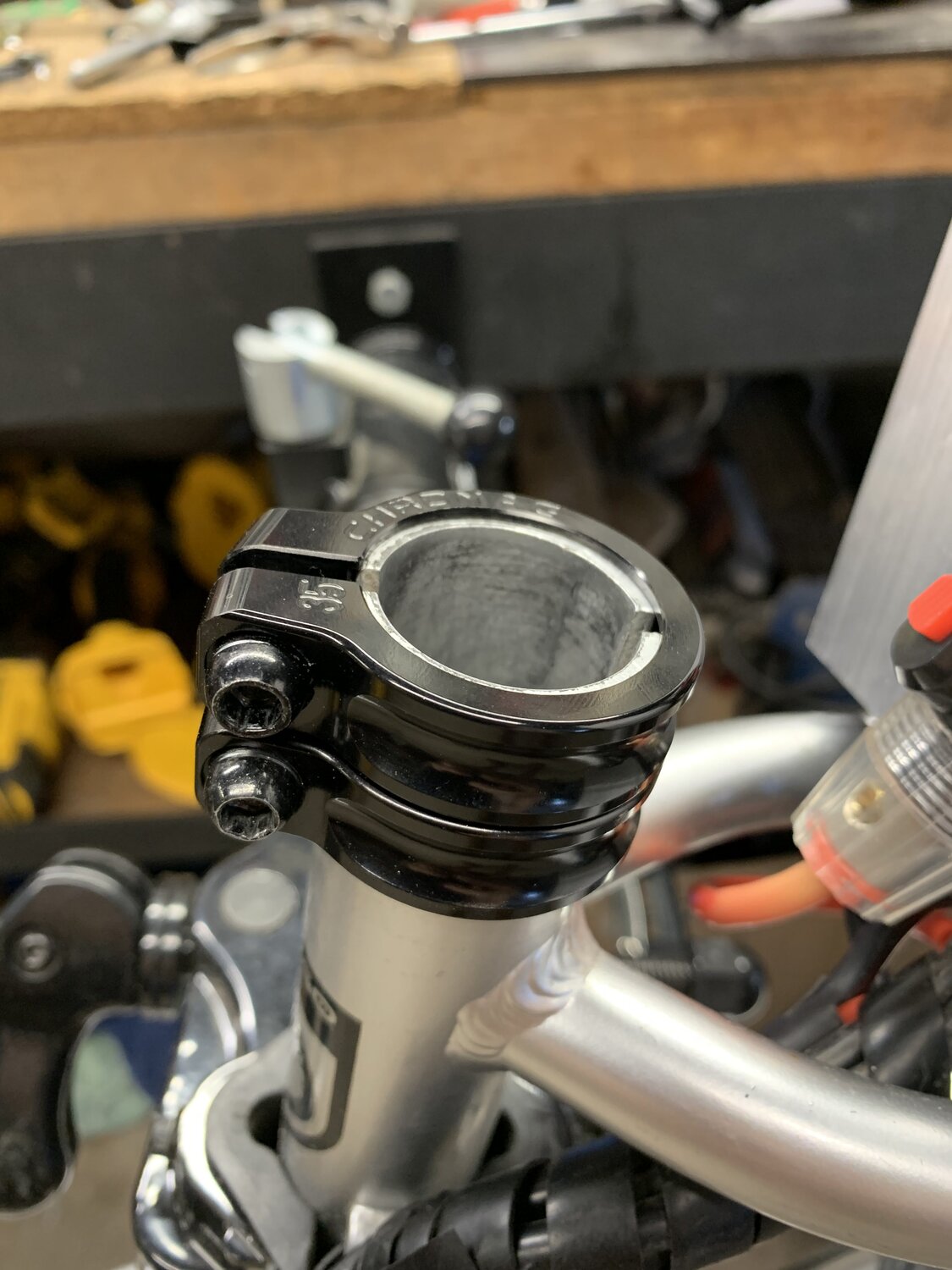

At 230#, I could never get my post to hold using 5 Nm of toque on the clamp. The grit paste helped a bit but I wound up buying high quality clamps and tightened them well beyond 5 Nm. Still not perfect but the best I could do until I saw this in another thread:
I added a second seat post clamp. I ground off the lip and slid it farther down the seat tube. The double clamp scheme allows me to tighten both to 5 Nm and it holds perfectly:
I haven't tried it with QR clamps but the principle is the same so it should work.
I can't find the thread where I saw the idea so I can't credit the original poster.
View attachment 143538 View attachment 143539
As a “general” rule, the slot in the collar, (clamp), is aligned with the slot in the frames seat tube. There are exceptions, but they generally, (not always), apply to carbon seatposts. If you have an alloy seatpost, the collar would be more effective with the slots aligned, (unless the manufacturer instructs you to have them as shown above).
You can't see it well in the pictures but the slot in the post IS aligned with the clamp. That seatpost has 2 slots. That alignment "rule" also applies to the slot in a shim (if used).

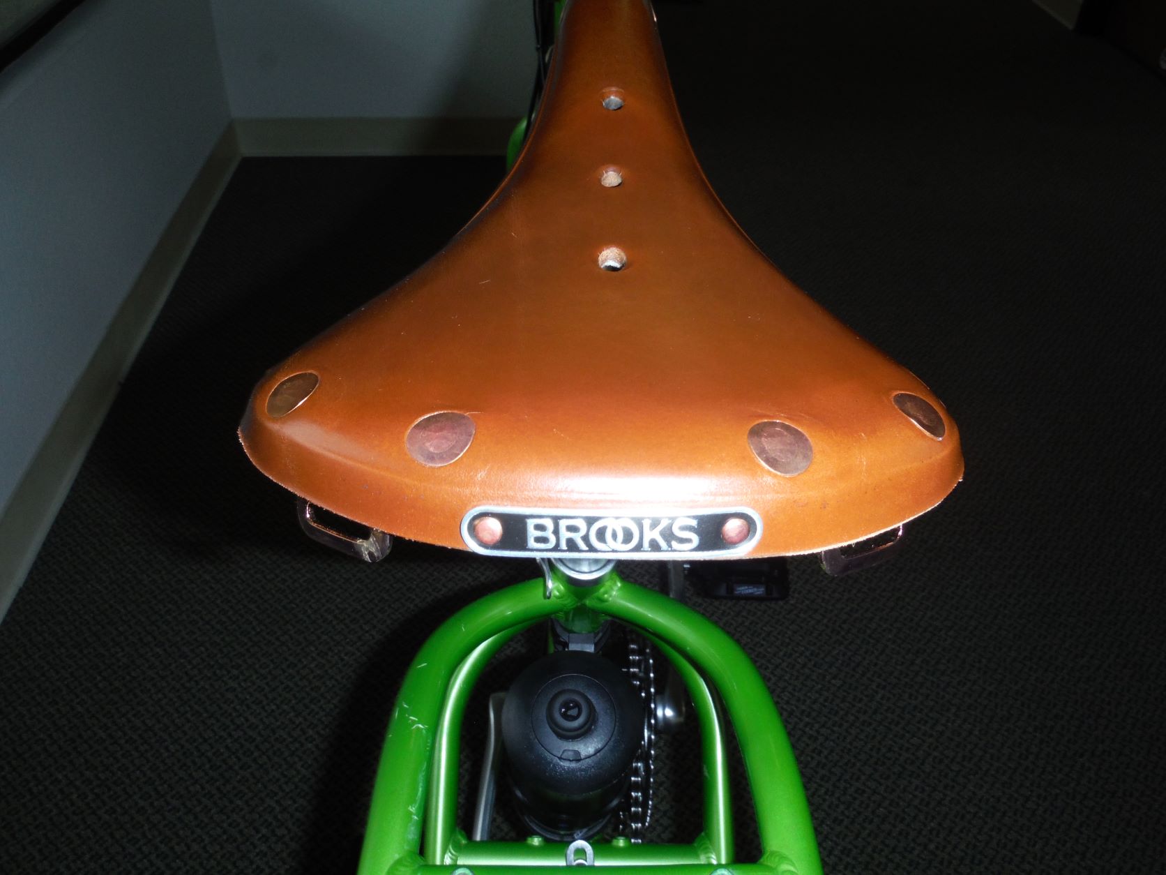

Back to the B-17 Brooks. Lanolin on the underside does wonders.
