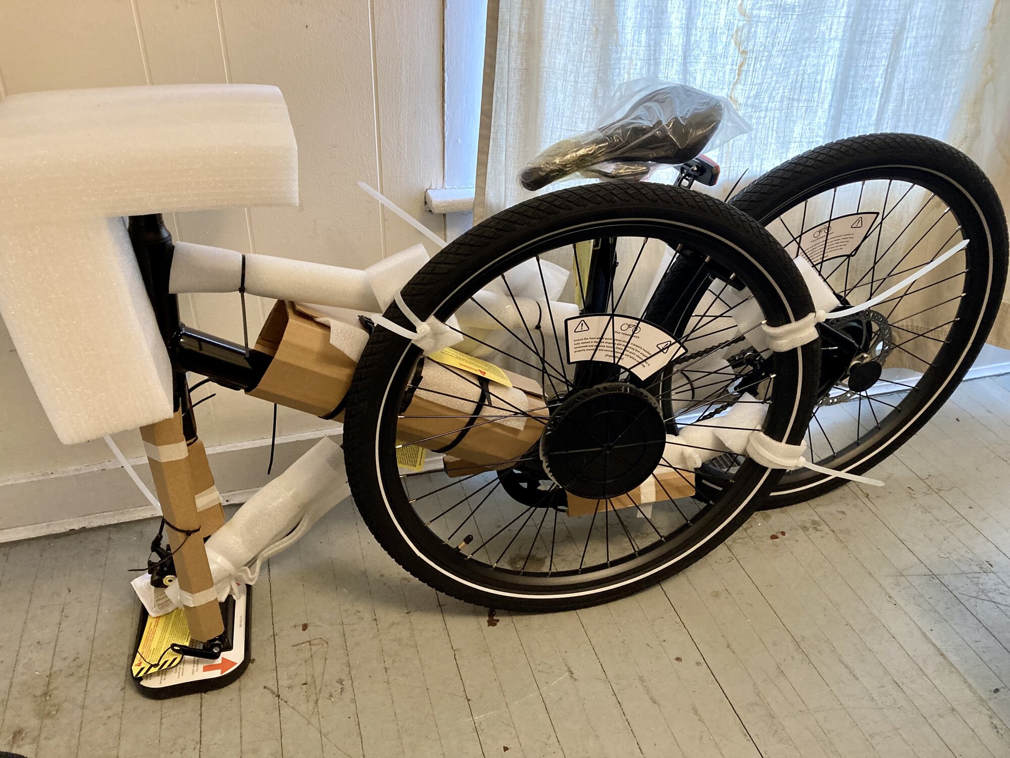

My RadMission just arrived. The Front Basket is MIA, FedEx tracking still says it's in Georgia. Hopefully, the rest of my accessories ship soon. I also ordered a pair of Hafny E13 mirrors via Amazon today.
Assembly was easy, the only defect was the inner chainguard is a little bent, but I can bend it back with my thumbs.

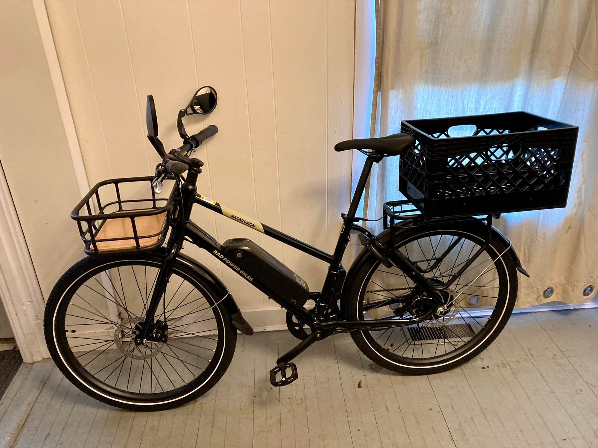

My rear rack and fenders came in today from RadPower, and my AXA Block XXL frame lock came from Amazon (from France), and I finally got to take her for her maiden voyage, a run to my office on the other end of town and back, about 5 Km each way. I took the long way around to avoid the 9% grade hill, but I can't avoid the 6.5% grade hill. At max assist, with a moderate load (bicycle bag, handbag, some odds and ends from my office, 4.5 lb Kryptonite New York Lock), the motor slowed down quite a bit, but pedaling up the 6.5% grade was easier than pedaling up my usual 3.5% grade on my old Trek with 28/18 gearing. The kickstand and the chain for the AXA frame lock should arrive tomorrow. I will use the AXA chain and frame lock to lock my wheels to the frame, but the Kryptonite New York Lock will be my primary lock.
One additional problem I ran into was that the rear axle was very difficult to remove from the dropout on the non-brake side. Very frustrating, but I eventually got it out and got all the bits installed.
I still have to sort out the headlamp mounting problem. The bracket for the headlamp that is designed to be used on the stem faceplate will not work properly if you move the mount to the front of the basket. The installation instructions show a different bracket in the illustrations, but no such additional bracket is included in the parts list. With the original bracket, the headlamp cannot be positioned properly if mounted to the underside of the front basket. I put in a support request Friday afternoon, but they have yet to respond.
With the big milk crate mounted transversely, the taillamp is somewhat obscured. I may drill holes in the crate and mount the taillamp there. I think the extension cable is long enough. Also, I need to affix the crate to the rear rack better, especially since it is cantilevered. I can't find my heavy-duty zip ties, but I think I'm going to use bolts and fender washers. A friend is sending me some panniers she no longer uses, and I'm hoping I can fit them with the crate mounted.
Last things last, I need to readjust the read brake caliper. I backed out the adjuster because it was rubbing, and now there too much lever travel for my liking.
I'm currently running 65 psi in the tires. I might soften that a bit, because the roads here are terrible.
I find that on the flats, PAS 1 is not quite enough, but PAS 2 is a little too much.
Also, I feel like I am much, much higher up on this bike than I am on the Trek, but I'm not sure that I really am.
