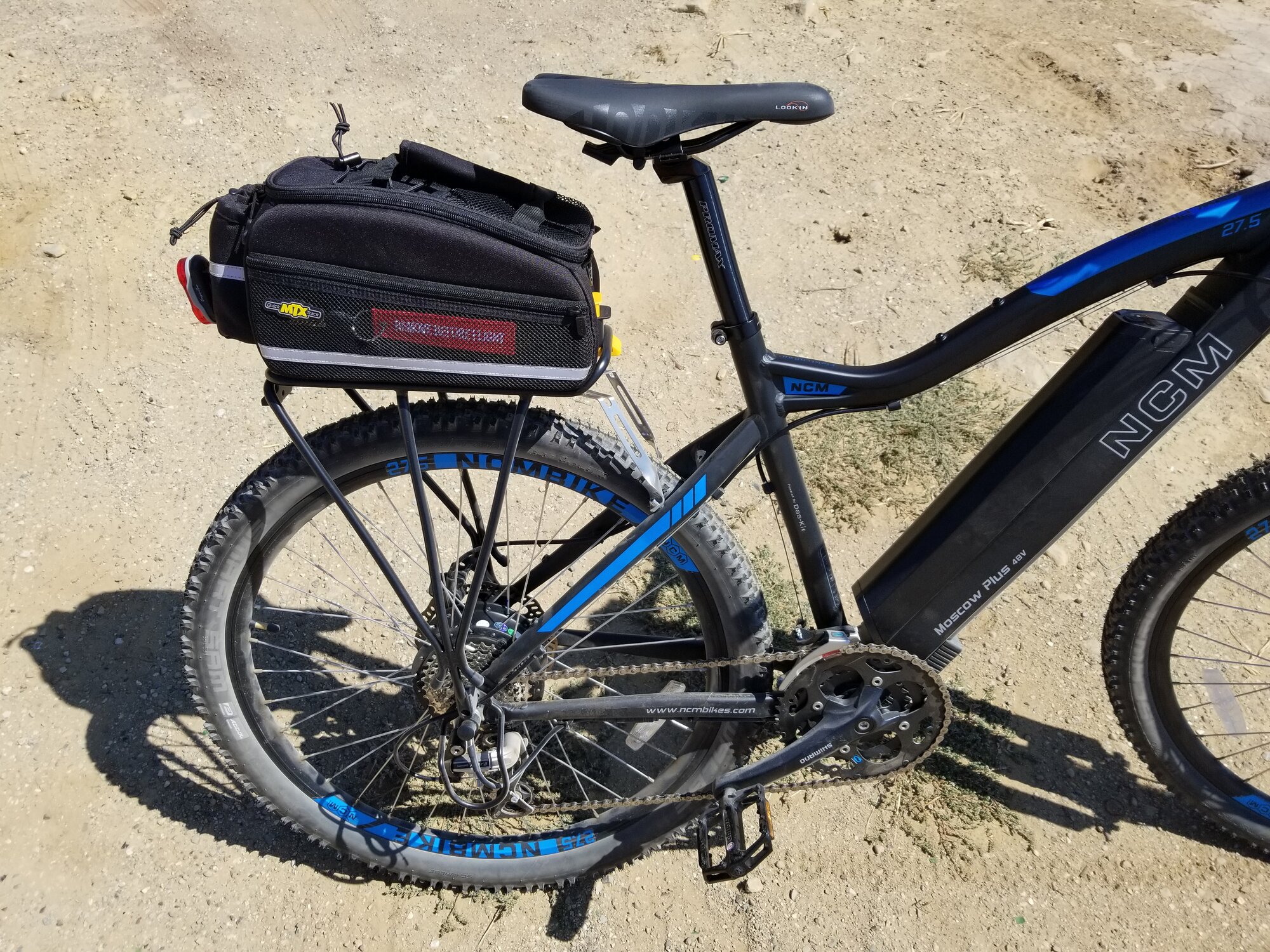

  • Since I’ve been drinking the Topeak KoolAid for some time now, I installed an Explorer MTX rack and quick connect EX bag. Works great.
  • This also leaves the seat stay mounts free for a future ABUS frame lock, if I’m still in the mood.

You have done part of my plan already in installing the topeak rack so thanks for verifying that it can be done. Did you have any issues installing it? Any tips for the installation would be appreciated.

The only tricky part was the metal bending for the rear seat stay to get it to look decent. I could have mounted the front rack supports to the center bar on the seat stay, but I wanted to leave that open to mount a Cafe/frame lock like you're looking to do. So far I haven't found a frame lock I'm happy with. The ABUS 4960 is readily available and has a "wide" 2.5" opening, but that only leaves about 1/16" on either side without some additional machining. It looks like the ABUS 4650X or 5750L might fit both the tire width and seat stay mounting hole locations, but they're hard to find in the US.
I bought the Topeak rack for disc brakes and it works fine, but I would consider the regular Topeak rack for non-disc bikes if I had it to do again. The rear caliper doesn't extend much past the frame and doesn't need all the clearance the disc brake rack provides. I think you could get away with a tighter fitting rack with possibly a small added spacer on the disc side. I also have an NCM Aspen and really like the fat tire experience. I bought a non-disc brake rack for it and used a small aluminum spacer on the disc side.
