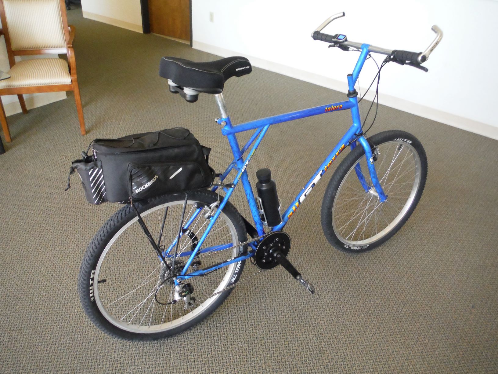

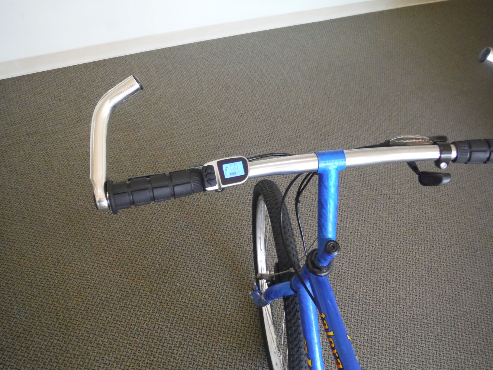

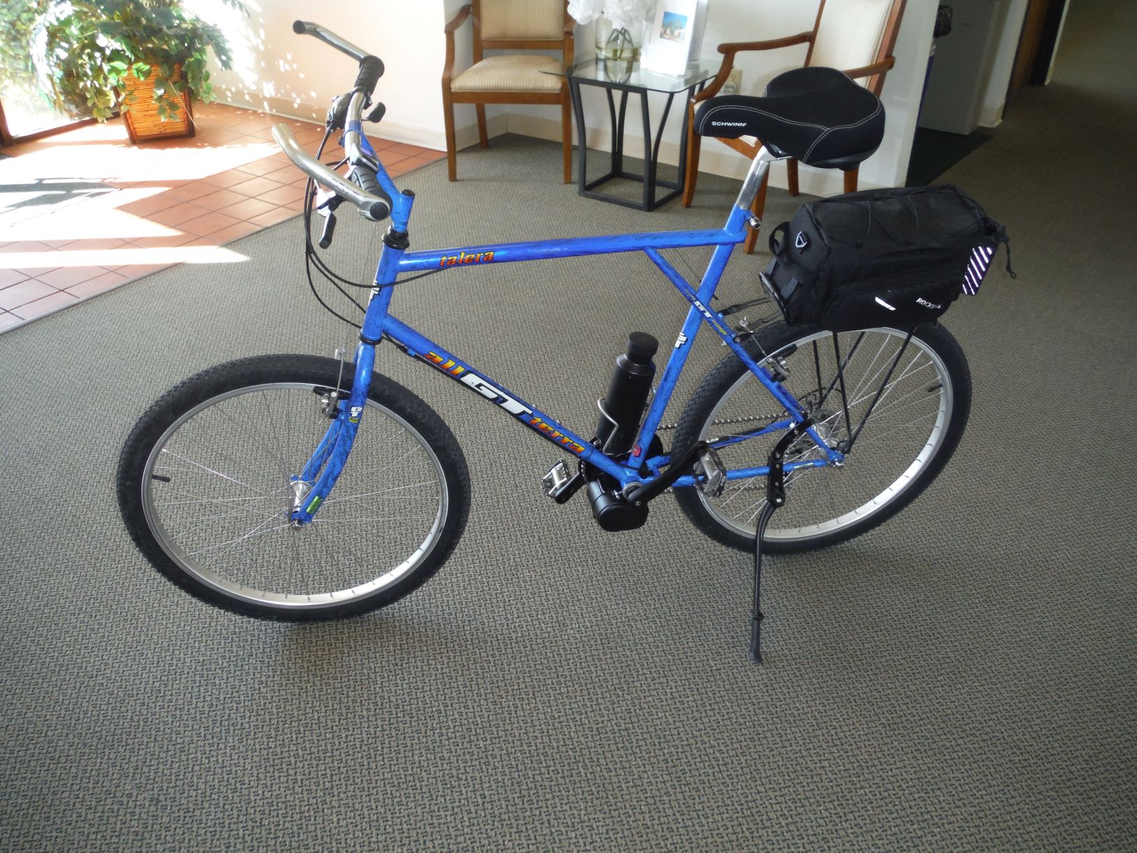

IMHO the Apex would be cool. Try to keep it un-cluttered at the HB. The bag is just a bag. The battery looks a lot like a bottle and you can see the wire from it to the motor. We have hills around here in the San Francisco area.

Pedaluma. Are most of your conversions done with middrive motors and is there pedal assist and/or a throttle?

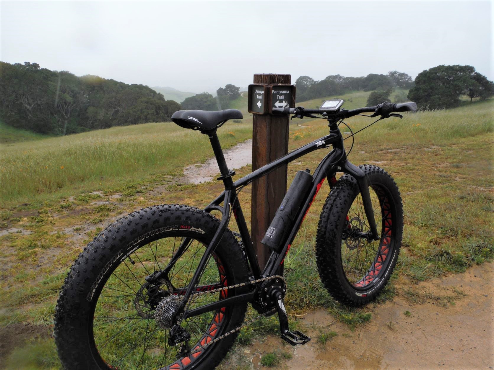

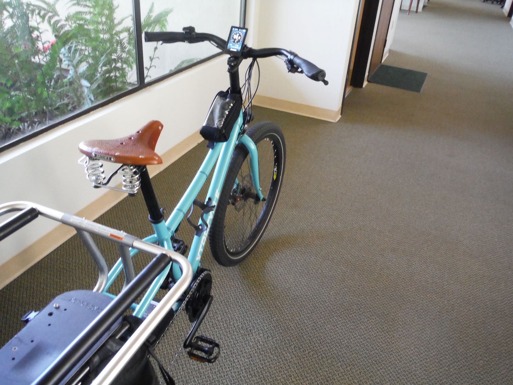

Thanks for asking @Taylor57. All of them are mid-drives. Most have torque sensors. Most do not have throttles, because it is in your foot with a torque sensor - like a car it measures pedal pressure - instead of thumb pressure. Some have throttles. Here is one with a throttle and a torque sensor. And then one with a coaster brake and torque sensor without a throttle. And a third without a torque sensor and with a throttle.
