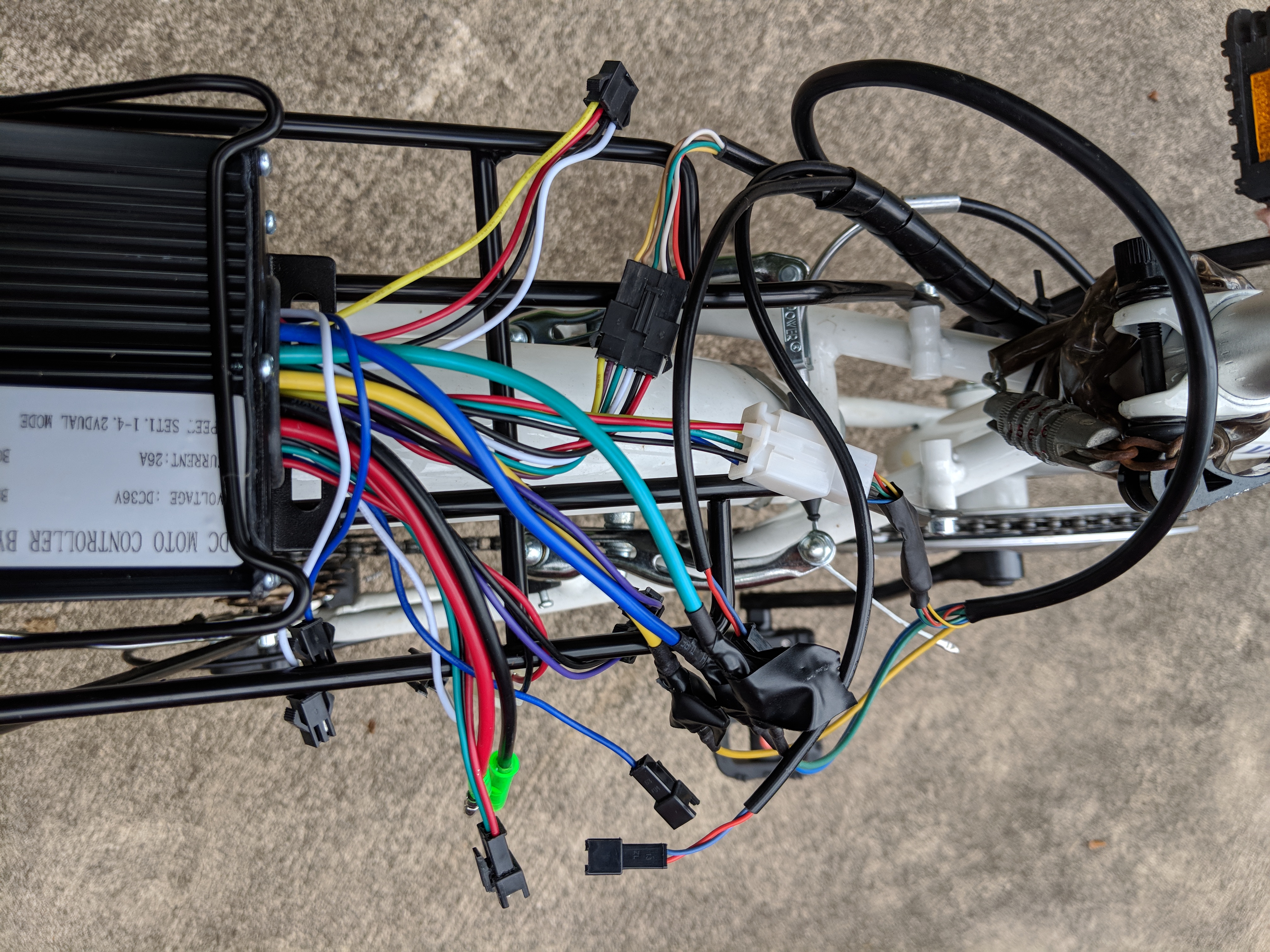

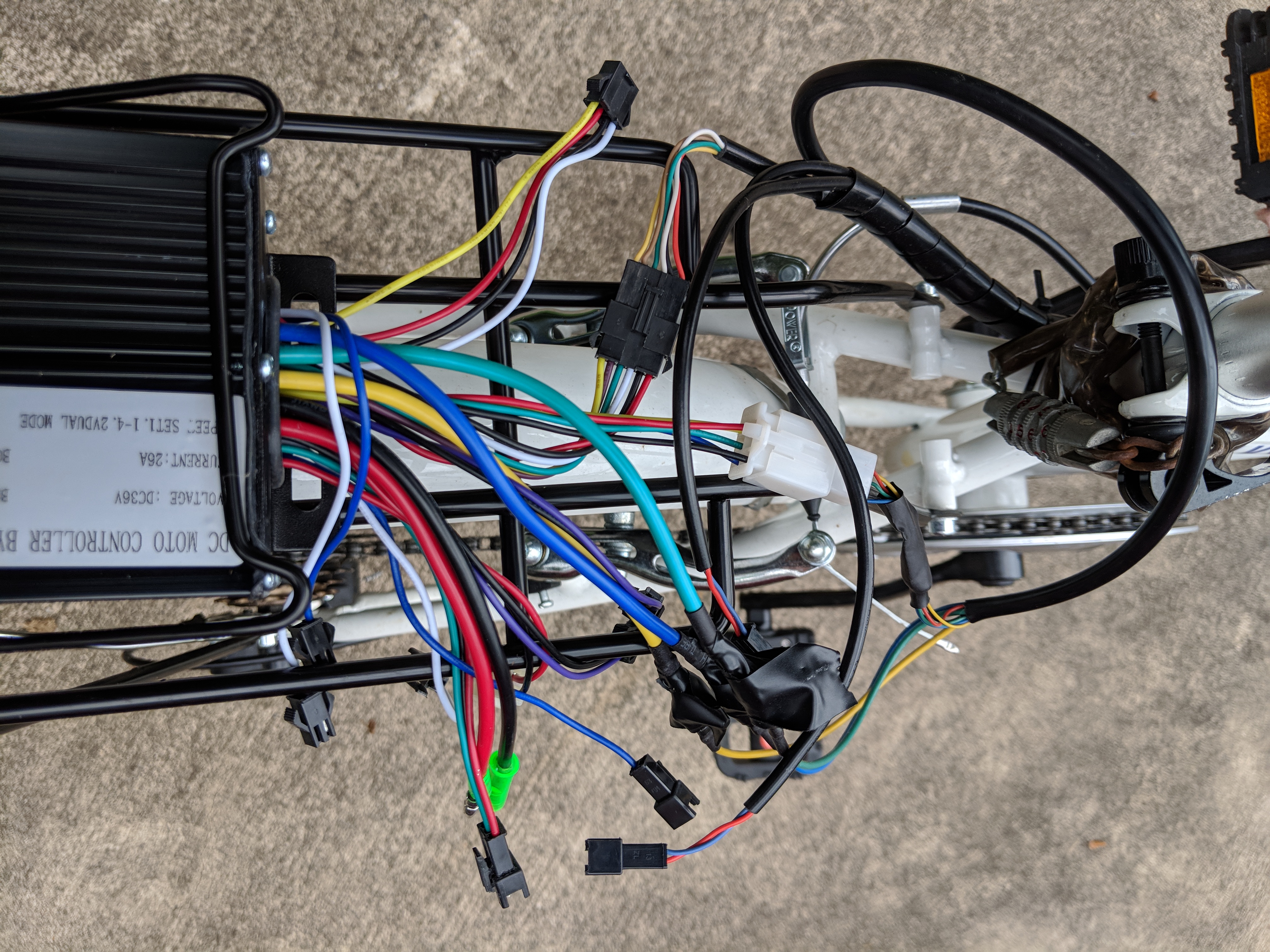

Ignore the snapOK....two pics and questions. I decided I would dump the bag. While I do have quite a bit of electric things, I'm obviously not an electrical engineer. LOL I do understand the relationship to heat and this stuff.
Anyway, I took my 40 volt battery and put two spade connectors in it. Took a jumper to the red black. (yes I do know black is ground, etc.). I just want to make sure........I don't want to mess up my battery. When I went to hook the positive, I got a nice big snap. I suppose I've only messed with 12 volt before. You get a snap but I know what I'm doing is right. I guess 36 volt is going to be more pronounced?
Battery still working in mower. Just ignore the snap or do I have something wrong? (In the picture I do not have the red/blue from the harness connected. I'm guessing that is the brake disconnects).

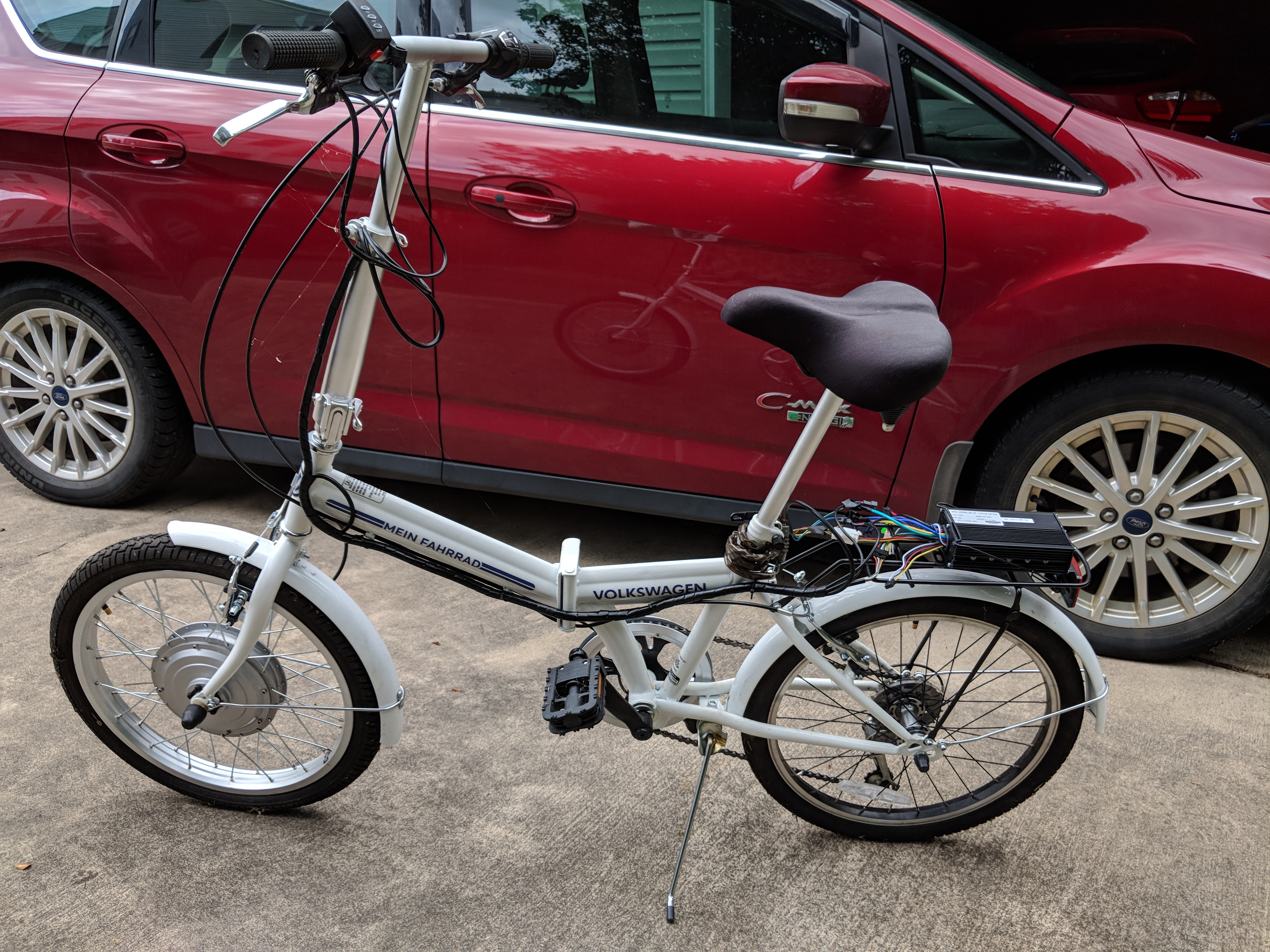

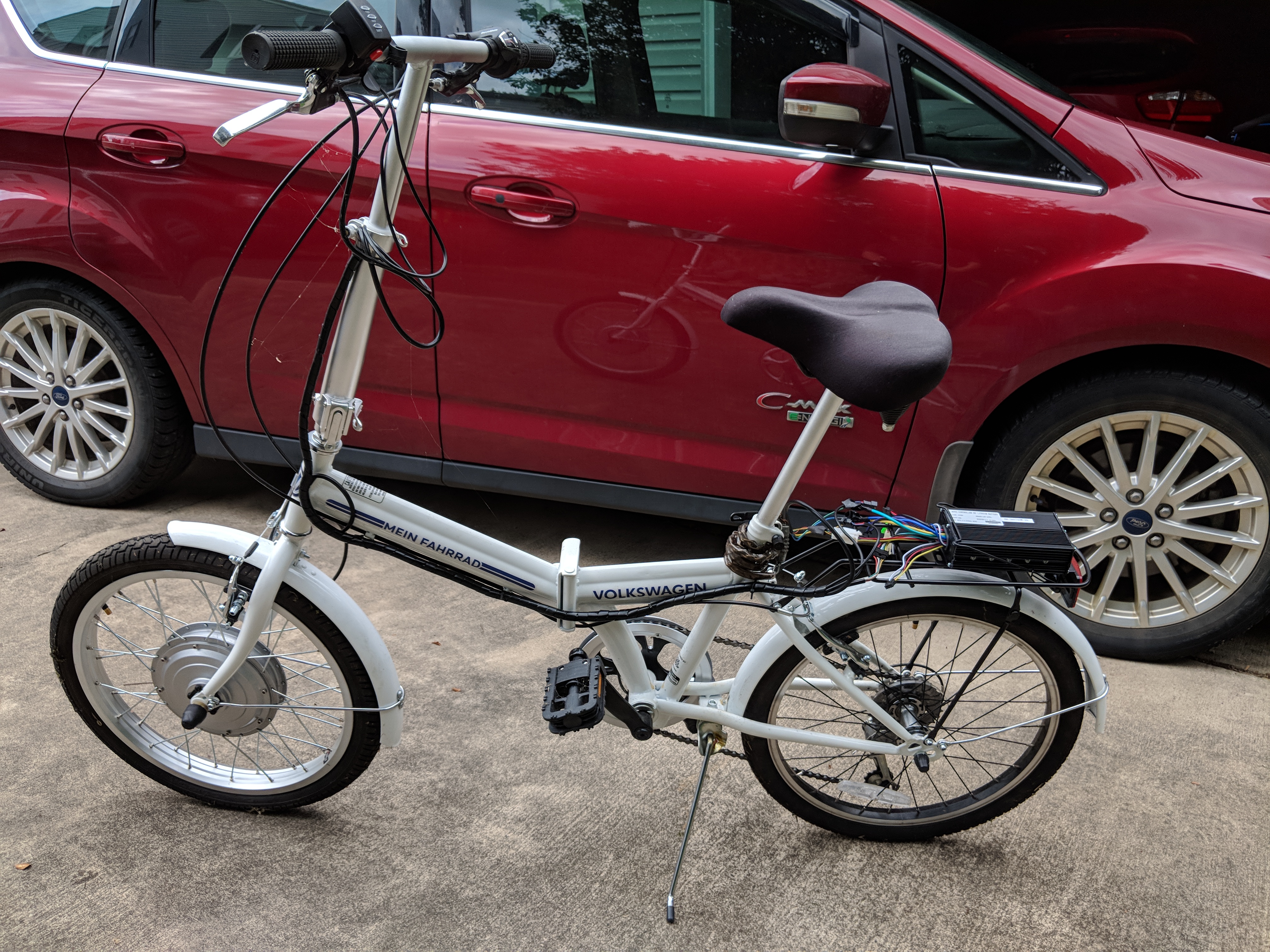

Good for you! It's official now... welcome to the club.She worked!!! I didn't have the battery fully charged so it was just a short burst but it worked. Now to set it up better and get a battery.
LOL. You will get the bug and soon have a bigger bike.On the fully charged lawn mower battery. Around the block and...........I have to think it's pretty underpowered at the moment so I wasn't too concerned with the forks but even at that, this is all I'm really looking for.
