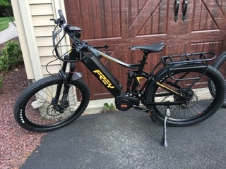

Yes! Iām impressed so far. The packaging was extensive and I was pleased with the efforts that Frey went took to ensure safe transit. The bike assembled easily enough. There were two minor cosmetic scratches that I touched up but I was frankly expecting a lot worse given how long it took to get to me.Congrats! Looks great!
How does it ride? Was it everything you imagined?![]()
Iām glad your bike arrived in good shape and your enjoying the ride. I think you said the color is matte black, right?Yes! Iām impressed so far. The packaging was extensive and I was pleased with the efforts that Frey went took to ensure safe transit. The bike assembled easily enough. There were two minor cosmetic scratches that I touched up but I was frankly expecting a lot worse given how long it took to get to me.
in terms of ride it feels great, I find myself using eco 3 on side roads and for casual riding and sport 5 for main roads when I want to keep up with traffic. Thereās definitely more torque than my previous Juiced CCX but the max speed is similar at 33ish.
The only issue Iāve had is that the Magura brake pads have some friction spots on the caliper. Iām told thereās a bit of a breaking in period.u
happy to answer any questions folks have!
I didnāt specifically request no decals but Iām happy with how it looks and I like the minimalism. To your point about the battery Iām having the same issue. Frey tried to talk me out of the 52 volt battery because, āthe indicator cannot workā. So, on the battery itself thereās an LED indicator that will light up to show you how much charge is left. That does not light up on my battery. On the Bafang display, at full charge it indicates 100% even after a considerable amount of riding, then drops to 96% then 68%. I definitely think both indicators are messed up due to 52 volts but I donāt care that much and prefer the extra power. As long as I have some indication when Iām running low on battery.Iām glad your bike arrived in good shape and your enjoying the ride. I think you said the color is matte black, right?
I noticed you donāt have the Frey decals. Are you trying to stay in stealth mode? I think your bike will draw attention In any case especially when youāre zipping along at 30+ mph.

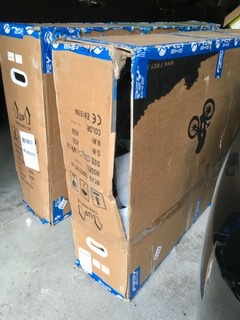

Customs really did a number on the box the AM came in. It was sliced with a knife wide open with the bike exposed and not secured properly.View attachment 54532
Fortunately the bike was well packed and the only blemish was a small scrape on the Rockshox decal. I was missing both clamp screws that hold the Bafang display. I notified Ivy and she immediately shipped me the missing screws.

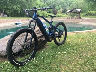

Iām really happy with the blue color of the EX that I chose from the YS paint catalog . Frey is probably the only company that allows you to choose your bike color from hundreds of options. If anyone is interested, my EX color is YS7634-1.

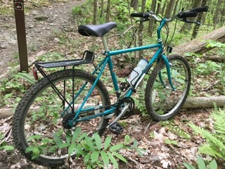

I practiced jumps with my EX using the ramps my daughter used with her bmx when she was a kid. This was a first for me. My only other mountain bike before now is a 1987 Specialized HardRock which will now be donated to the Smithsonian. I was a little guarded at first with my jumping but after a few safe landings my confidence increased. This is a very capable bike that maneuvers incredibly well. The power is amazing and and I was pleasantly surprised how quiet the motor is. I mentioned in a previous post that I built a 1 1/2 mile bike trail on the seldom used land trust attached to my property. The hills are steep and very difficult to climb with my HardRock. I was able to handle the hills easily with my EX in Eco 2. I may not need sport mode except in rare circumstances. The battery on the AM Shows 100% charge for a long time even with a lot of throttle use. The standard battery is 48 volt but I upgraded to the 52 volt. I wonder if the battery shows 100% until the charge runs below 48 volts.

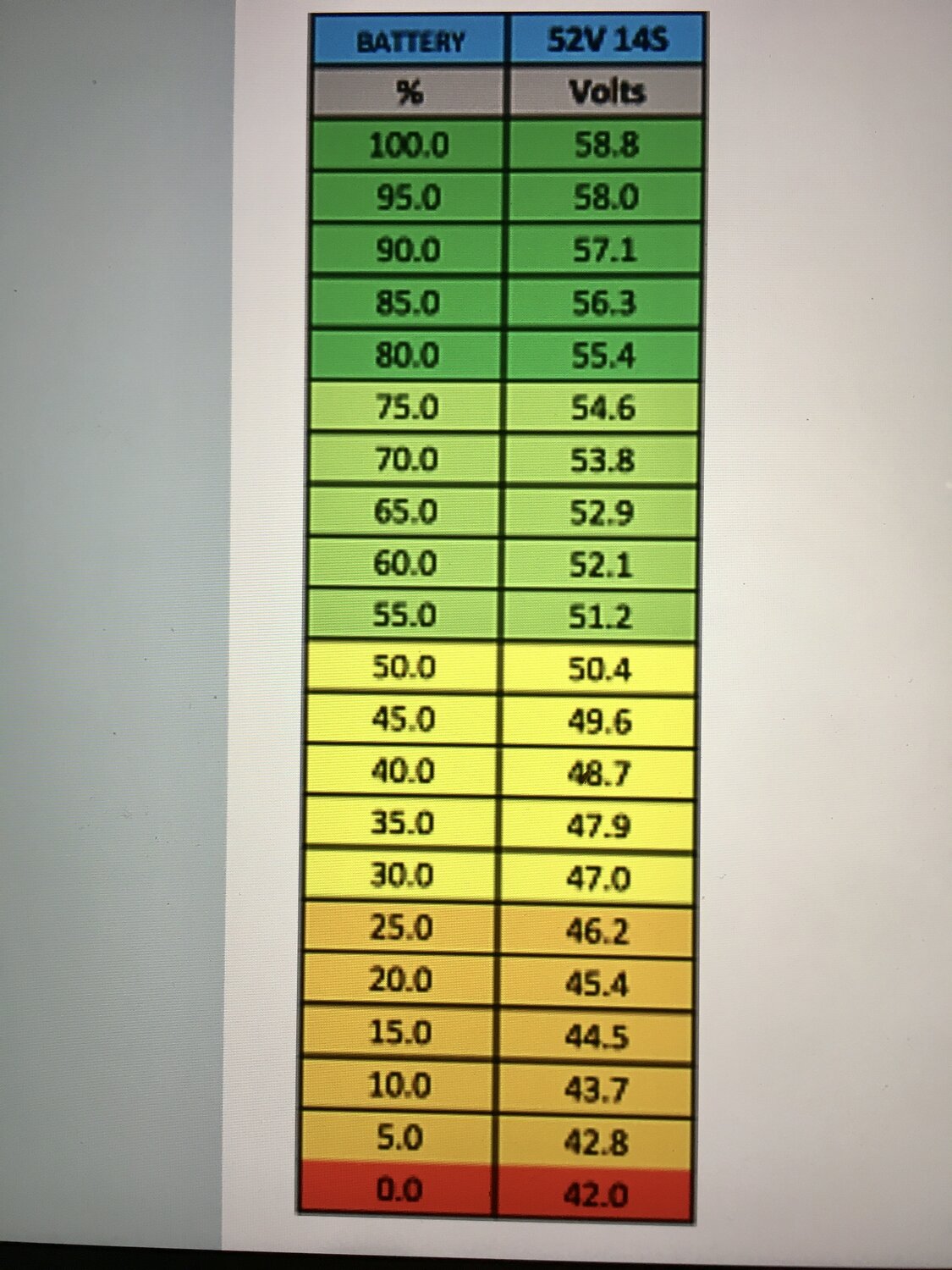

I know Frey was pushing the 48v battery for the AM but I saw Micahās video showing the advantages of 52v vs. 48v and Simon has had no problems with his 52v so I went for it. For my first rides I had the SOC set for percent and the display showed 100% charge for quite a few miles.I didnāt specifically request no decals but Iām happy with how it looks and I like the minimalism. To your point about the battery Iām having the same issue. Frey tried to talk me out of the 52 volt battery because, āthe indicator cannot workā. So, on the battery itself thereās an LED indicator that will light up to show you how much charge is left. That does not light up on my battery. On the Bafang display, at full charge it indicates 100% even after a considerable amount of riding, then drops to 96% then 68%. I definitely think both indicators are messed up due to 52 volts but I donāt care that much and prefer the extra power. As long as I have some indication when Iām running low on battery.
This is a helpful chart! So youāre saying if I use voltage instead of percentage it gives an accurate reading the whole time instead of percentage which seems to jump around?I know Frey was pushing the 48v battery for the AM but I saw Micahās video showing the advantages of 52v vs. 48v and Simon has had no problems with his 52v so I went for it. For my first rides I had the SOC set for percent and the display showed 100% charge for quite a few miles.
I went for a long ride today and set the SOC to voltage and the initial reading was 58.9. I rode in Eco 2 for most of the ride except on steep hills where I boosted to Eco 3-4. I traveled 31.5 miles and nearly 2000 feet elevation before the voltage dropped to 52.0. I had just started heading home when my wife texted that there was a problem with one of the Koi in my pond that she thought was dying. I rode Eco 5 as fast as I could averaging about 25 mph and watched my battery drain at a higher rate. I wanted to make it home without swapping batteries but came up 3 miles short. The battery died at 42.0 volts and 54.1 miles. I went the rest of the way home on throttle assist and hit 36 mph while spinning as fast as I could.

I will definitely use voltage from now on to determine the battery charge. Here is a chart someone posted that you might find helpful.View attachment 54644

It does jump a bit depending on how hard the motor is working. When the battery was almost depleted it would move from say 42.8 to 44.2 briefly if I was going downhill but would go back to 42.8 when the motor reengaged. The display did not go below 42.0 before the battery died.This is a helpful chart! So youāre saying if I use voltage instead of percentage it gives an accurate reading the whole time instead of percentage which seems to jump around?
