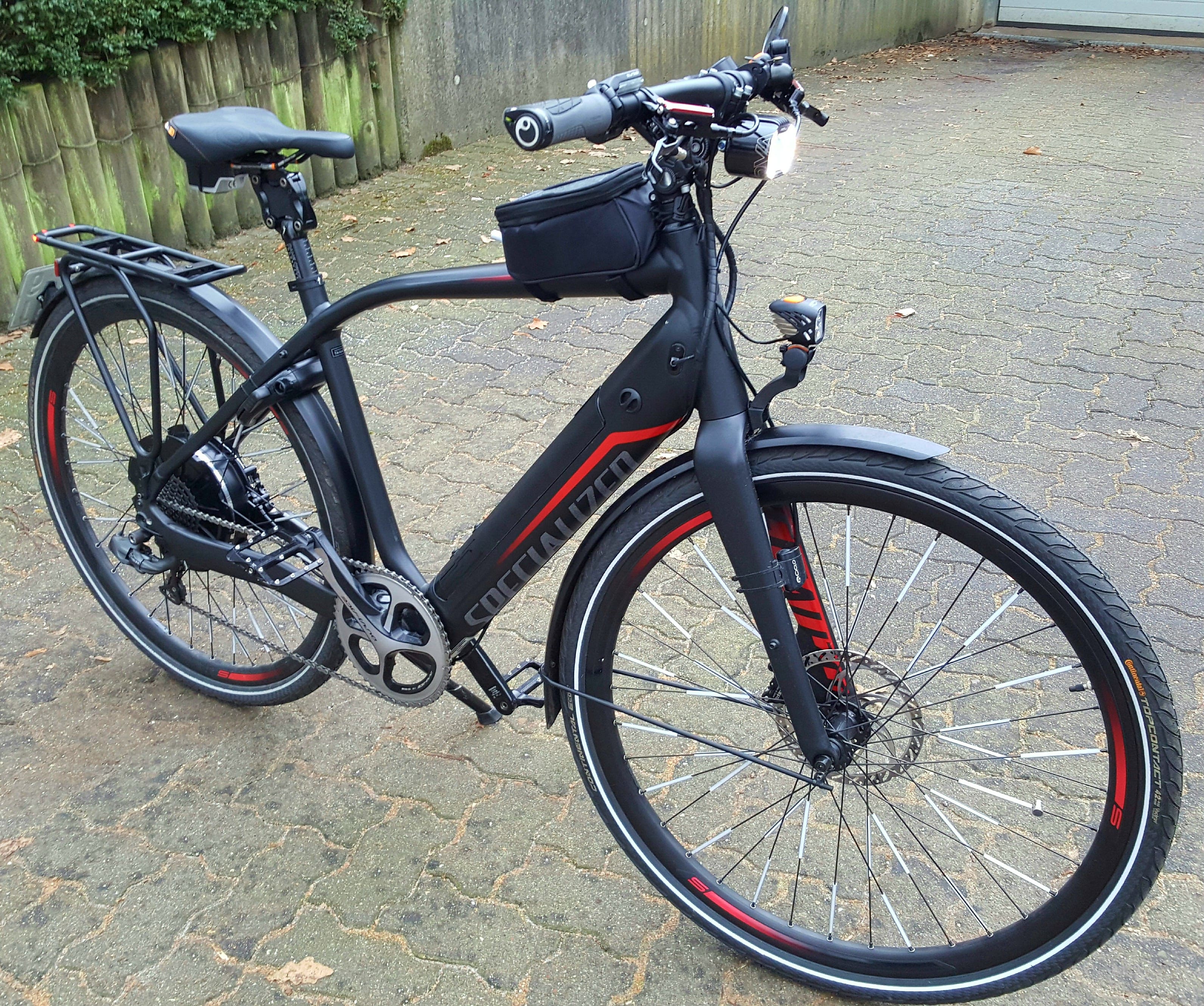

I have loaded a week ago on my two batteries 691wh.
This update is for the reset the ODO (only 691wh and 504wh)
