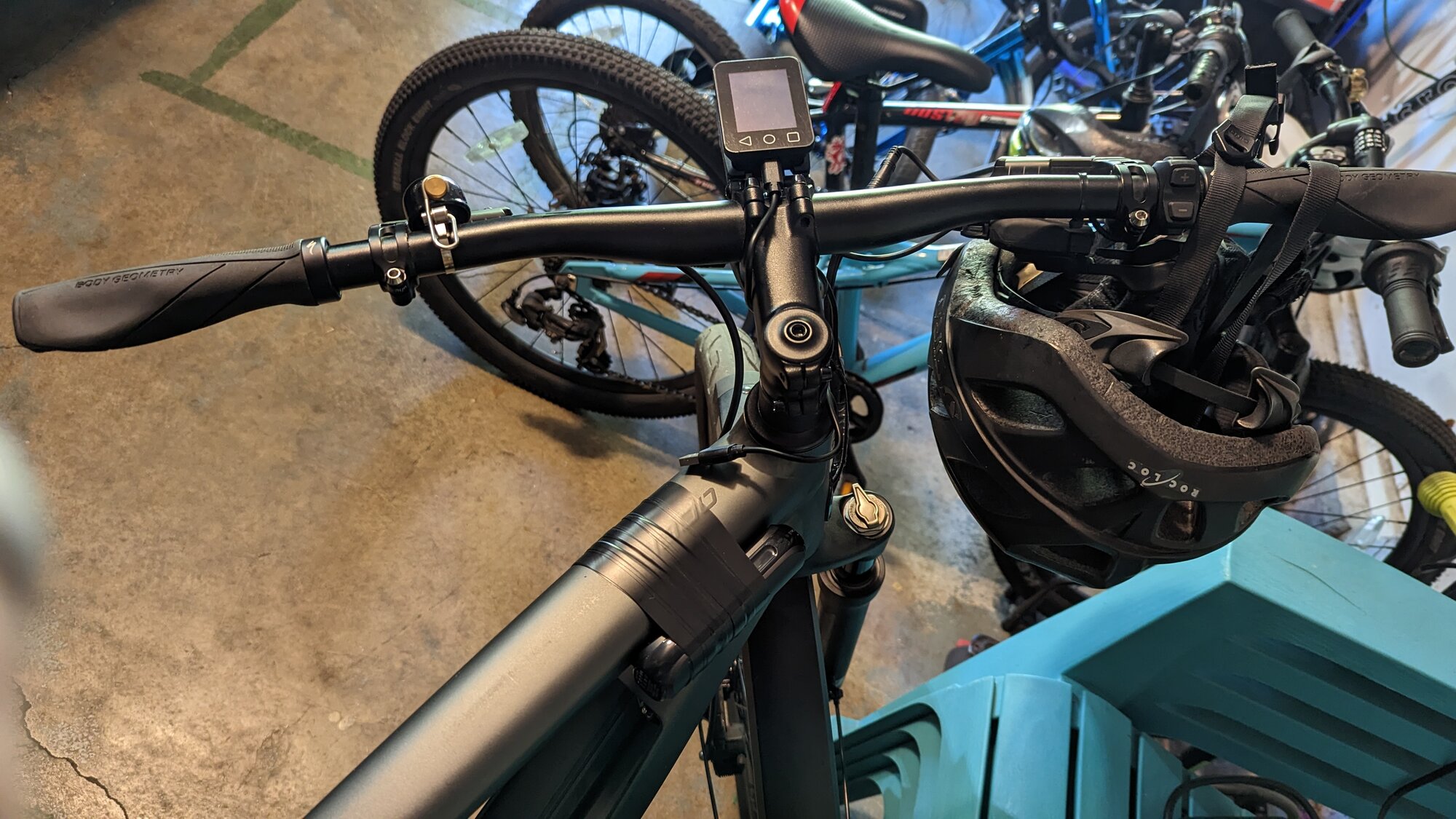

Well, here's where my personal experience ended up. Full disclosure: I'm the 2nd owner as I purchased it from the first owner. The first owner worked on the marketing team for this bike and that team was partially compensated in, you guessed it - BIKES! They all got one. Well, the bike wasn't a great fit for this guy and he put it up for sale. I bought it with just a few hundred miles thinking it would last for years! I did not do the research I should have to determine these first models had lots of problems with little in the way of support or solutions. The good news is that once I got it home from the bike shop, I fixed it and have been riding it every day since! How did I fix it? I duct taped a USB power bank to the frame to power the BLOKS display unit 😝. It sure does make a $5,000 "Engineered in Switzerland" bike look like trash, but it works great! It's a bad look for Specialized, but I get it - they don't owe me anything: I'm not the original owner and the bike is a 2018 [it's now 2023]. The frustrating part is of all the Hard Rock and Stump Jumpers I've bought since 1990 - this is the only Specialized I bought used. Of course I never had to look into a warranty claim until this one. I'm just glad it's working as I was *this close* to buying a new Tero X 6.0.

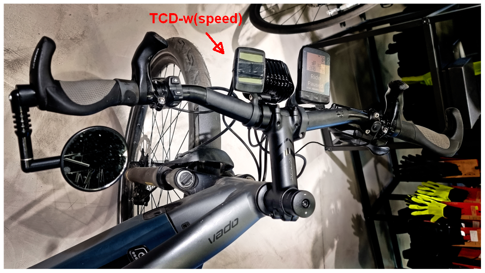

I wanted to increase the Reach on my Vado 6.0, so eventually I took a brave decision to replace the stem with a far longer one. However, the original Specialized stem had an integrated mount for the TCD-w(speed). I had to relocate the TCD-w to a Garmin mount. As the base of the display was already broken, I just fastened the display with a strong tape :D Now, the display only serves as the dongle for the Vado 6.0, and I use a Wahoo as the universal e-bike display (the TCD-w system allows that).
