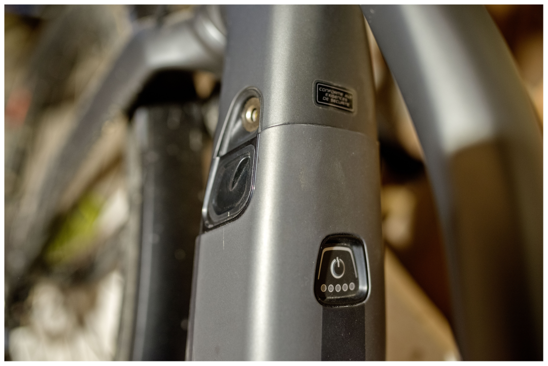

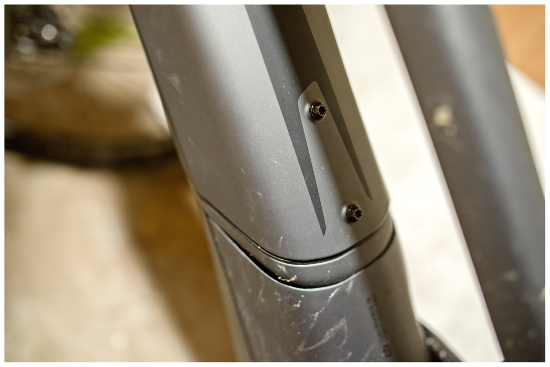

Regarding the battery, many Vado users experience problems with re-inserting the battery. Let me give you a tip how to do it:
Support your Vado against the wall or whatever so it is standing upright. When re-inserting the battery, make delicate movements with the bottom part in the battery nest. Try to align the battery in parallel with the bike frame. The battery must not be skewed:
It that was done properly, the top part of the battery leaves a very small gap, so small that it is even hard to see it in this picture. Trust me, the gap is there but I could not take a more convincing photo:
When the battery is well aligned, you just give the top part a slap. The battery clicks in place. Check with your hand if it is really secured.
I had problems with re-inserting the battery until I found the right trick to do it easily.
