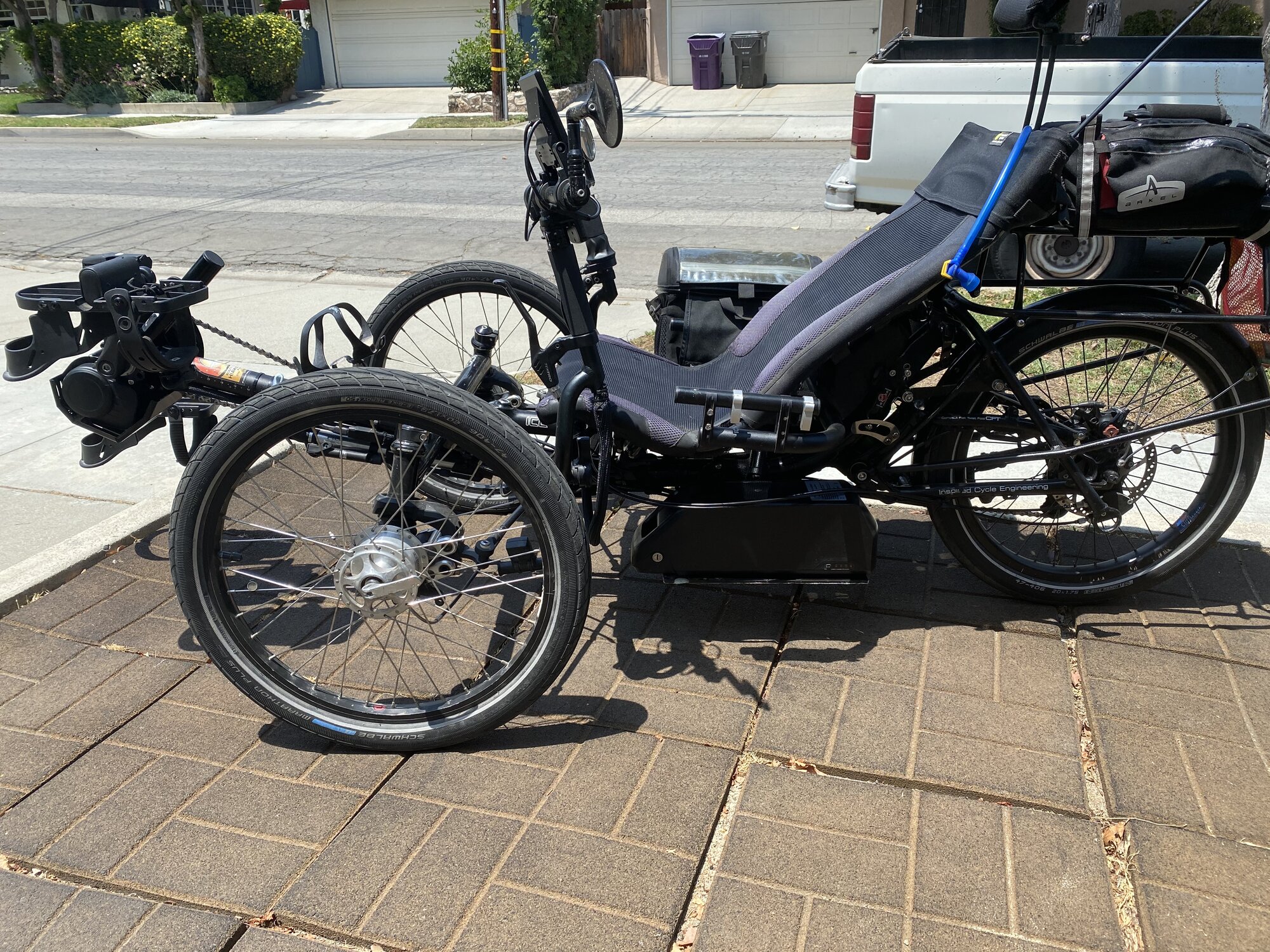

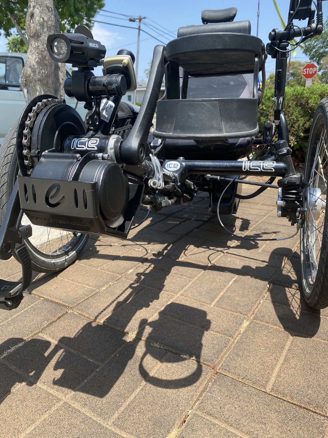

Recently installed a Tongsheng TSDZ2 e-assist system on my ICE Adventure FS recumbent trike. The trike is equipped with a Rohloff Speedhub. The TSDZ2 is a 500W. Battery is a 960W (48V, 20A) battery. I purchased the Open Source Firmware (OSF) so I could refine the functioning of the motor, particularly to allow my usual average cadence exceeding 90 rpm (the limit with the stock firmware). I also want make the functioning of the motor such that battery charge lasts as long as possible. I will post questions that relate to optimizing performance.

Would you please post a photo of your build?

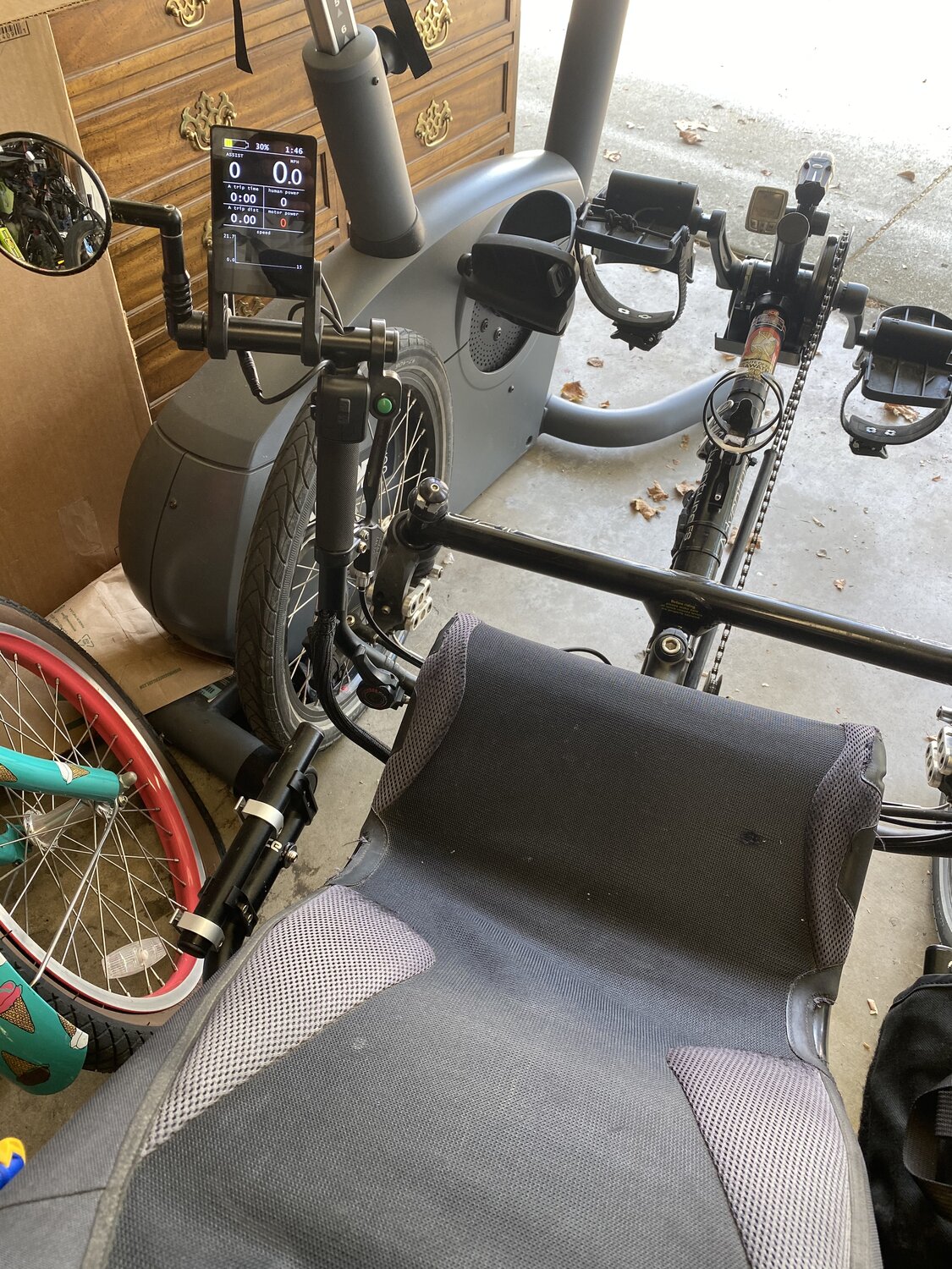

BTW, why is the motor power displayed in red figures?

Nice bike and a nice build. I am glad that you are clipping in to get the pull.
I am not sure about the red. Is that an 850c display? It is not showing an error indicator. Does red change to green when you are going, but then red again when stopped. I have not seen that before.
