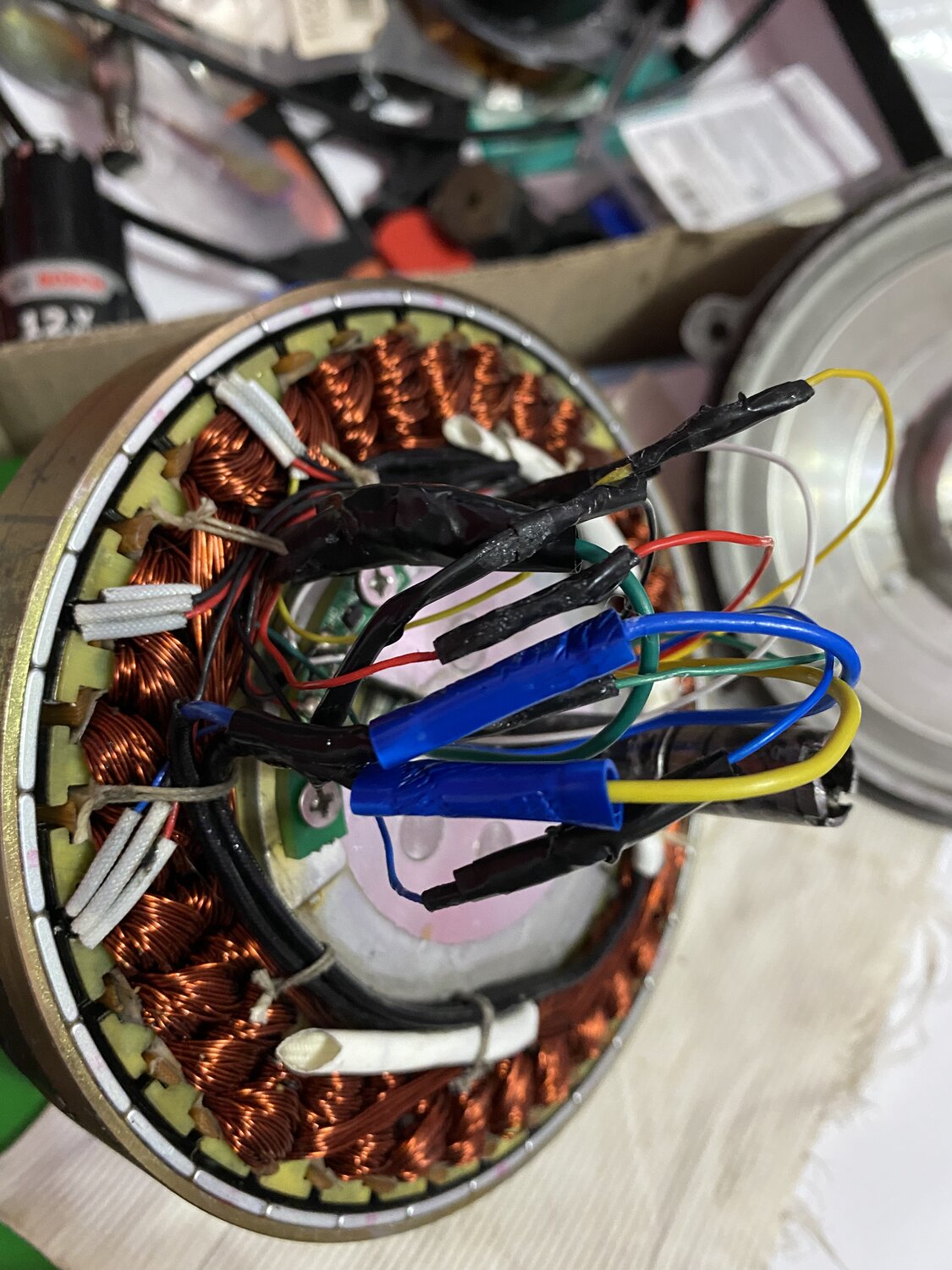

Regards to Nitro : I was amazed at how ezee it is to peadal it w/o PAS , only did a few x during my almost 15,000 miles and everytime it was like wow this is a completely new bike and it is so easy to pedal it and by the way I had the motor cable broken and I fixed it , it was amazing because I wasn't sure if it could be done.

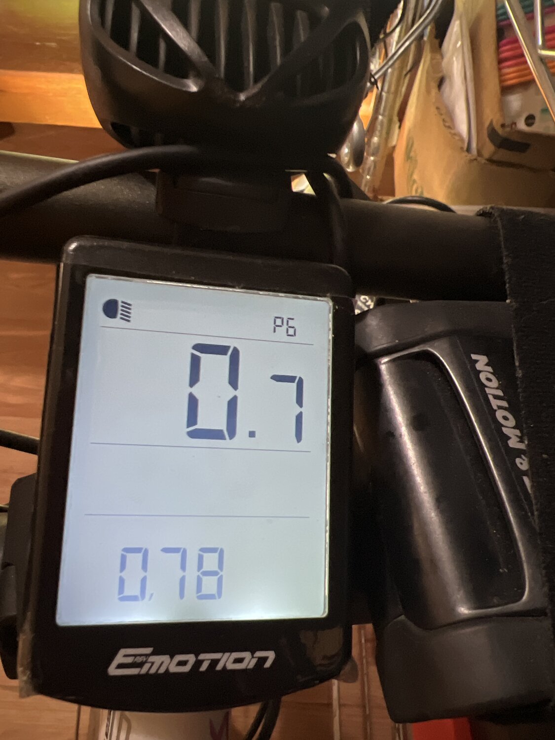

And while fixing the motor I learned something new about the torque sensor and this might completely fix your Nitro( i still want to buy it from u though😉) so basically the tighter or less tight you have the thruaxle screwed in , the less/more responsive the torque sensor becomes ( anything below 0.8V makes the TQ sensor responding a bit slow or maybe very slow depending on each person sensitivity...)
You can find the current value for the TMM4 TQ sensor in the settings when you keep pressing the two buttons at same time (top button and bottom) and you should have the TQ @ or above 0.8 if it is above 1v , the ride or response will become quite jerky or very fast ( the way u were describing it) so that means that the thruaxle it's not tight enough.
Mine's set @0.78 right now and b/c i use a single ring upfront -48T - the response from PAS is not as slow as it should be but this way i know that the wheel is also very tight in the drop outs and won't spin out like it did for me recently, see below.

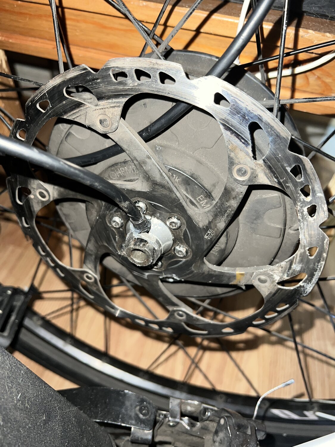

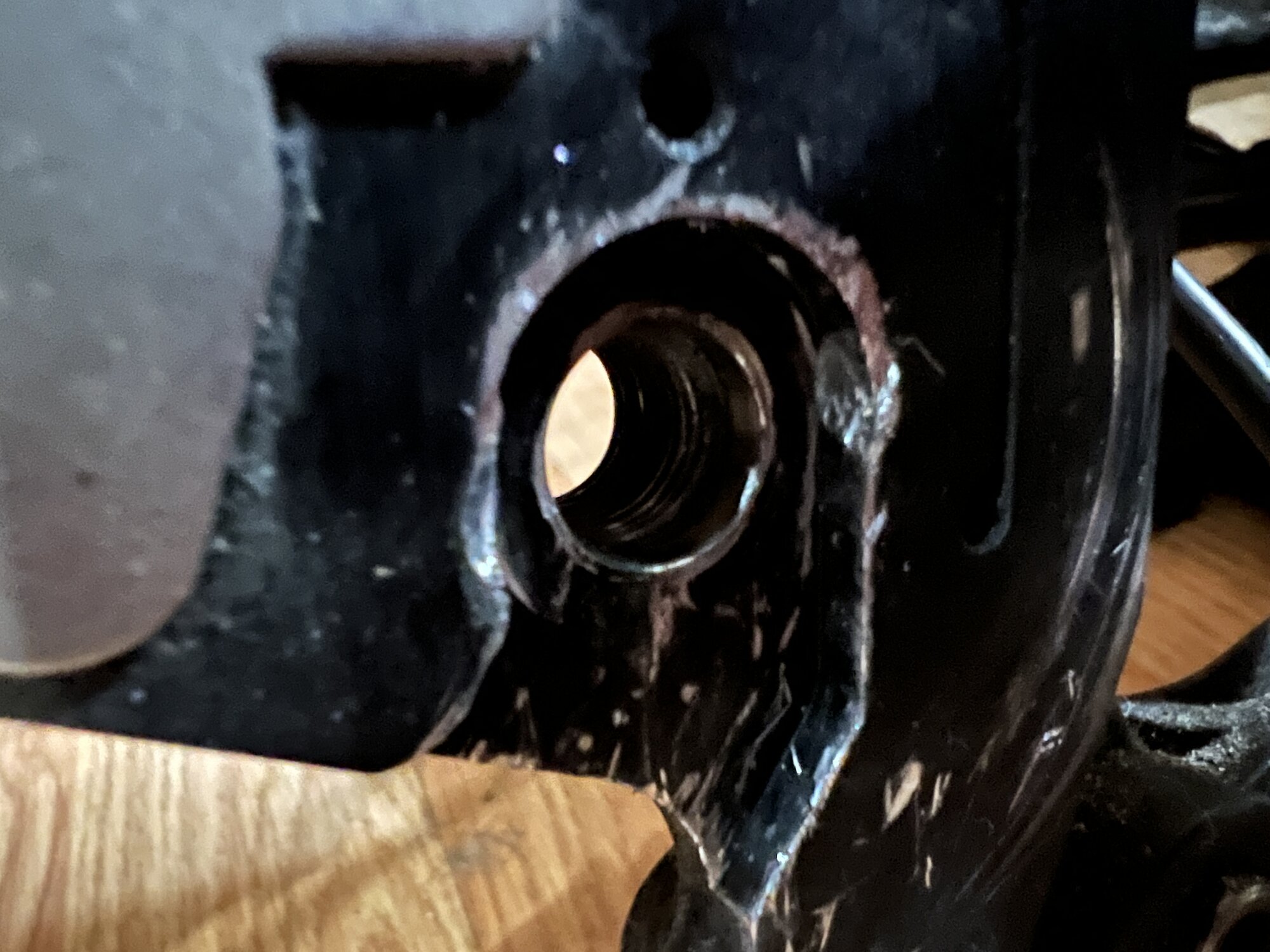

There is also a big risk involving the rear wheel : that is when the TQ vlue is @1v or higher that also implies that the thru axle it's not tight enough and that can actually create a big problem with the motor wheel spinning out and breaking the cable ;
that's exactly what happened in my case but that's also because I was changing the tire/tubes quite a few times so the dropouts got worn out(I actually had those changed too they can easily be changed -2 small parts that can be ordered , i changed those one time but it looks like they need to be changed every 6-7k miles or just need a lot of care when moving the rear wheel in/out.

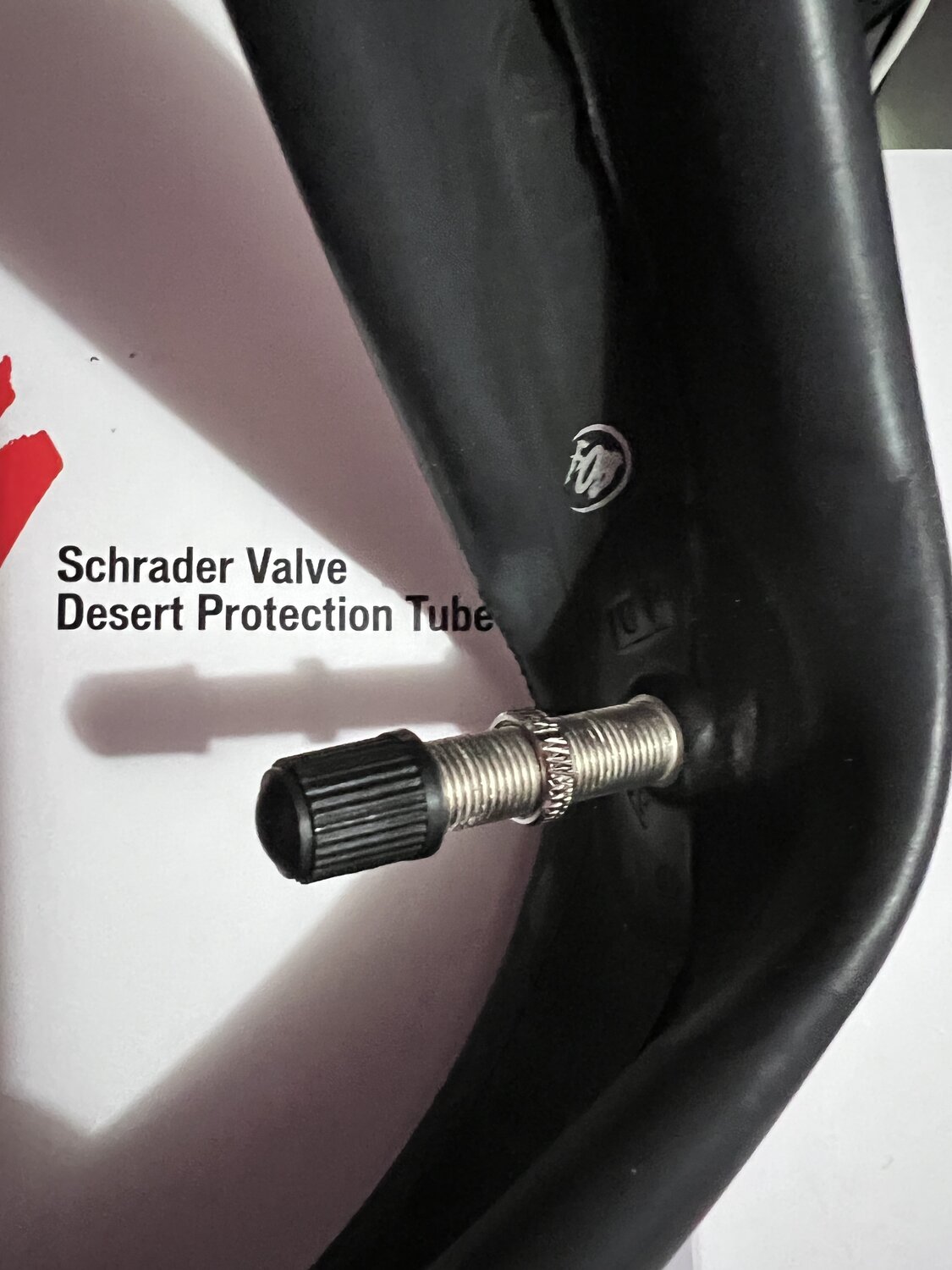

I would highly recommend the thorn proof tubes from specialized.
And also a torque arm, i just installed the Grin tech one, this way the wheel would never spin out.
