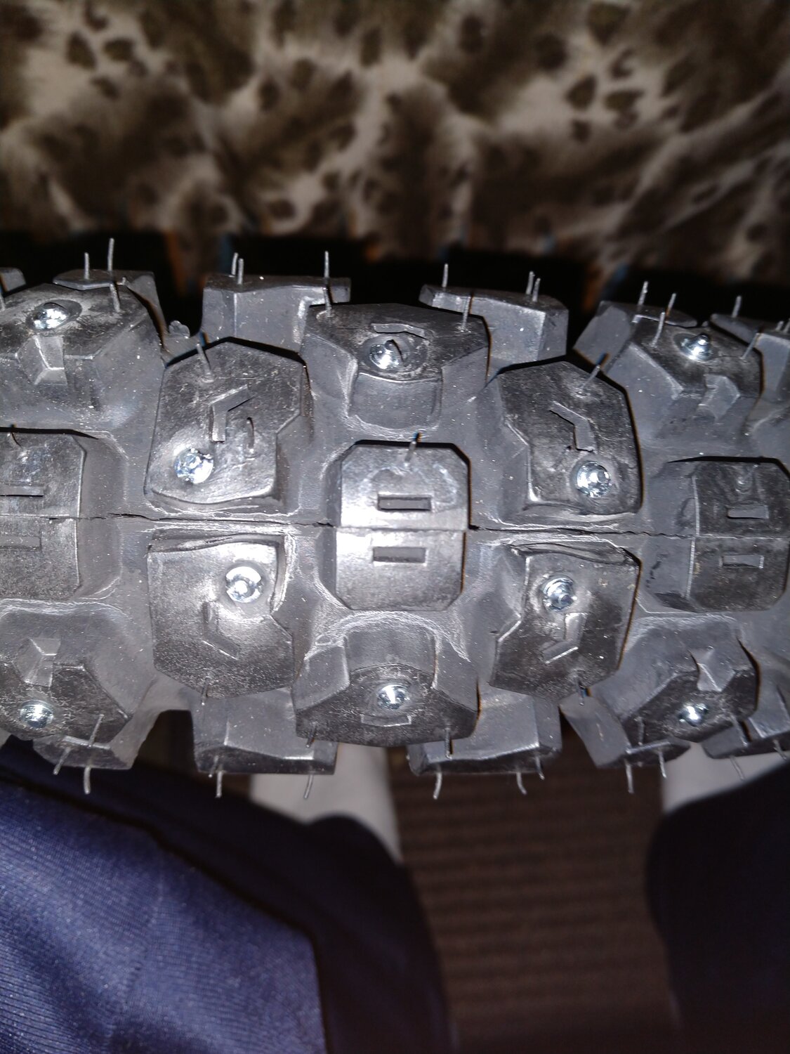

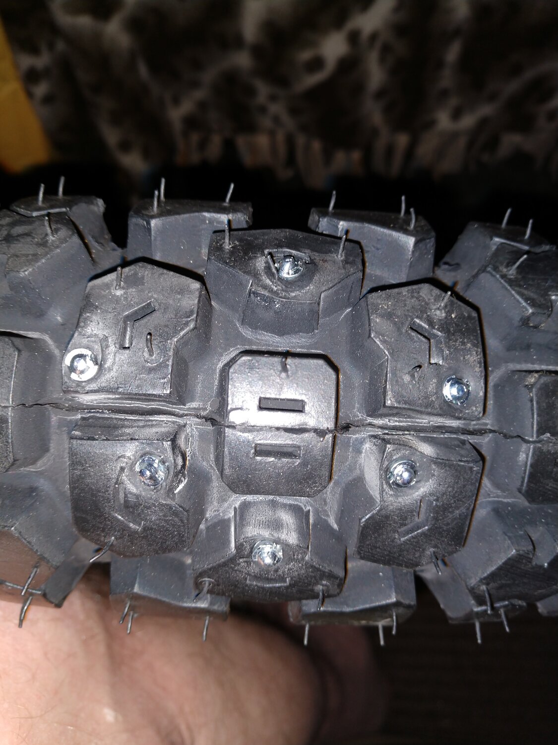

Holy smokes 3/8" tall knobby now knowing how tall the knobby is time to get studs

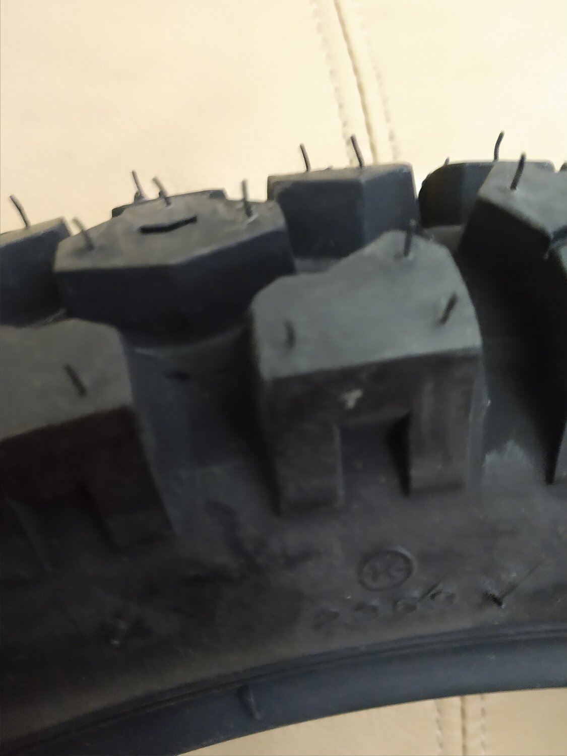

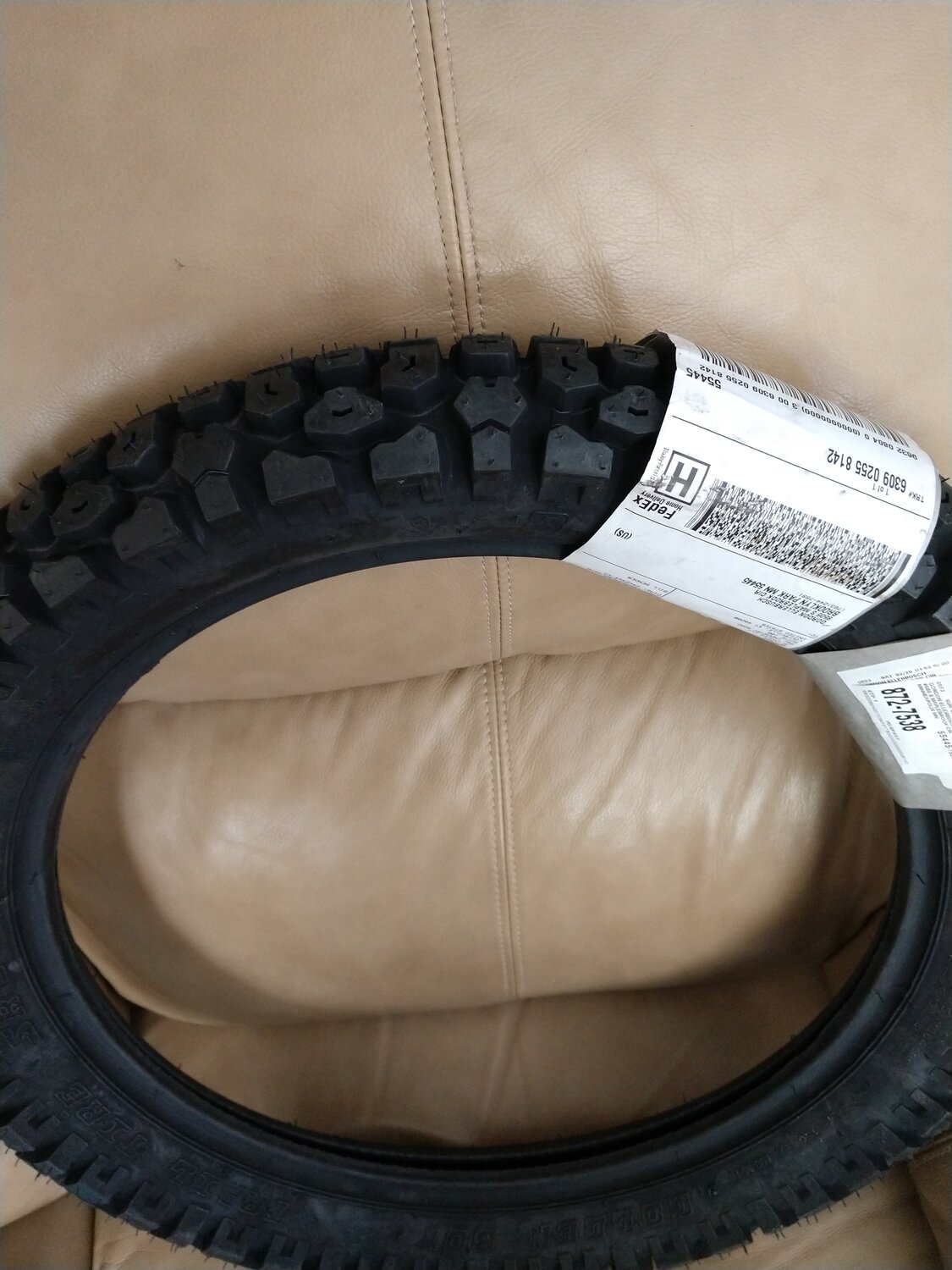

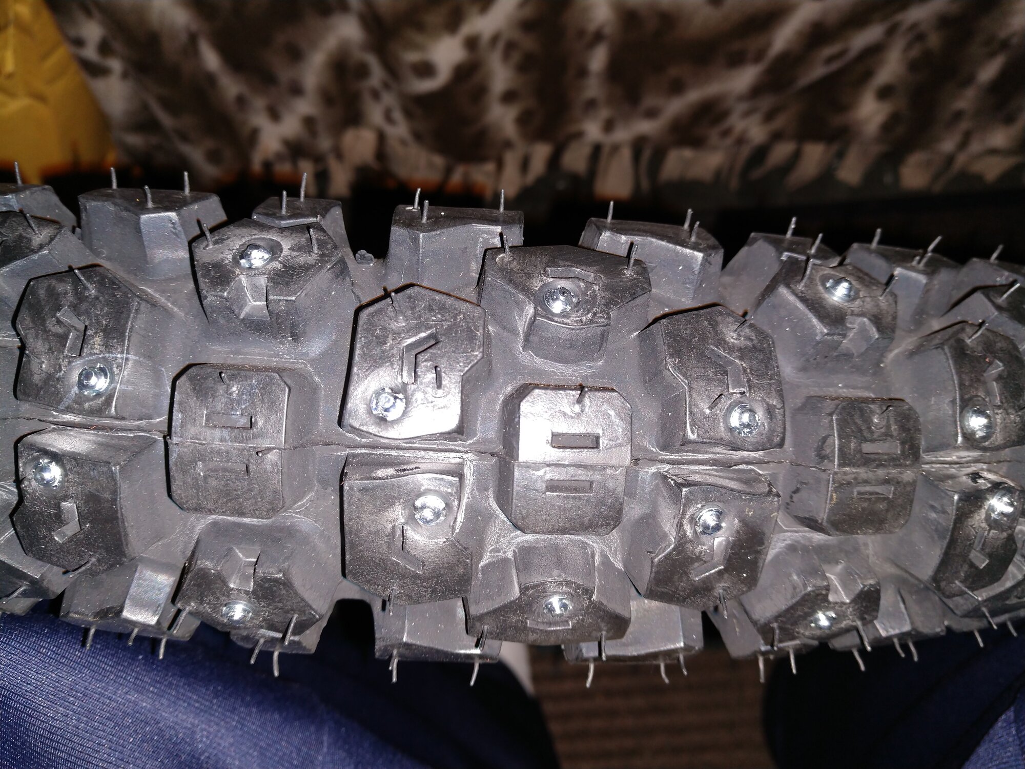

On Amazon marrkay ms100 studs almost 200 pcs in tire
