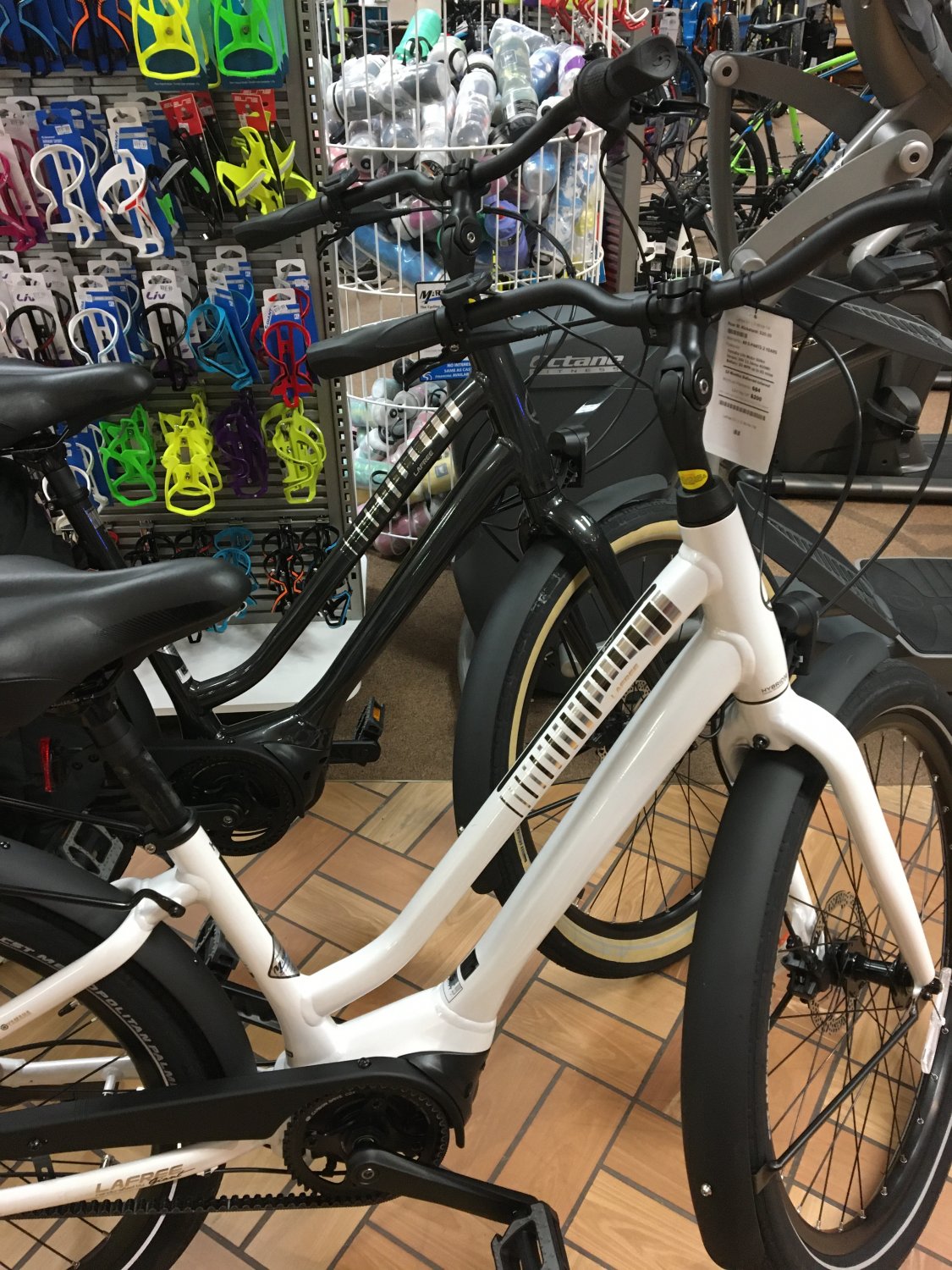

I don't have any outdoor photos; it's a bit chilly in PA to ride -- for us, at least! Here they are in the store -- the white is mine, and black is my husband's. We can't wait for Spring!
Good On Ya .................. ! :cool:
My Wife & I did the same thing.
And we really feel we made the right choice in regards to an Ebike that "Feels Like a Bike".
