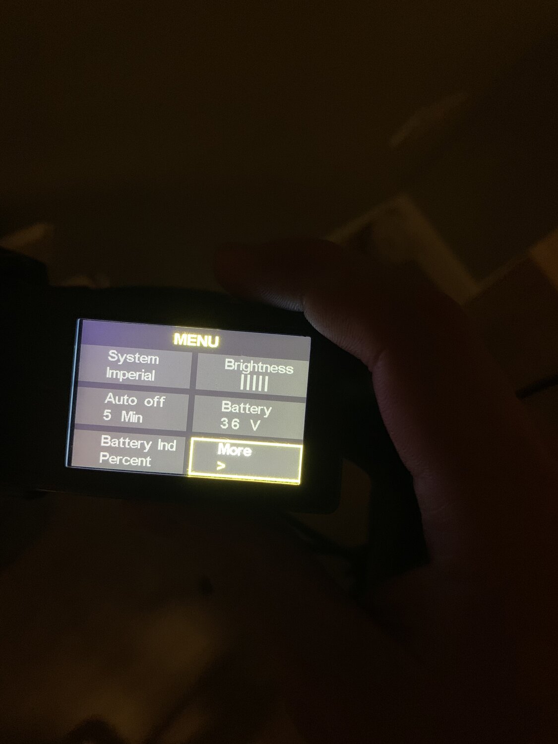

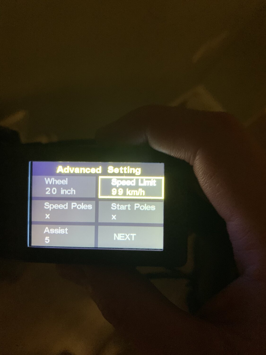

Some more pics, managed to get out today for an hour or so. Bike looks amazing.. Great fun to ride, everything works as expected except for the throttle. The bike is restricted to 15.6mph, the motor cuts out when it hits that speed.. the throttle is supposed to prevent the motor cutting out and allow the bike to reach max speed but even with the throttle the motor is still cutting out at 15.6mph. I’ve called NewGen and they’ve said that they will get back to me Monday with the solution.
The display has an ‘extras’ menu that requires a password to access. I asked Maria at NewGen and she said that’s for them to restrict the bike and they legally can’t give the code out but I’ll figure something out online and maybe try resetting it to de-restrict it.

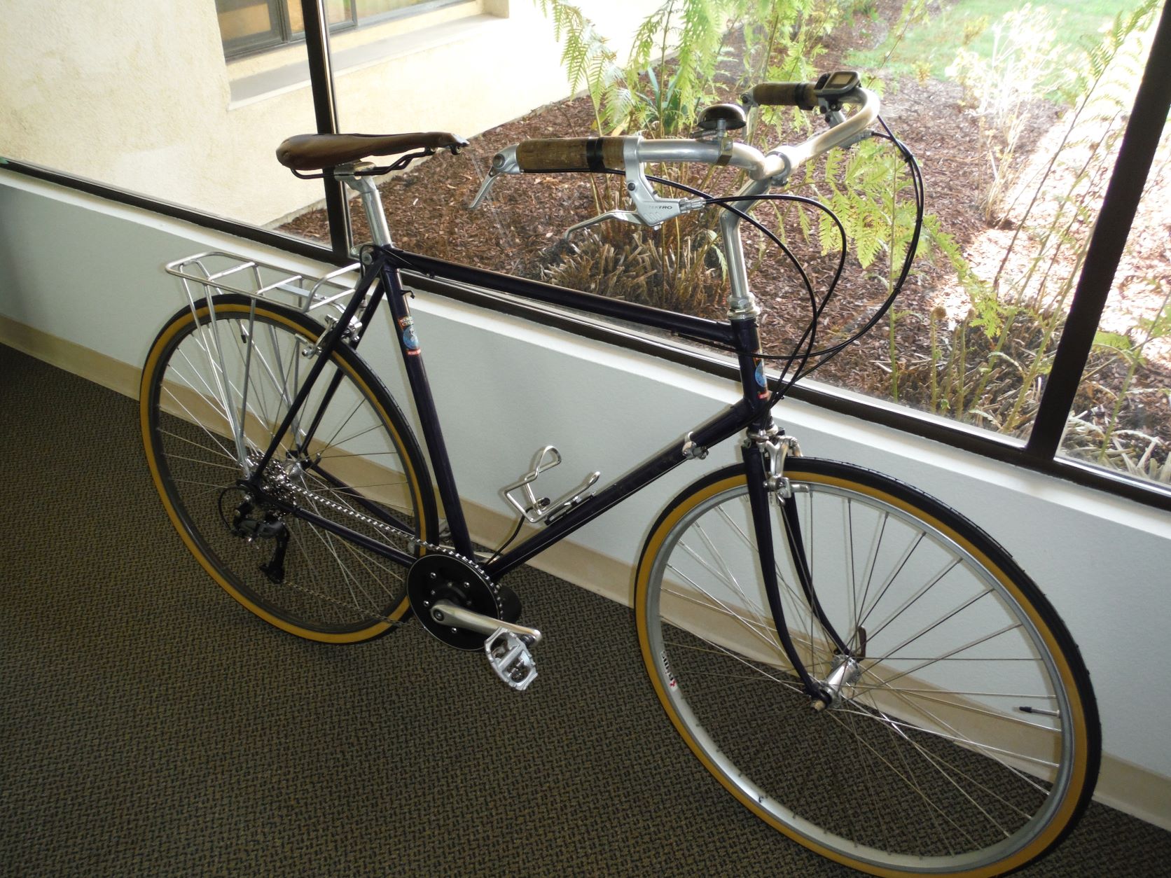

Just for fun, this is what one of my electric bikes looks like. Speed is set at 45Km at 100cm circumference wheels. So programed speed is about 2.2 times faster than 45 because these wheels are that much larger than 32cm diameter, 100 circumference. A battery drops into the water bottle cage. The motor is between the pedals. The throttle is in your foot like a car. Torque sensor. Push down to go.

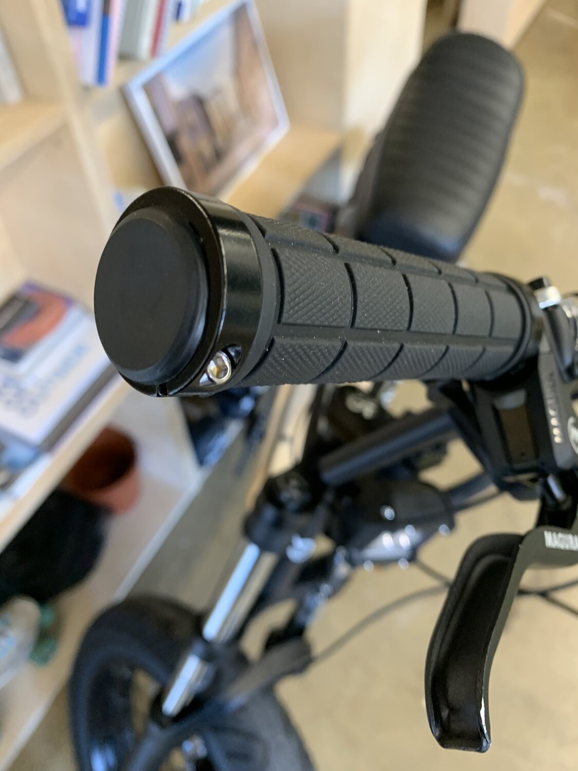

Can you get mirrors in the end of the bars though, does the bike allow this? I’ve bought a mirror that sits on the actual handlebar. Thanks.
Not sure mate, here’s a pic.

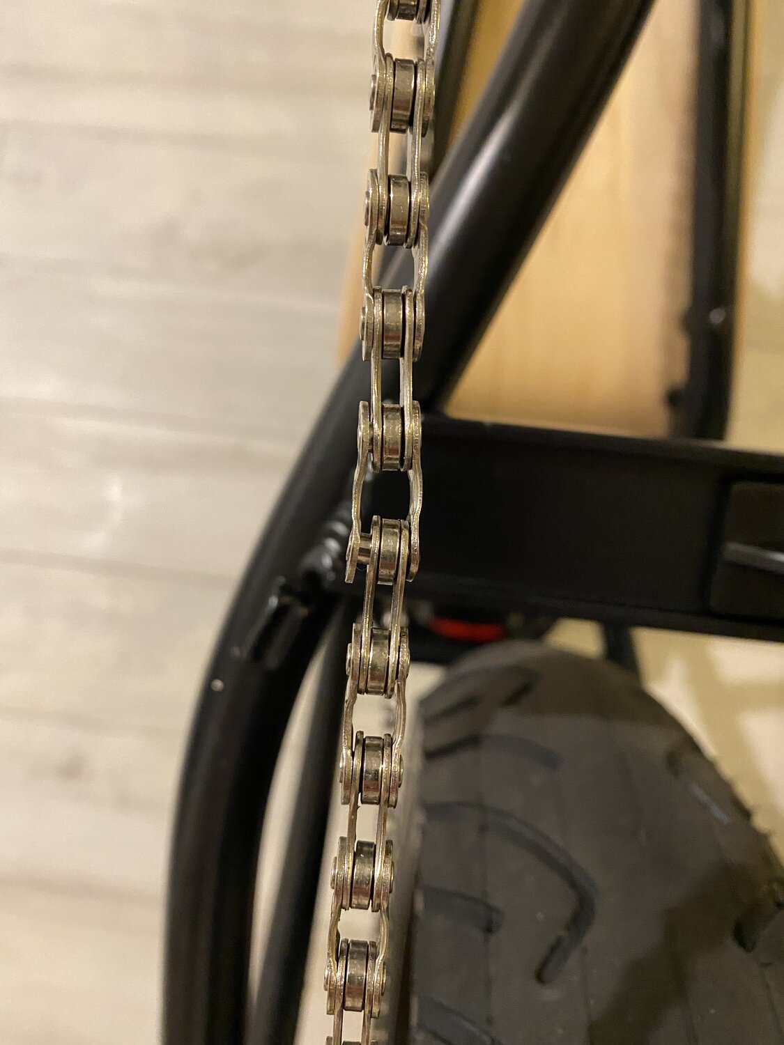

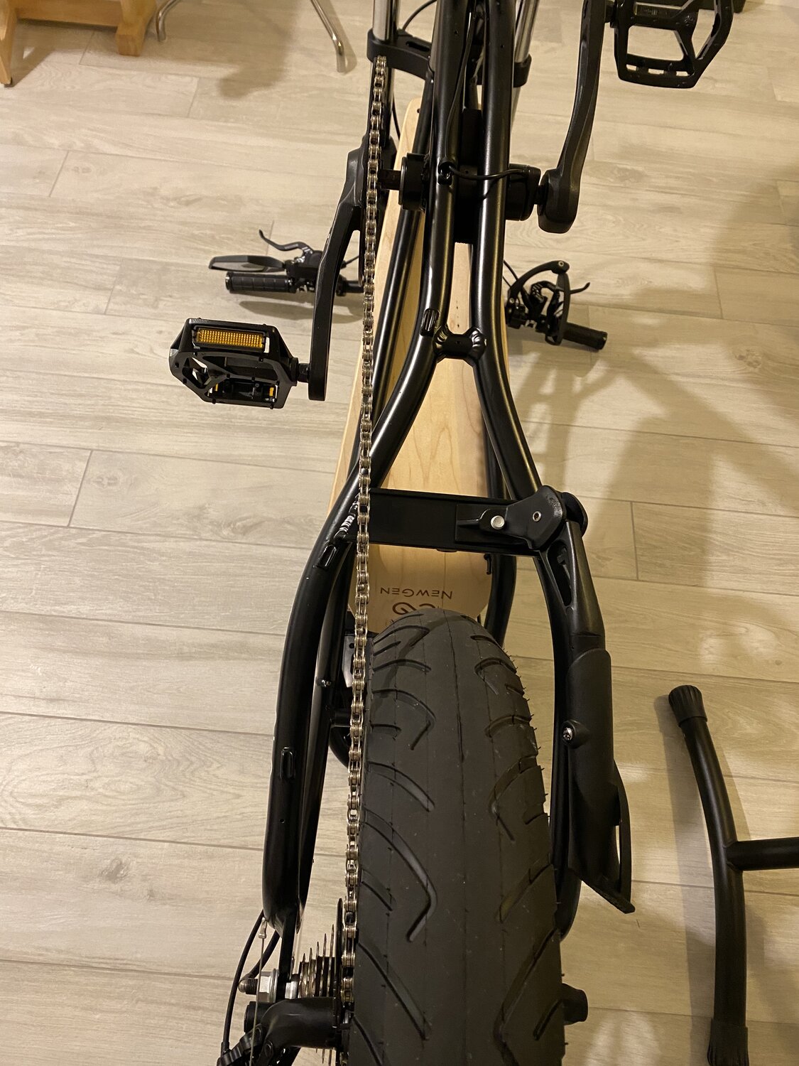

So, the bike arrived today (DHL issues delayed it by a day) lovely bike as we know… but I’m having issues.. I seem to be cursed, I can change gears down, but not up, chain is now off, early attempts to keep it on have failed, throttle also seems to be under performing.
Sorry to hear that mate. I literally have not touched the gears since buying it, came set on 8th and I’ve left it there. What do you mean when you say the throttle is under performing? Is it getting you up to the max speed?

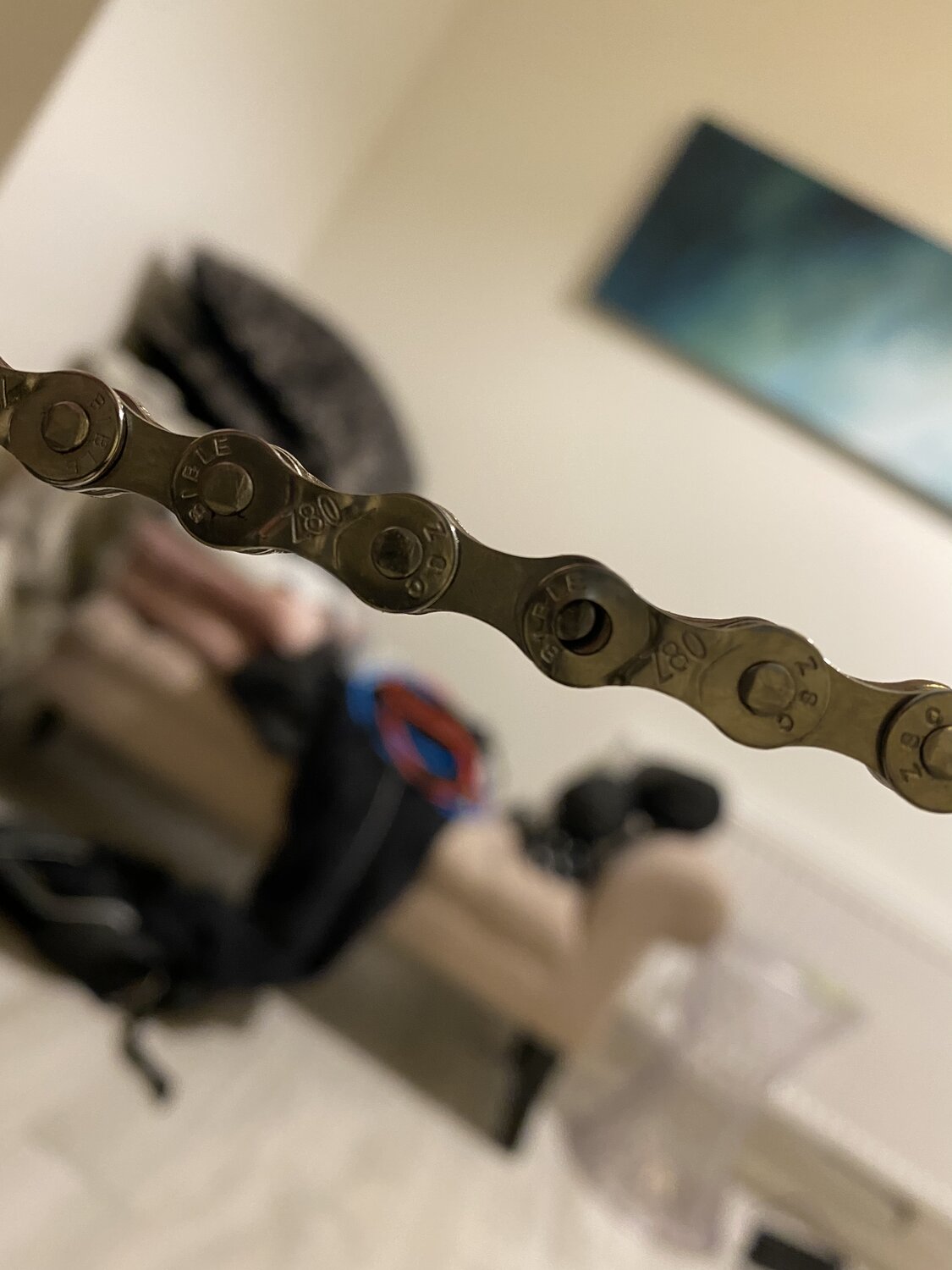

It came in 8th gear, I changed through them down to 1, then it wouldn’t change up. There appears to be a rogue link, looking down and from the side. Also.. unsure if you can see it, or if it is right, or a fault.. if you look down the length of the chain it doesn’t run straight.. it’s slightly curved.. as for throttle, it was fine, it got me up to 15.5 but no more.. but now it’s about 7 max, a bit more downhill.

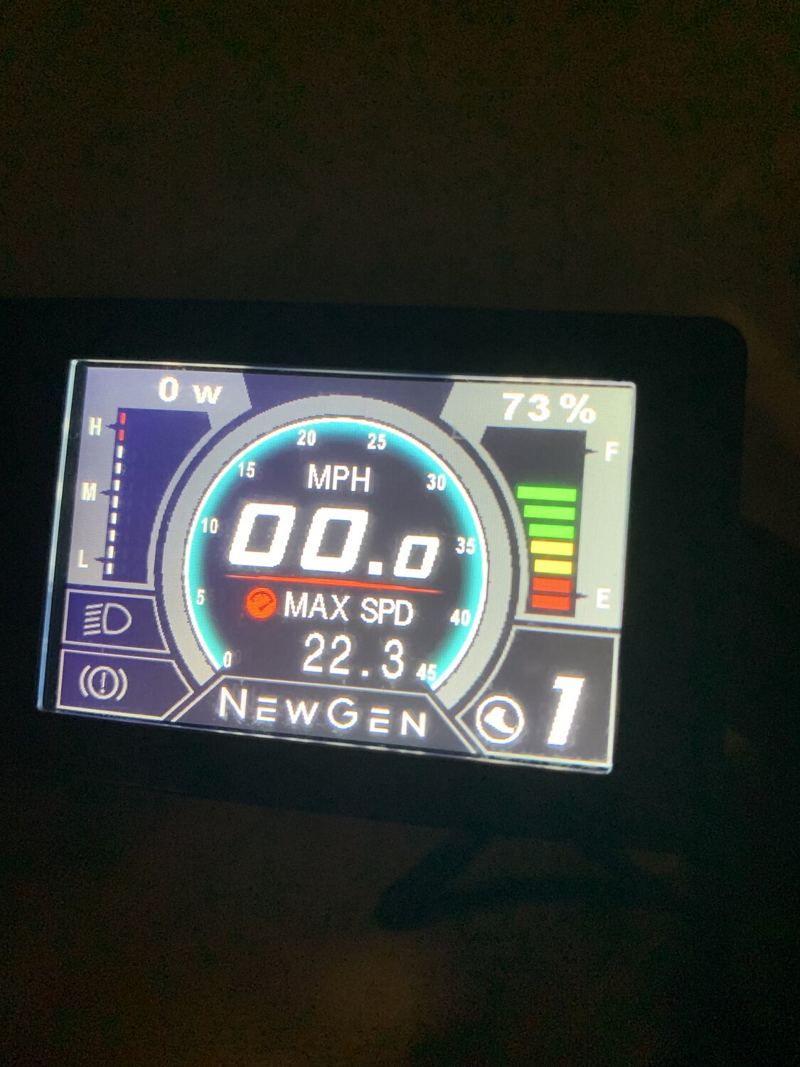

Yeah I can see that.. grim! Can you pinch that back with some pliers or something? Not ideal though, regarding the throttle, guessing you’re already on pedal assist 5 but on the display there is a ‘more’ section with the passcode 1919 and speed it set to 25kph max you can put that to 99kph which will stop the motor cutting off at 15.5mph. I’ve managed to get mine to just over 22mph.
