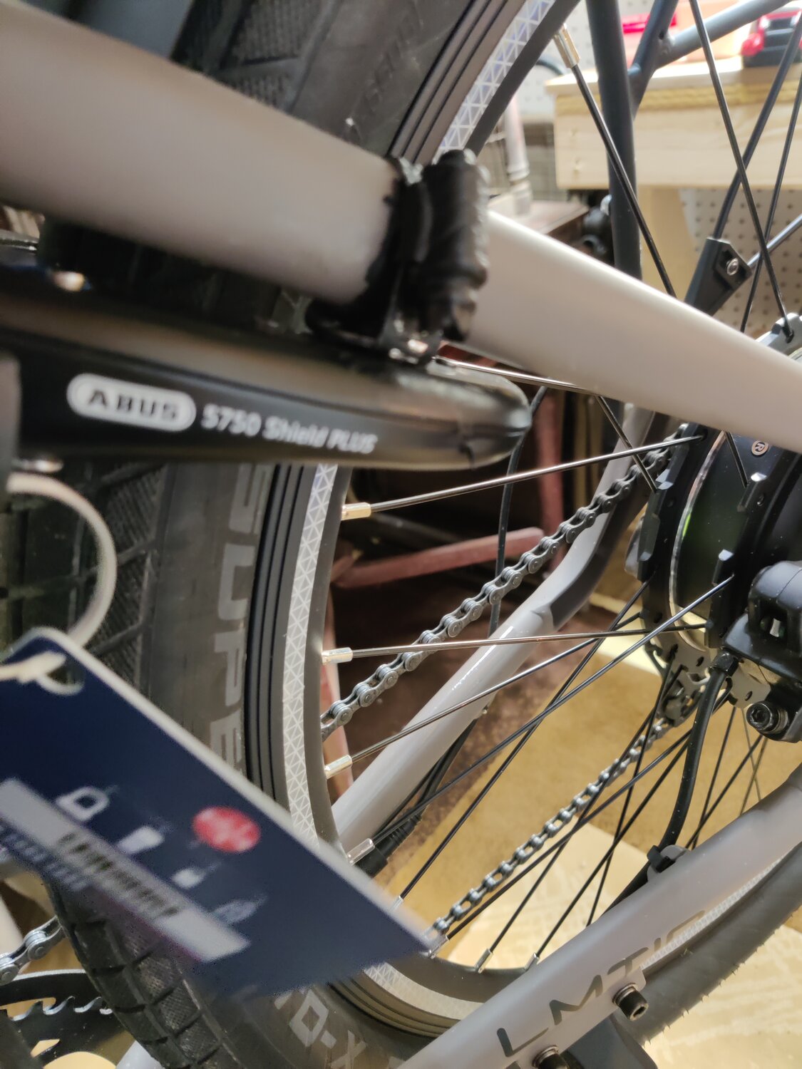

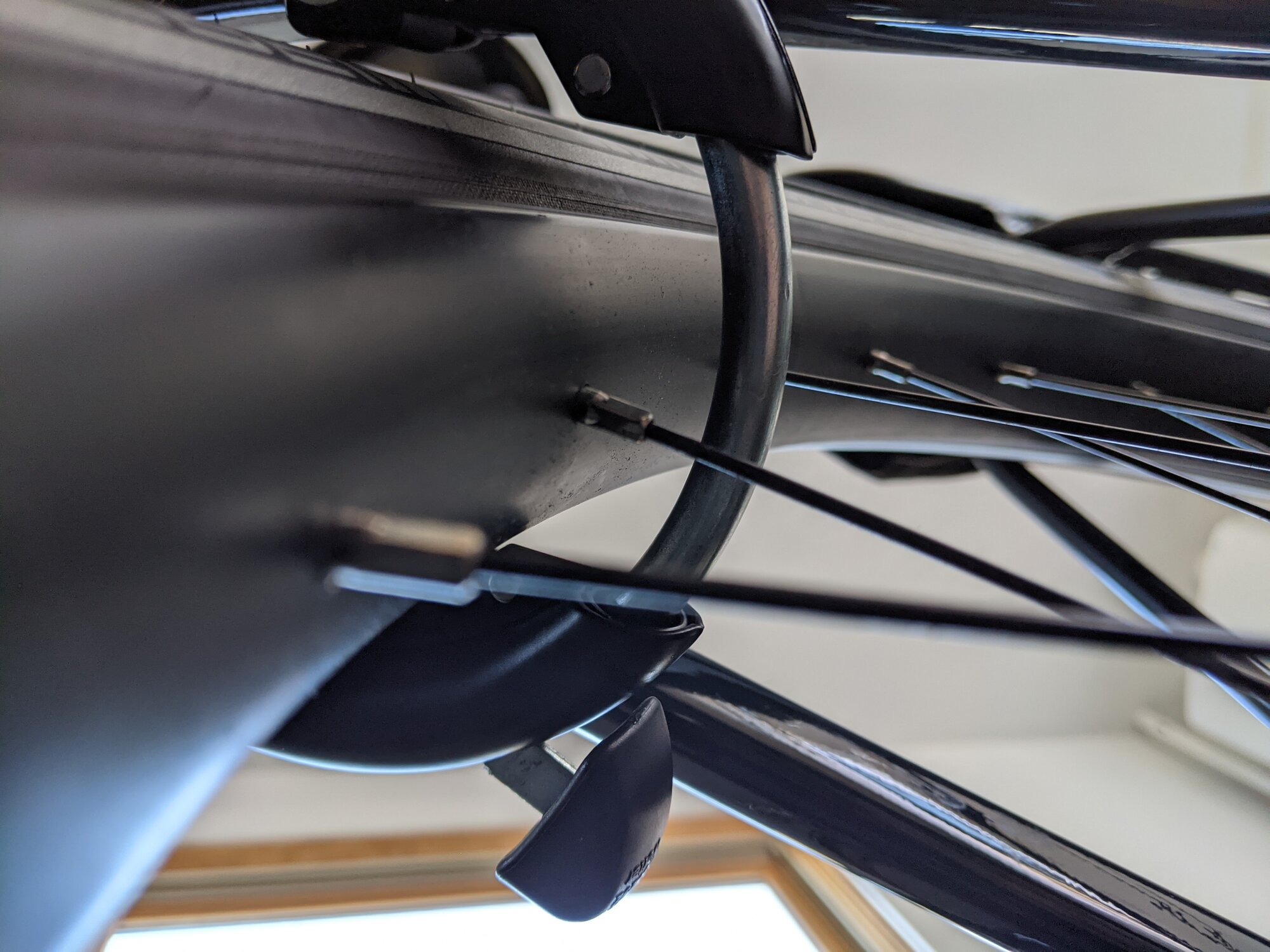

If you want more pics, let me know. Sorry for the dirt. I just got off the Northern Rail Trail.
Thanks for your info. I also used the ABUS Adapter Straps Kit to mount the Frame Lock, so far it's working out great. Would have much rathered to mount the frame but that's the way it goes. Trek should consider repositioning those tapped holes in the future.

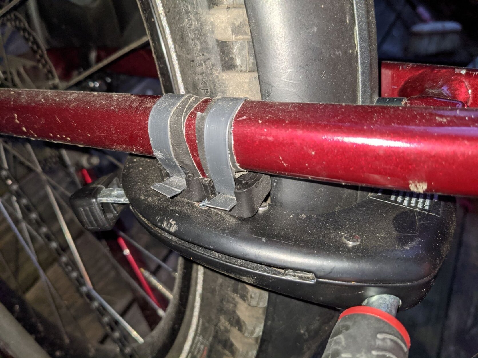

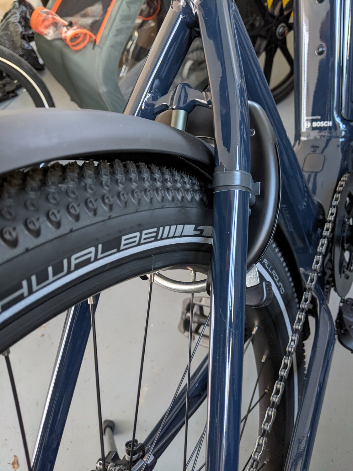

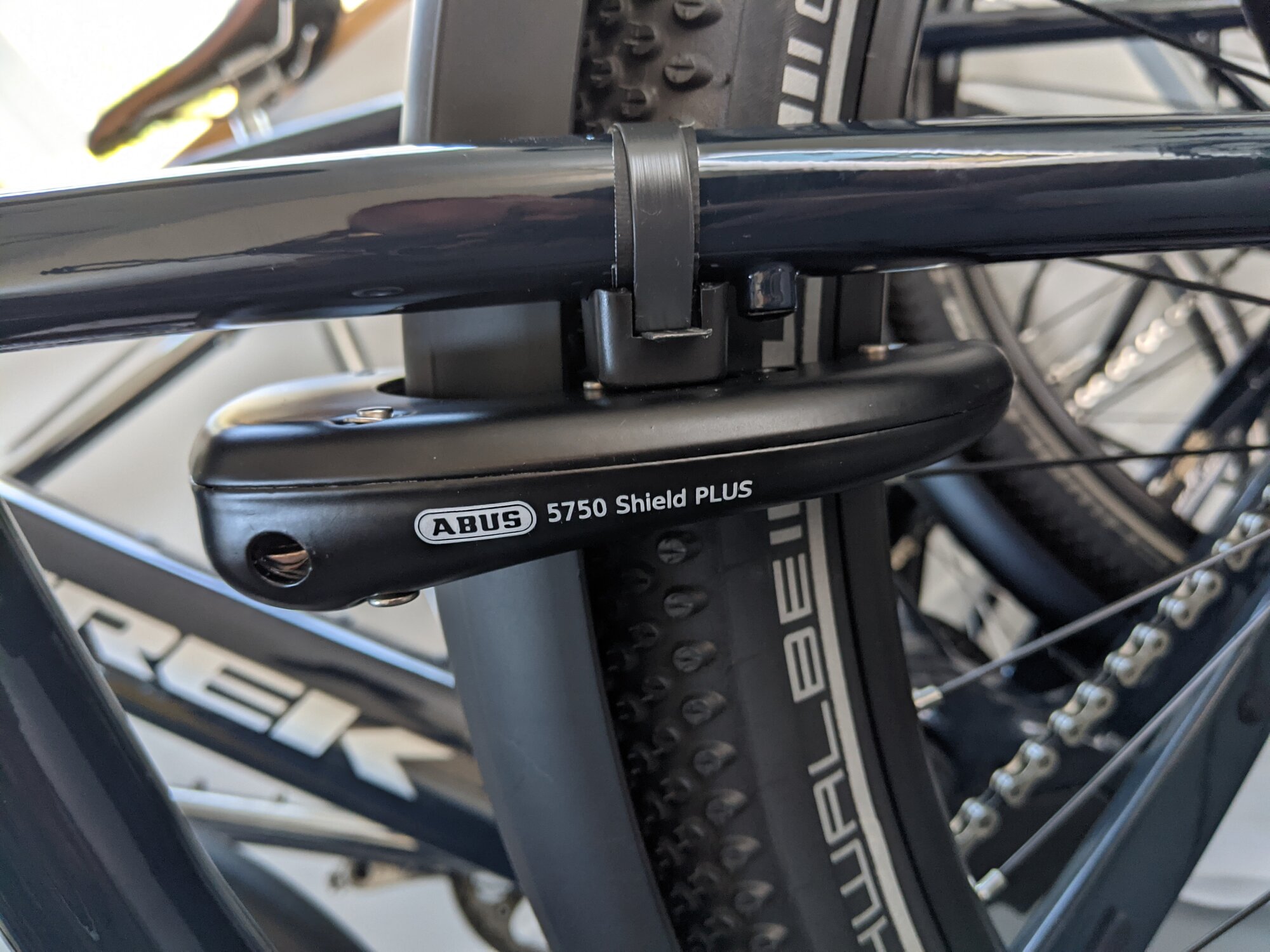

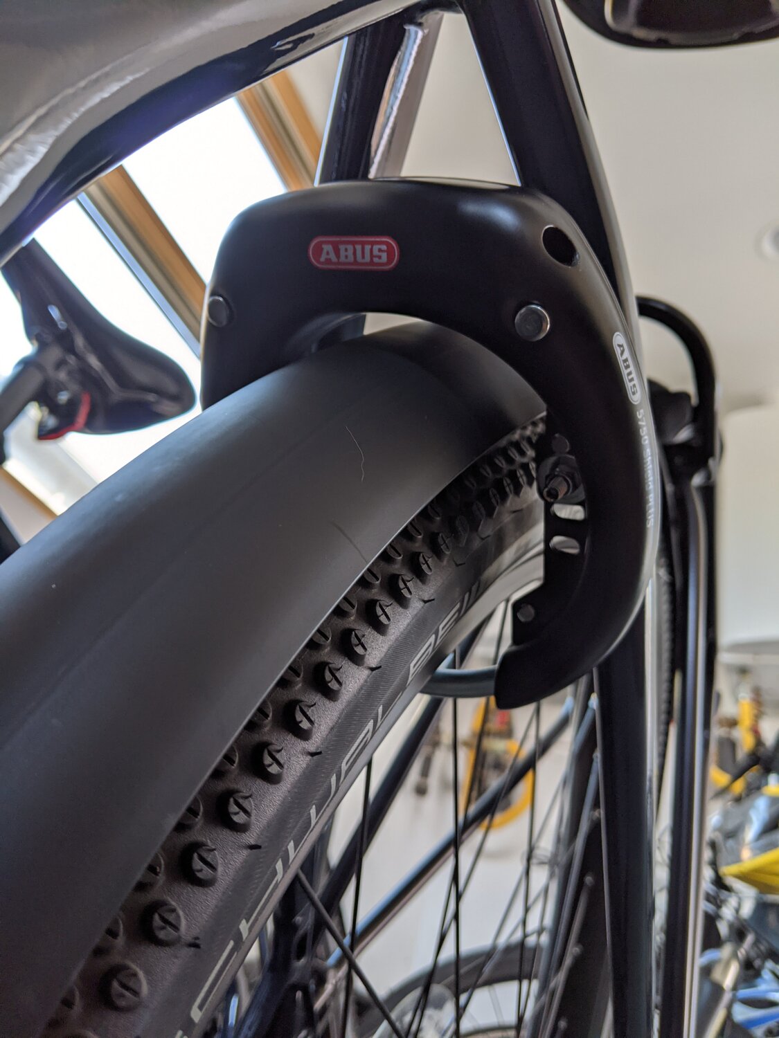

I ended up going with the straps too. Worked out really well. There is a little movement rotating around were it is connected to the straps. But very little and nothing I worry about at all.

That looks great. Nice and tidy.
I had no bosses on my Blix Vika+ for the Abus frame lock so instead used two U-shaped clamps normally used to hold electrical conduit pipe in place. I bent the wings, with the holes for screws, so the clamps fit around the frame on each side and the two holes on each clamp lined up with the mounting holes on each side of the frame lock. I then bolted the frame lock through both holes in each clamp. The lock is held tightly in place so there is no rattle or possibility of the frame lock coming loose and hitting the spokes. Easy and cheap solution (50 cents/clamp), but I have to admit it took me a while to find a workable solution.

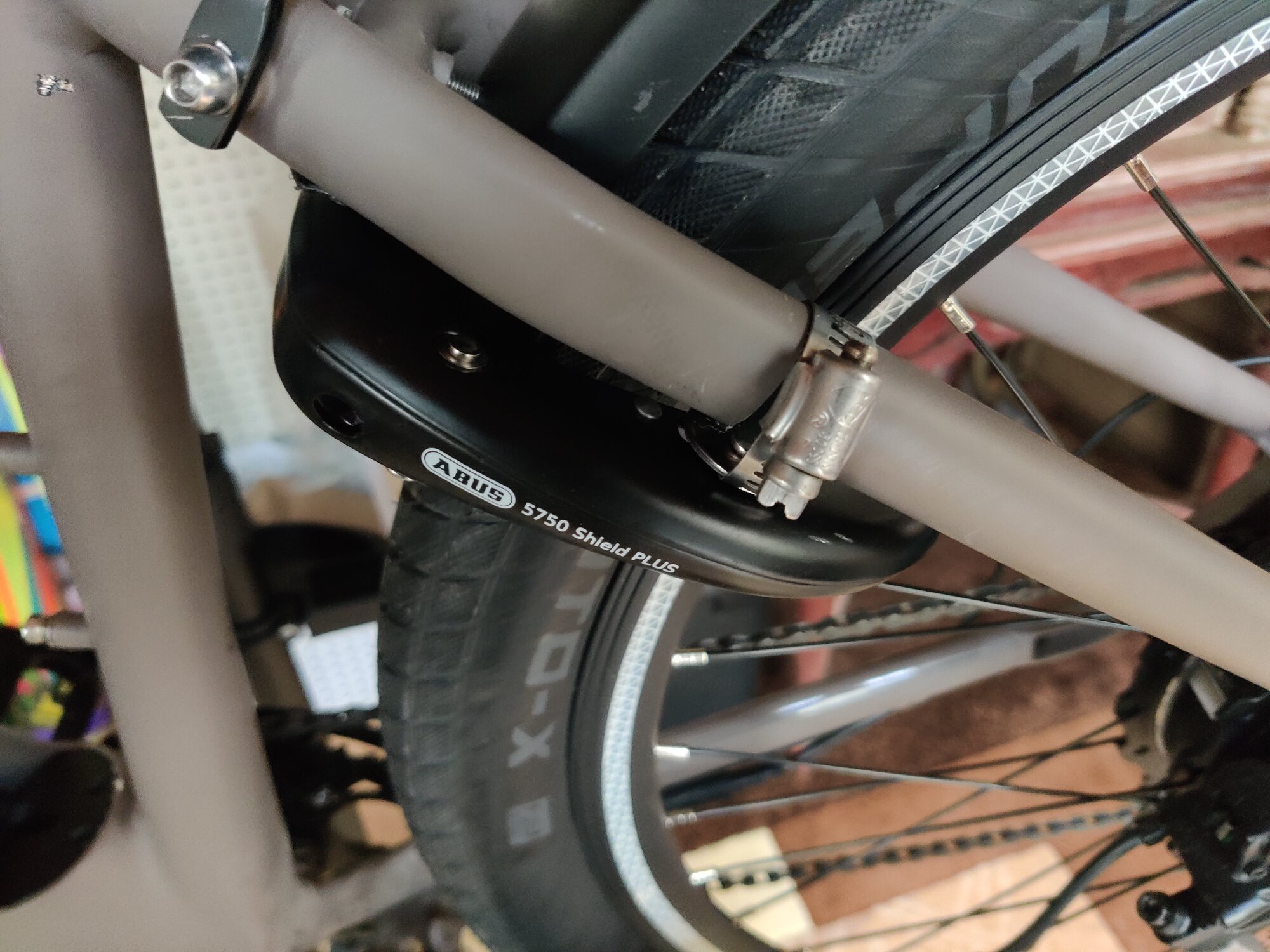

I mounted an Abus frame lock to my Ride1Up Lmt'd using hose clamps. Drilled a hole through the hose clamp so that the tightening nut would be to the outside. I got a fender washer and bent it to radius of the frame using a pipe the same size (used a ball peen hammer to bend it). I put three layers of electrical tape around the frame to keep from scratching the paint. Then I ran a bolt through the washer, the clamp, and then the lock. It worked great. I finally bought some Pasti Dip (rubberized "paint" to put grips on tools) and covered everything. Unless you really look closely, you won't notice the clamp.
