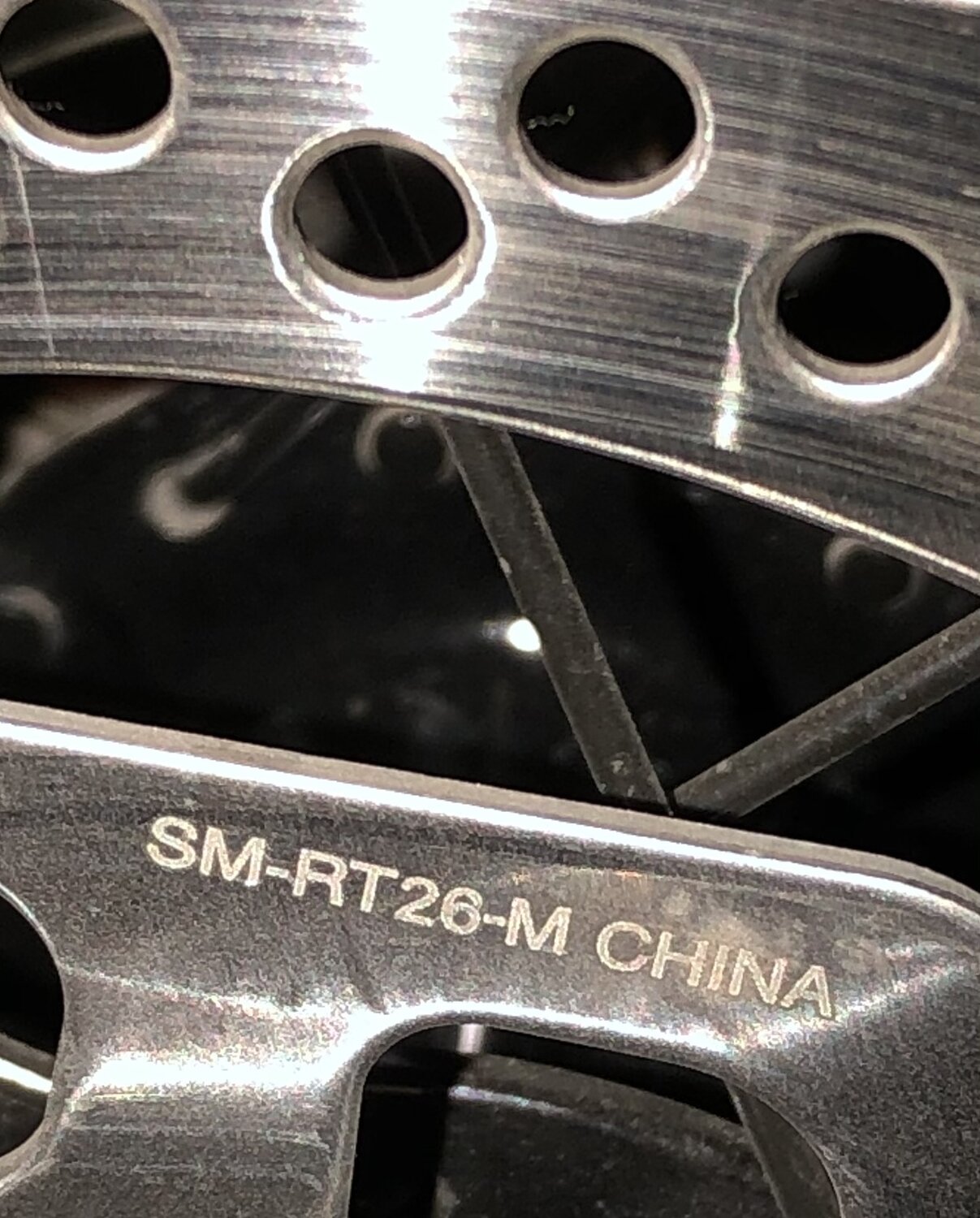

My Allant+7 came with Shimano SM-RT26-M rotors which take (exclusively) resin model B01S pads.View attachment 72336
I think the RT-56, and RT-66 rotors would be compatible too with your allant.The lbs ordered me rt-66 even though my bike has stock RT-56. Apparently RT-56 is out of stock everywhere on the planet. He said the RT-66 version would still take the same organic pads I use but also would be compatible with metallic pads unlike the RT-56 which only take organic.
