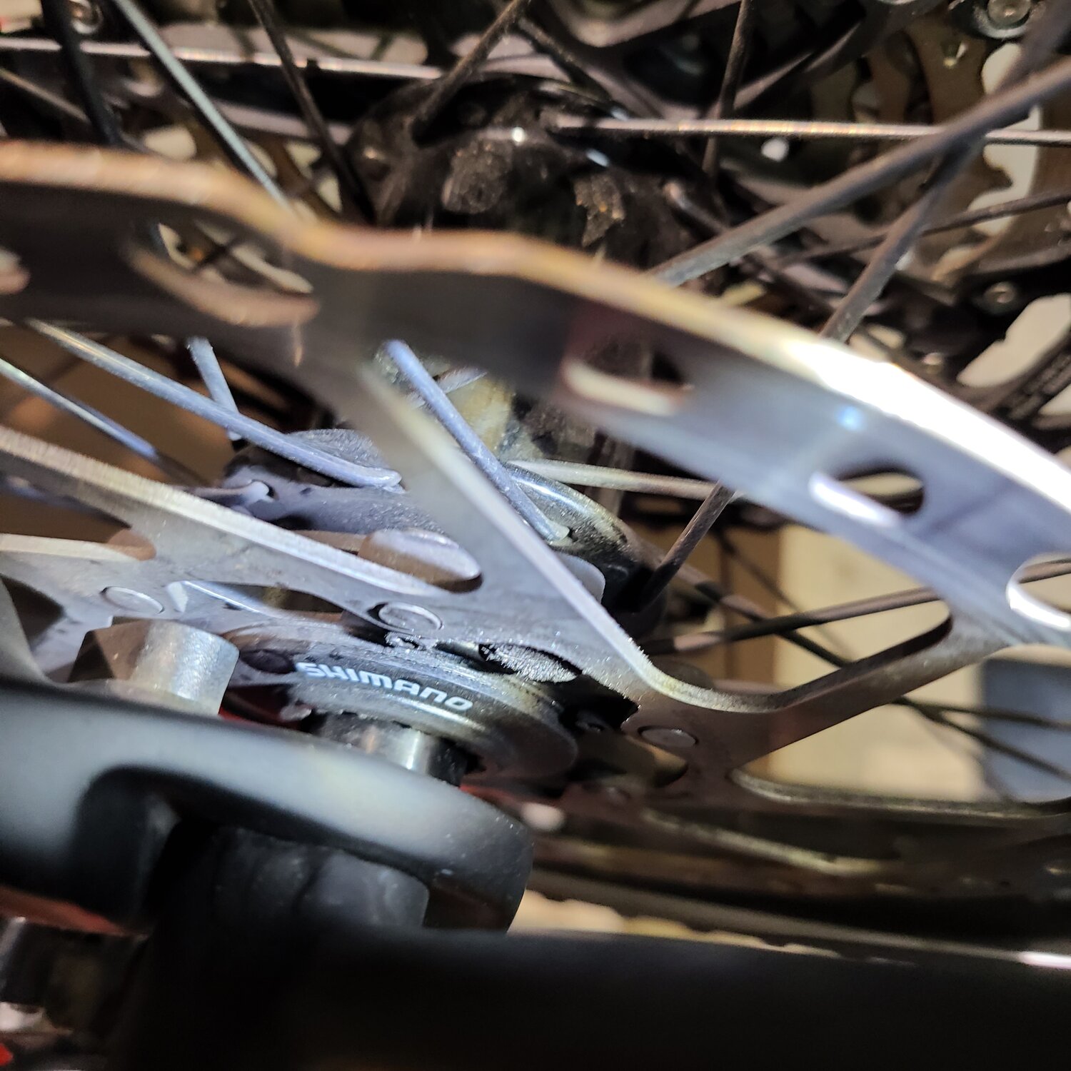

On my 9.9 the magnet for the speed sensor is built into the rear brake rotor. It is on the inside near center about 1/2" round magnet built into the framework of the rotor. Here is a photo of my spare. It is center lock and you can see the black magnet at 9 o'clock.
On my 9.9 the magnet for the speed sensor is built into the rear brake rotor. It is on the inside near center about 1/2" round magnet built into the framework of the rotor. Here is a photo of my spare. It is center lock and you can see the black magnet at 9 o'clock.View attachment 71841

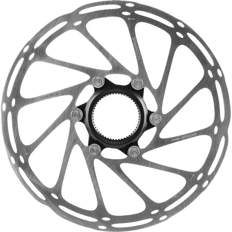

Akrotiri: I am concerned about your understanding here. Your statement is that it is "definitely like yours 6 bolts ...", and is seems you are referring to the picture of the previous post which is NOT a 6 bolts rotor but rather a centerlock rotor. A centerlock can still have what looks like 6 bolts but are actually more of a rivet than a bolt.
If it is centerlock, then the front and rear are most likely not the same, as others have replied the rear probably has an integrated magnet. I found the rear with the magnet much harder to find in the US as a retail product.
Also, when it comes to centerlock, there are two types of locking nut which is indicated on Shimano packaging. One has the tool engage internally and the other externally (the threads are the same). Shimano rotors seem to come with the nut, but you could reuse what you already have. For me my Trek has the internal style front and rear, but the new rotor came with internal for the front and external for the back. The important thing here is that you have the right tool for whichever you have or choose to use, and you probably won't have the choice of which one comes with the new rotor.

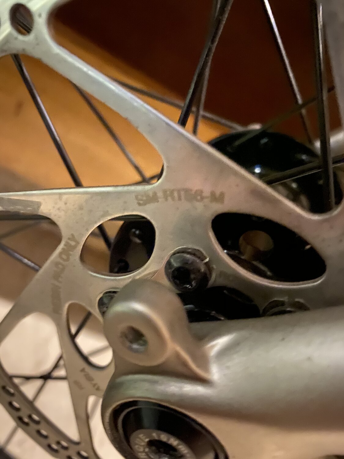

Here is a picture of Shimano SM-RT56M (180mm) rotor out of my spare parts shelf. It only takes resin brake pads (B01S). If you ordered SM-RT66 rotors you would need other brake pads!
No speed sensor is part of the rotor as the sensor is attached to the rotor by 2 screws, at least on my Specialized Vado 4.0.
HTH

Here are two photos of the rear rotor of my 9.9 You can see the magnet between two of the rivets on the inside facing the hub. On the other shot you can see the retaining nut (black with white "Shimano") that requires a special wrench Below is a link to the park tool version of that wrench:
View attachment 71861View attachment 71862
HTH
My rotors say “ resin pads only”. I’m going to call the lbs tomorow to make sure they order the RT56. The live chat person types rt-56 but linked to rt-66. My original pads are the shimano B01S so I’m 99.9% certain it’s the RT-56.
