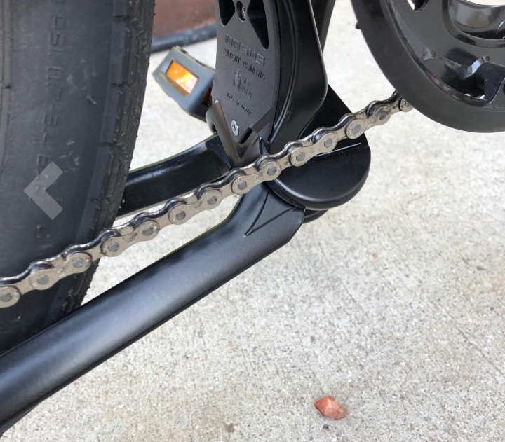

According to the spec drawings there is 97mm between the legs in the up position. The only concern i have is that it clears the chain.

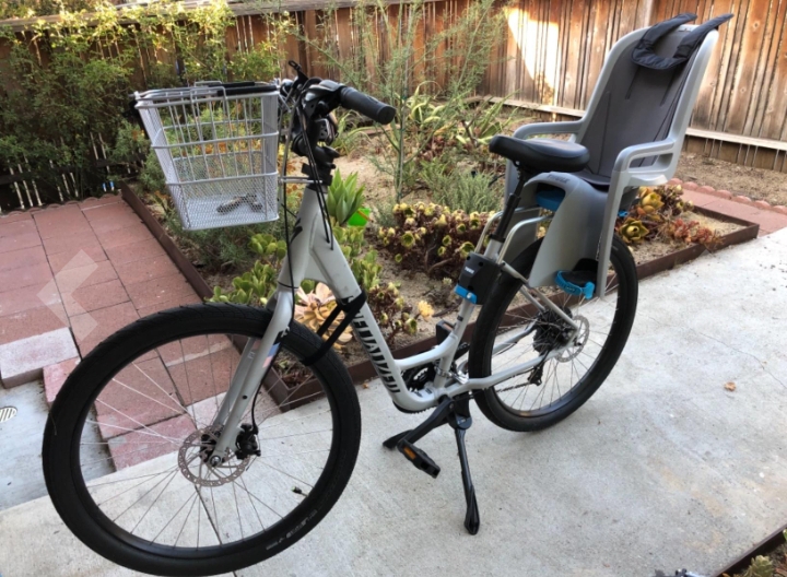

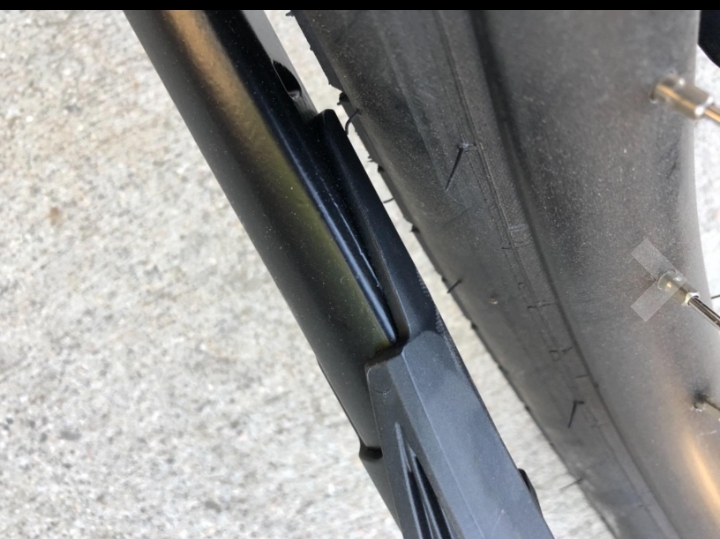

I think the 97mm (3.8") is the space between each foot. This 5 star review shows the area of concern.

John Peck pointed out that i may have an issue with the 2.25" inch tyres and referenced the 5 star review from another bike. And i thank him for his advice/warning. i didn't have a problem as the Moscow has a proper centre mount as part of the frame. The bike in the review had to use the mounting plate. The mounting plate places the stand several inches further back towards the tyre. This is what makes the difference.
I will do a proper review with pictures once i am done with the stand but here are the key points.
The ursus stand fit the NCM Moscow pretty much out of the box. One side was was almost touching the whiskers on the tyre. Being a little ocd'ish i found on examination that the stand has a spring plate on one side in the stand. The opposite side to the leg that was close to the tyre. To ensure clearance I took a 1x5x25mm piece of rubber and double sided tape and slid it into the recess where the leg folds up. This gave me plenty of clearance.
Even though the stand is advertised as 24-28" compatible, it sits around 10mm off the ground when the legs are down. The only issue this creates is the bike tends to "walk" if you have the stand out on a hill. My solution to this is to make a 10mm extension plate to fit into the frame bracket and capture the stand. I am currently looking for someone locally that still does metal milling.
