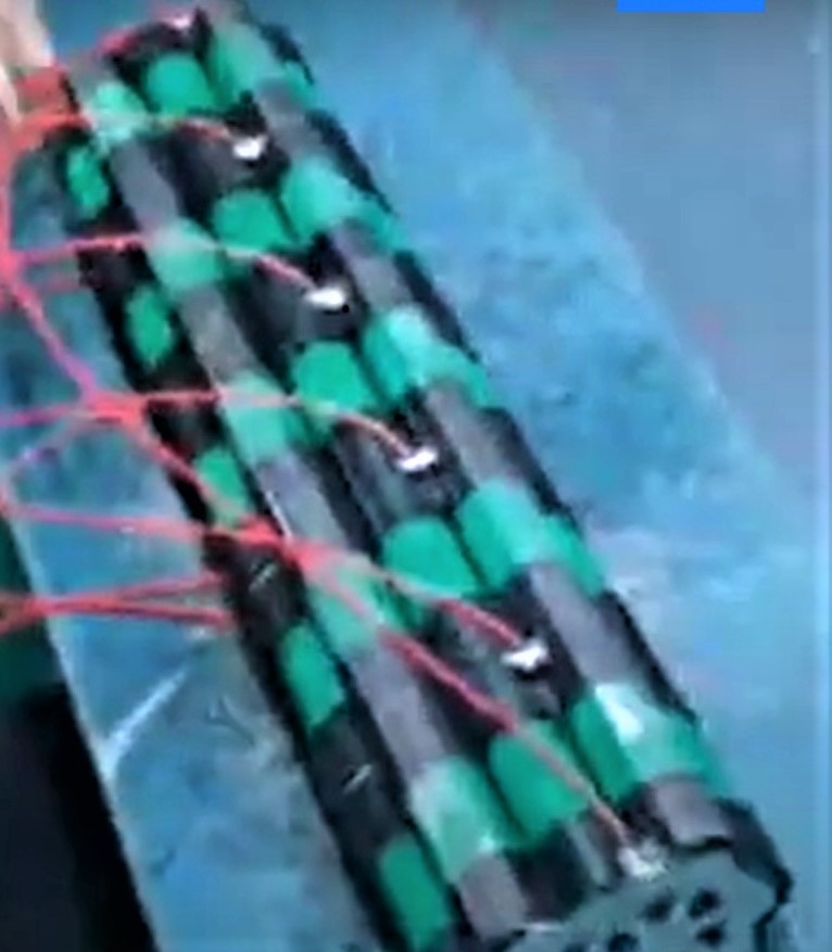

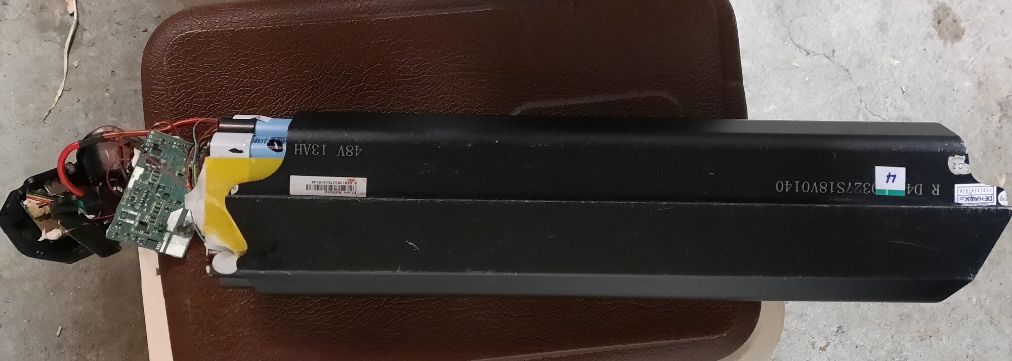

Has anyone had any success or has suggestions on how to get the cells on the Reention Dorado pack out of the case. I have one that's giving me problems and I want to test the individual cell groups. These things seem really tight in there. I'm attaching a picture of what the cell pack looks like once removed and the state of my battery where I have only been able to move the cells a short way (with lots of "persuasion").
Any thoughts welcome
