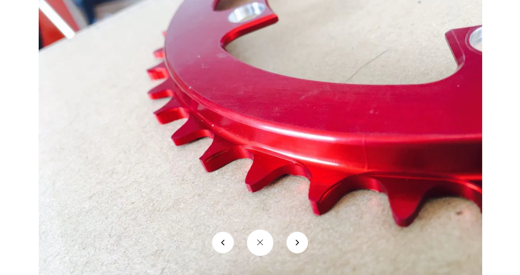

Has anybody ever seen this before?

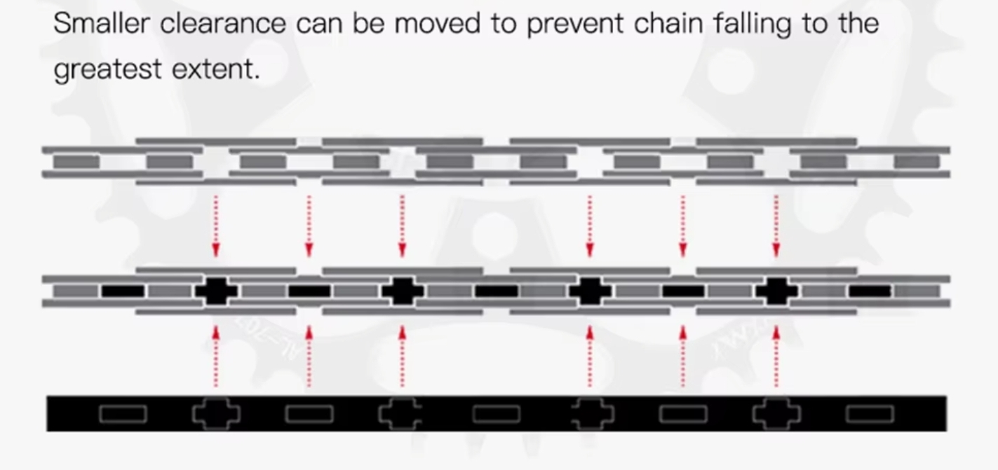

Basically instructing to place the Wide Tooth of the chainring between in the outer plates of the chain... leaving the Narrow Tooth to sit between the inner plates.
I haven't and have never take care to place the chain as shown.
I wonder if it has any validity?
Would it reduce Chainring wear as well?

Okay. Do you have a small piece of spare cut chain? Take the real chain off the ring and play with placing the spare length on the teeth. Move it back and forth 1/2 inch and see how it aligns. The wider tooth goes in the wider gap of the outside plates the wider part of the chain. The narrow tooth goes to the narrower inside gap.

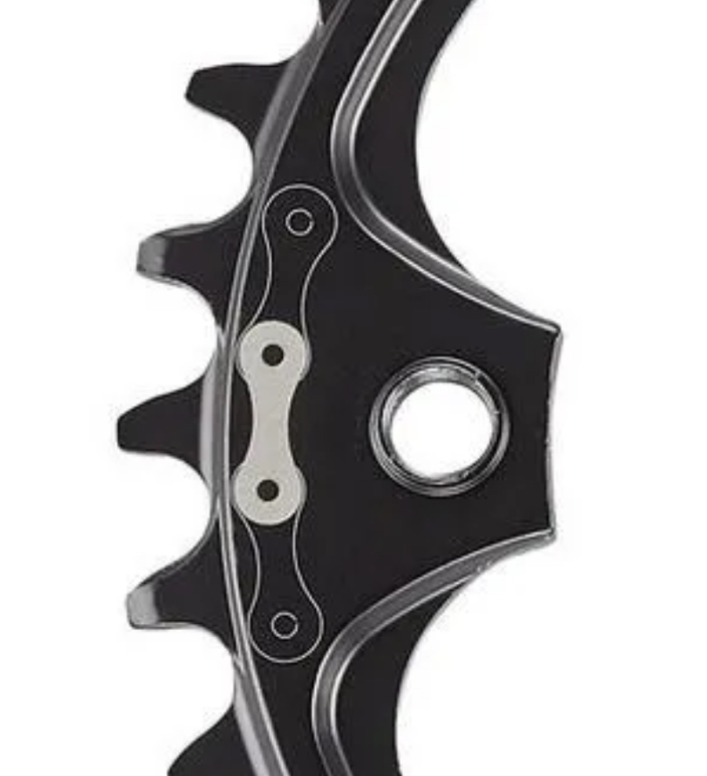

Yeah this is common, often these rings have a little diagram engraved in them. When placed incorrectly the risk of chain drops is allegedly higher by some unknowable amount.
Depending on the design, the chain may not really fit well the other way, so yours may always be correct. The praxis ones, for example, will definitely go on the other way.

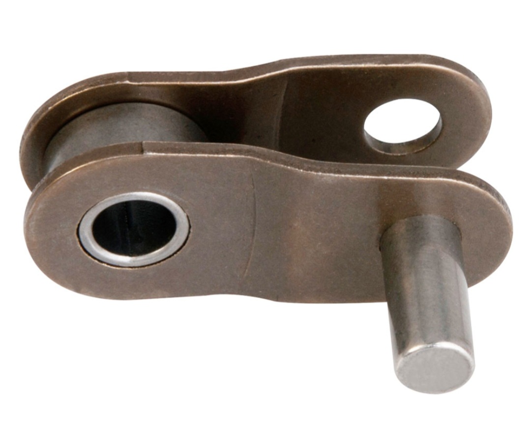

I remember that you couldn't use a half link to lengthen your chain, because it messes up the count.
The fat chain ring teeth need the extra space.
The chain wouldn't seat itself in the chain ring if it's off by a tooth.
I don’t have a choice of positions. The 12 speed SRAM chain only fits one way on the Wolf Tooth NW chainring.
Ok... I just checked and the same goes for my KMC e8X chain and my $6 AliEx Special. It currently has 2500mi on it showing very little wear. Mostly only the Black Anodised has worn from the teeth.
In other words no instructions are necessary because it's basically Gionni (idiot) proof and the chain will only sit on the N/W ring in its proper alignment.
