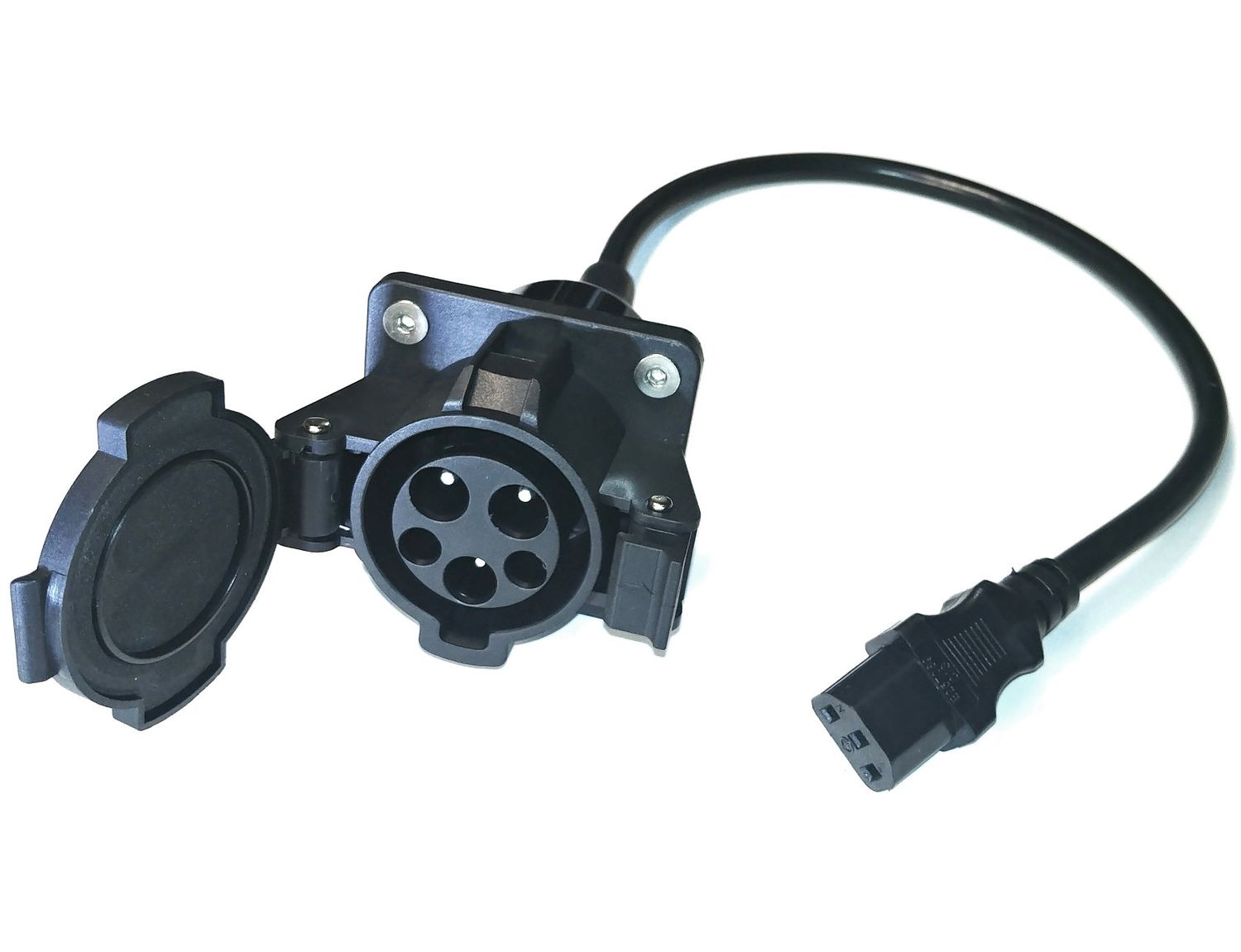

@mradel - I know @pushkar is a fan of the J1772 interface, and so am I for my electric car. But IMHO you would be better off with a C14/C13 interface (computer inlet!) and then for America use a NEMA 5-15p to C13 power cord to plug into an outlet. A standard AC outlet in your particular country is going to be far more available than upsetting a car at a charging station….
And assuming possible, do you really want to charge at car charger currents (5-6kW!)?? I believe 5A is standard for a 5p configuration; at 52V that is only 260watts (520W for 10A charging!). Not a good power match/use and the interface is large….
-BB
PS there are C13 to J1772 adapters too in case you really want to charge with a car…

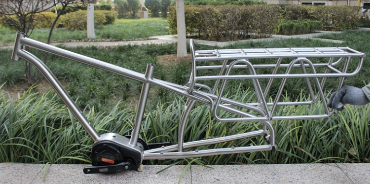

https://www.alibaba.com/product-det...offerlist.normal_offer.d_image.5b346a891yBu41
Been seeing these frames from this company for last 3 years or so.
Certainly not cheap stuff. >$1800.
Pushkar could do wonders with this frame and the X1.
An Ultra powered, long wheelbased Ti heavy hauler. Why not?
-BB
You raise good points and I’ll touch base with Pushkar. The idea (apparently not thought out) was to future proof the bike battery. In my area, we have a National Park and State Park side by side where I ride. They have charging stations throughout the parks but I would likely find a regular 120 outlet.
Check this frame out for the Bafang Ultra Motor. Love the internal cable routing. Never heard of this company so not sure about the quality.
The top tube on this build will be slighlty larger to allow for internal cable routing.
