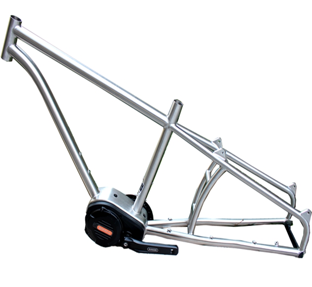

Yes - Pushkar now has / will soon have the ability to 3d print cases and he has a US battery source for custom packs.
duuuuuuuude... why you do this to me ? :)
basically all packs on hydra and helios are made in US. every single one of them.
We will limit onboard charging to 5A (battery inside the down tube) just for thermal reasons.
External charging will be up to 10A. The battery itself has a high amp charge port for that.

FramesetFrameWW Custom TI Frame Based on Salsa Blackborow GX Eagle Geometry

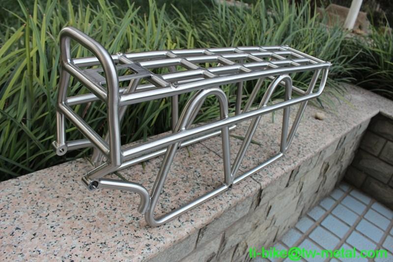

Rear RackWW Custom TI Rear Rack, Bolt
