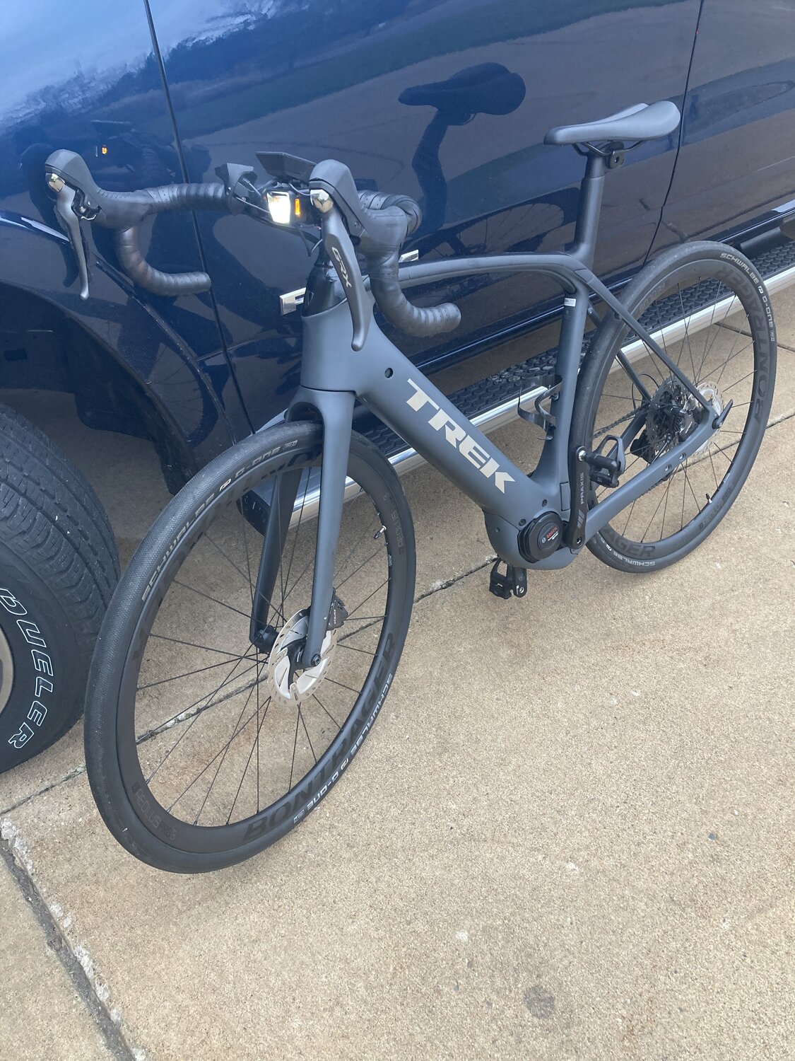

I've had my 2019 Domane+ for a year and a half now. Really loving it. About 2,500 miles on it this year. Swapped the Purion for Nyon (MY21). LBS did a great job getting it installed as that requires the motor to be dropped for the change. Learning more and more as I use it. Resolving to tinker with the assist levels in 2022. Plan to drop Sport down to current Tour level, Tour down to current Eco level and Eco down to 1/2 of current assist. Will tweak from there.
On group rides, I found zero assist is easier to manage pace lines on flat roads. Assist sort of makes the bike "lurch" and makes it harder to keep steady distance from back wheel of rider in front of you. Been pretty well received by the groups I ride with. A few digs here and there about towing people up hills. I usually counter with having them lift the bike when we're at a rest stop for a bit of context.
Agree that the gearing is not optimized for bombing downhill on slight inclines. Steep grades are fine b/c of weight of me + bike, but slight inclines exceed 28 mph pretty quickly so assist cuts out and then even in smallest rear cog and pedaling full out it can be hard to keep up with some other acoustic bikes. No big worries as I always catch up on the uphills. I did take my old Conduit+ on a group ride and that was a real eye opener. Assist cutting out at 18 mph and gearing made it real hard to keep up. My avg HR for those rides is usually between 140-145 and I think I was over 150 on the Conduit+. Just had to hang on to visual contact on descents + flats and make up time on the climbs.

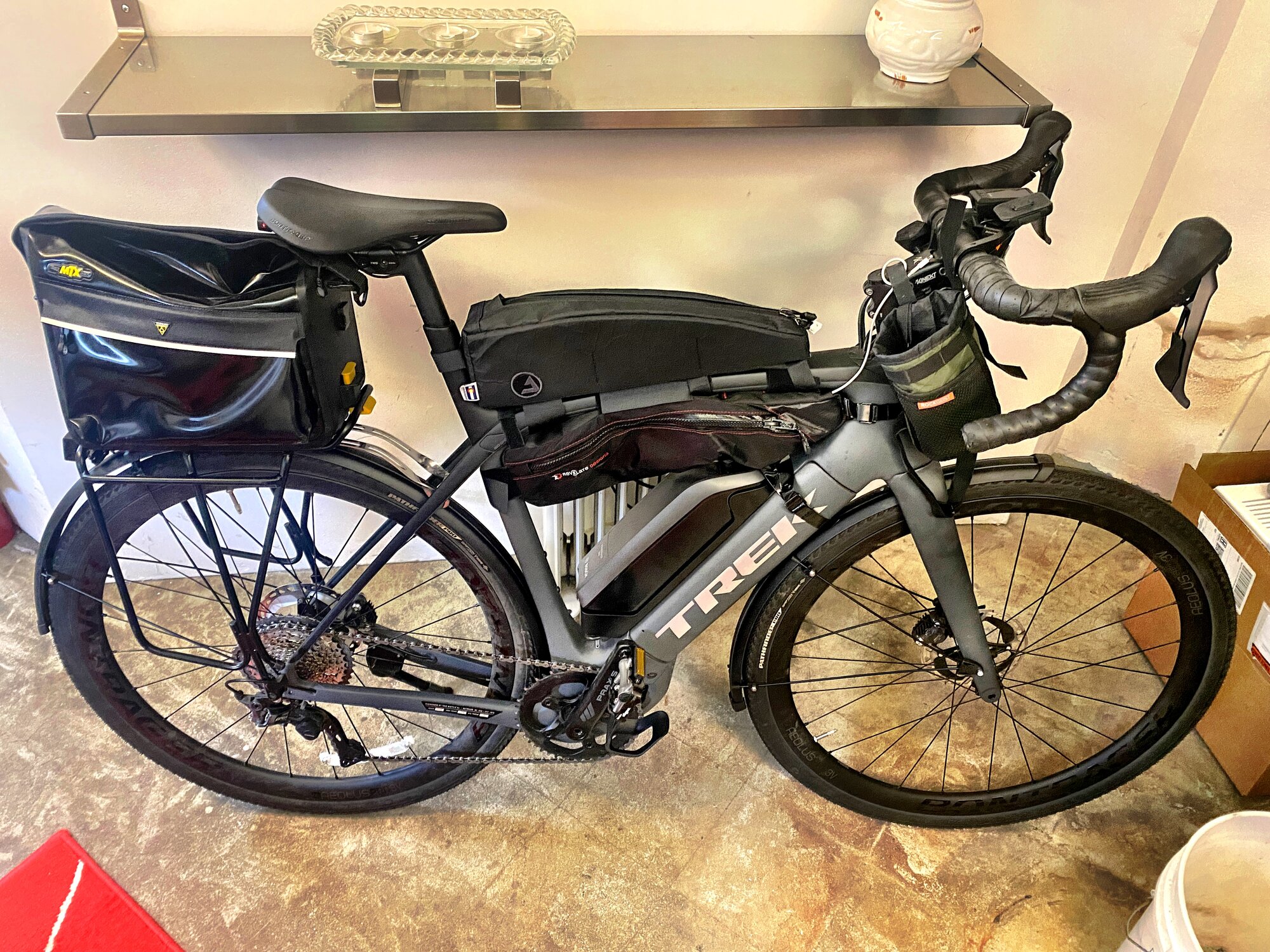

My 2021 Domane+ HP since July 2021 is now about 1120mi. Most time, I ride with Eco mode. Of course, for challenging hills - think Mt Rainier, Hurricane Ridge, and Mt St Helen - higher modes are life safer. You still have to pump hard tho’!
Changes I’ve made:
- upgraded wheels w Domane+ HP7’s standard version, a carbon, higher-volume, tubeless ready, about 1.5lb lighter each / awesome handling in gravel/road;
- added Topeak rear rack (note: this bike’s not design to include front rack);
- also Ortlieb pannier bags, Topeak MTX Trunk Drybag, Revelate Tangle, two others; and finally
- a Range Boost 500Wh battery add-on.
My present goal is to ride minimalistic long distance rider, inn-to-inn cycling adventures. Bear in mind, the maximum total weight limit for this carbon bike (combined weight of bicycle, rider, and cargo) is only a mere 275 pounds (125 kg)!
Somehow, the bike and I will manage.😄

Damn, that is one nice looking setup! You look like you can go for days with that setup! What is your range with the dual batteries?
At most I recall is a 3-day ride of approx 125 miles, the bike still had 35% charge left. It was mostly flat and about 2 major hills. When it gets closer to 30%, I get both the integrated 1000Wh batteries recharged.
What setting did you have it on if you remember?
