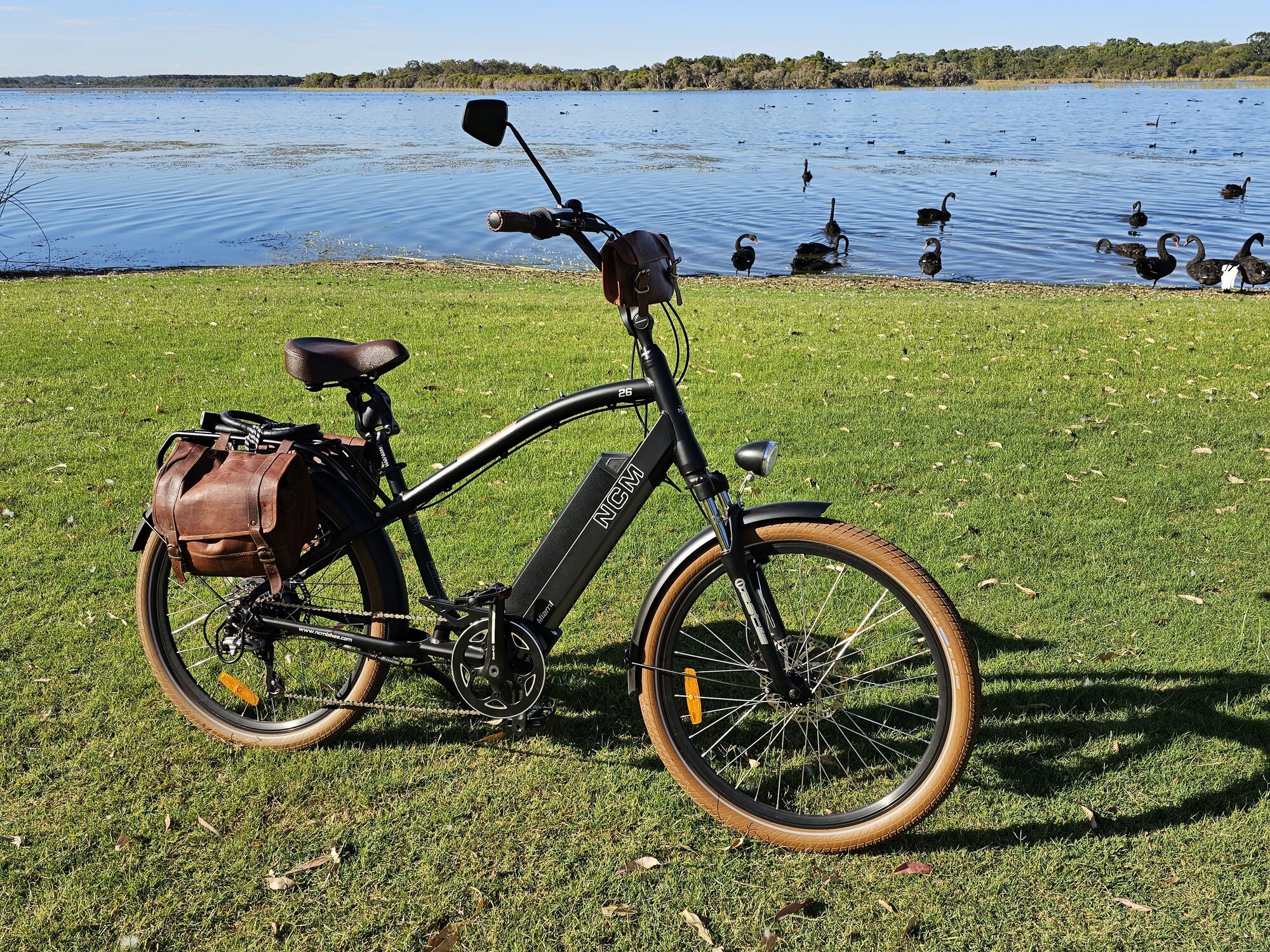

I recently bought the NCM Miami because I liked the cruiser styling. I was really after a bike with a bigger motor than my BH Emotion Diamond Waves 250W as I like riding along the ocean front but hate having to commute there. Now that I have moved inland I have to commute 14km to the seaside and want to do that as quickly as possible as much of the ride is on busy roads. I was lead to believe the NCM Miami could be upgraded to 500W when the motor became available after testing.
I purchased the bike and went of happy as Larry. I've fitted it out with a few leather paniers and a Thudbuster to make it both pleasing to the eye and more comfortable to ride.

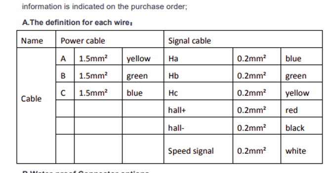

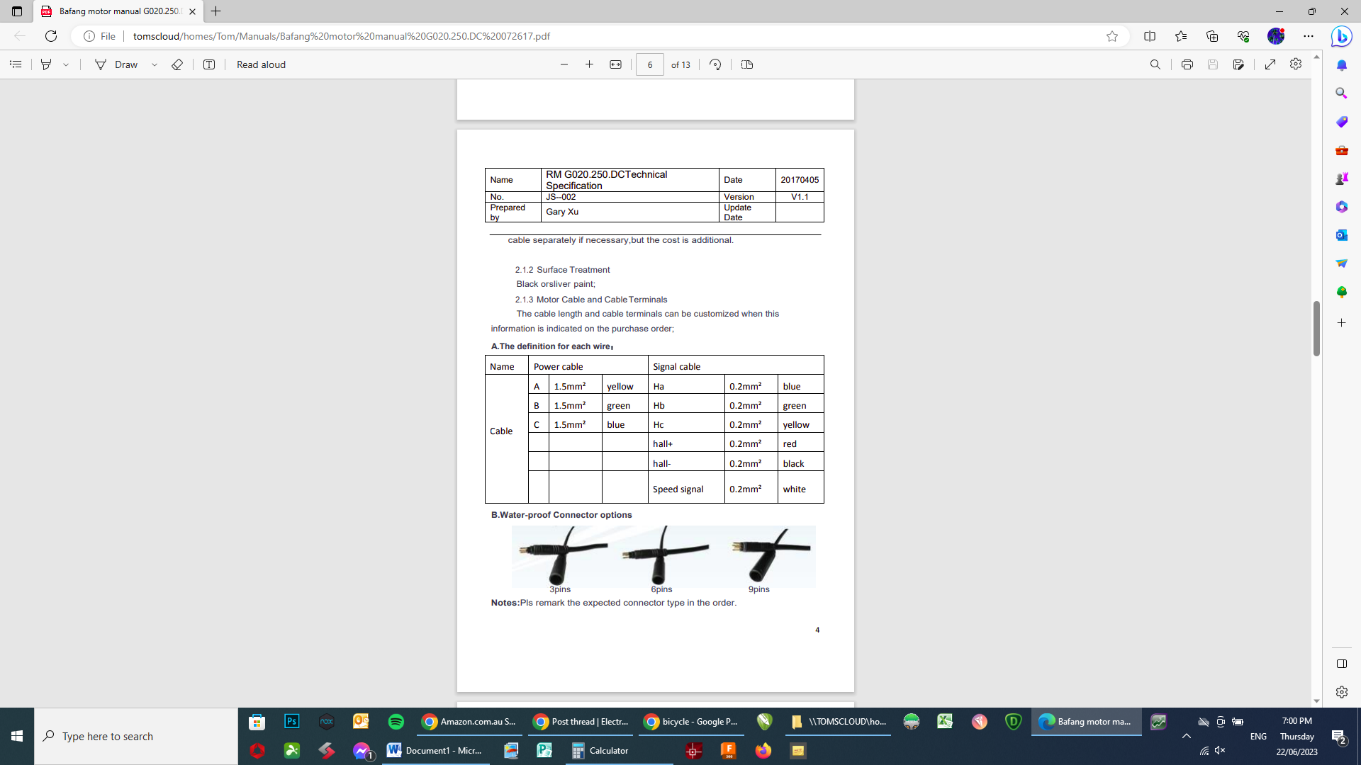

The motor is working fine but the display is showing an incorrect speed by a factor of 7.25 x . When the display shows 3km/hr, i am doing about 21 or 22km/hr on PAS1 . Fortunately the 6 PAS levels still sort of work. PAS 2 = 25km/hr and PAS 6 tops out at about 50km per hour with lots of peddling and going down hill. On a level road with light to moderate peddling i get to about 40 - 42km/hr. The motor wants to go faster but isn't getting enough juice unless I peddle harder. I also can't use the programmed maximum speed settings of 25, 32 or 45km/hr as the display never senses a value over 8km/hr when it is actually doing about 50 to 55km/hr.
Where do I go from here.
1. How do I get the display to show the correct speed. Is there a possibility that the cables to the new motor from my existing controller don't match up and I need to swap 1 or 2 of them to get the correct reading.
