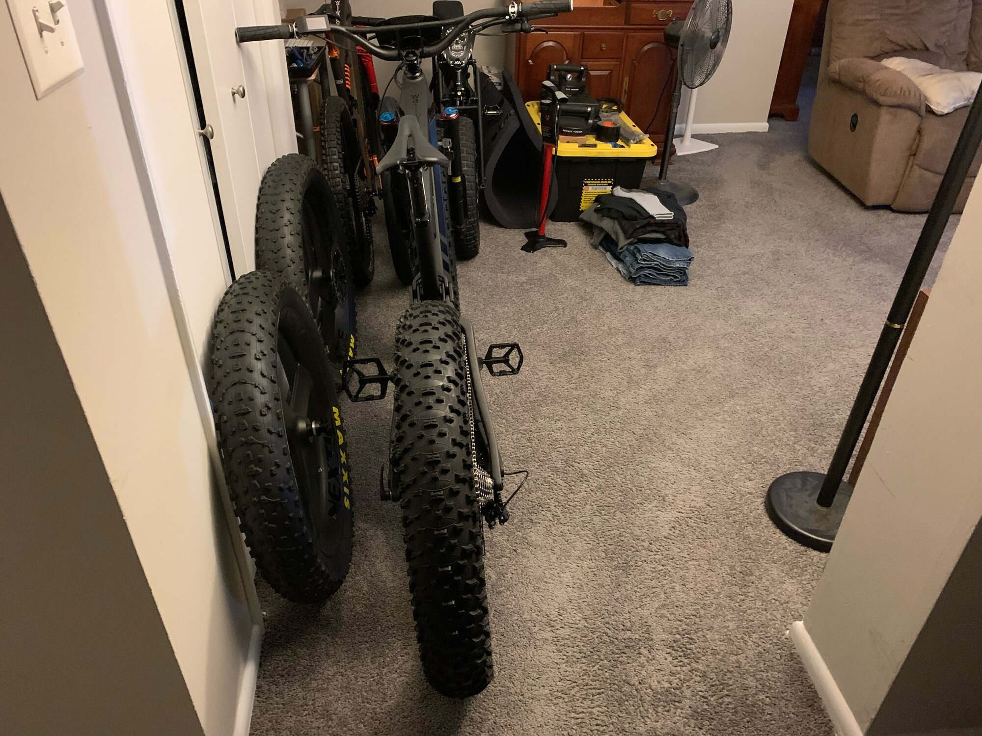

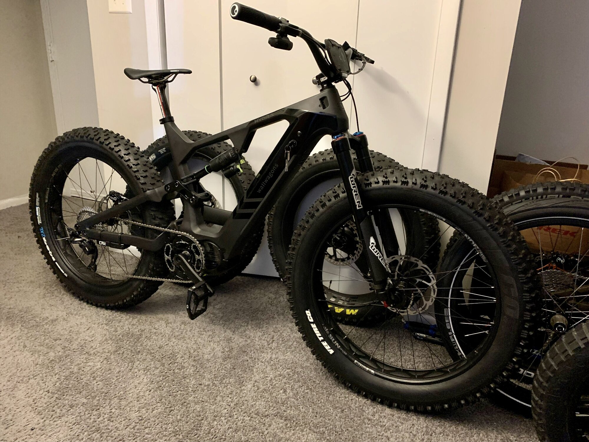

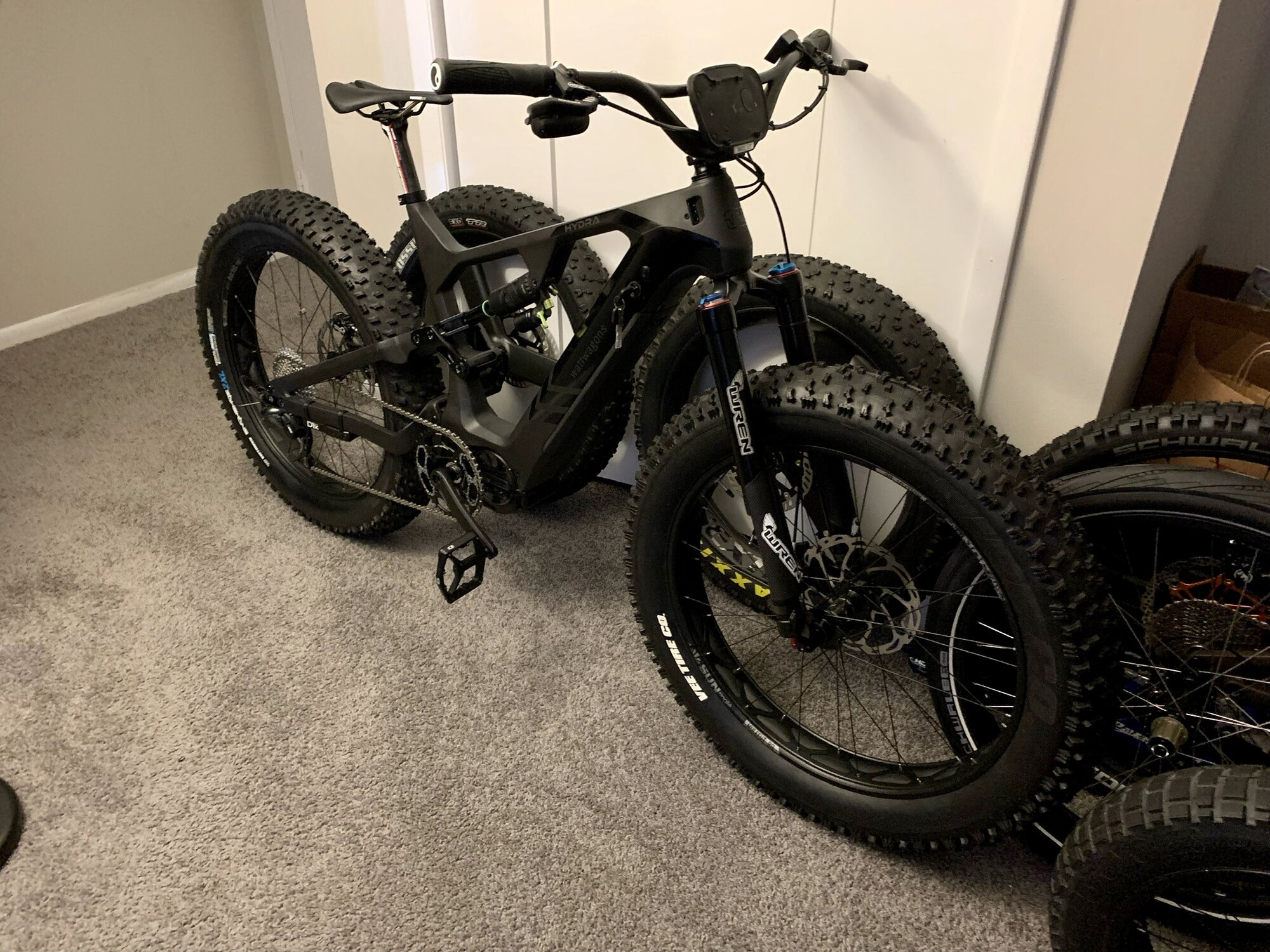

***Yes I know the tires are on backwards. Have to take them off and mount again with a larger tube***

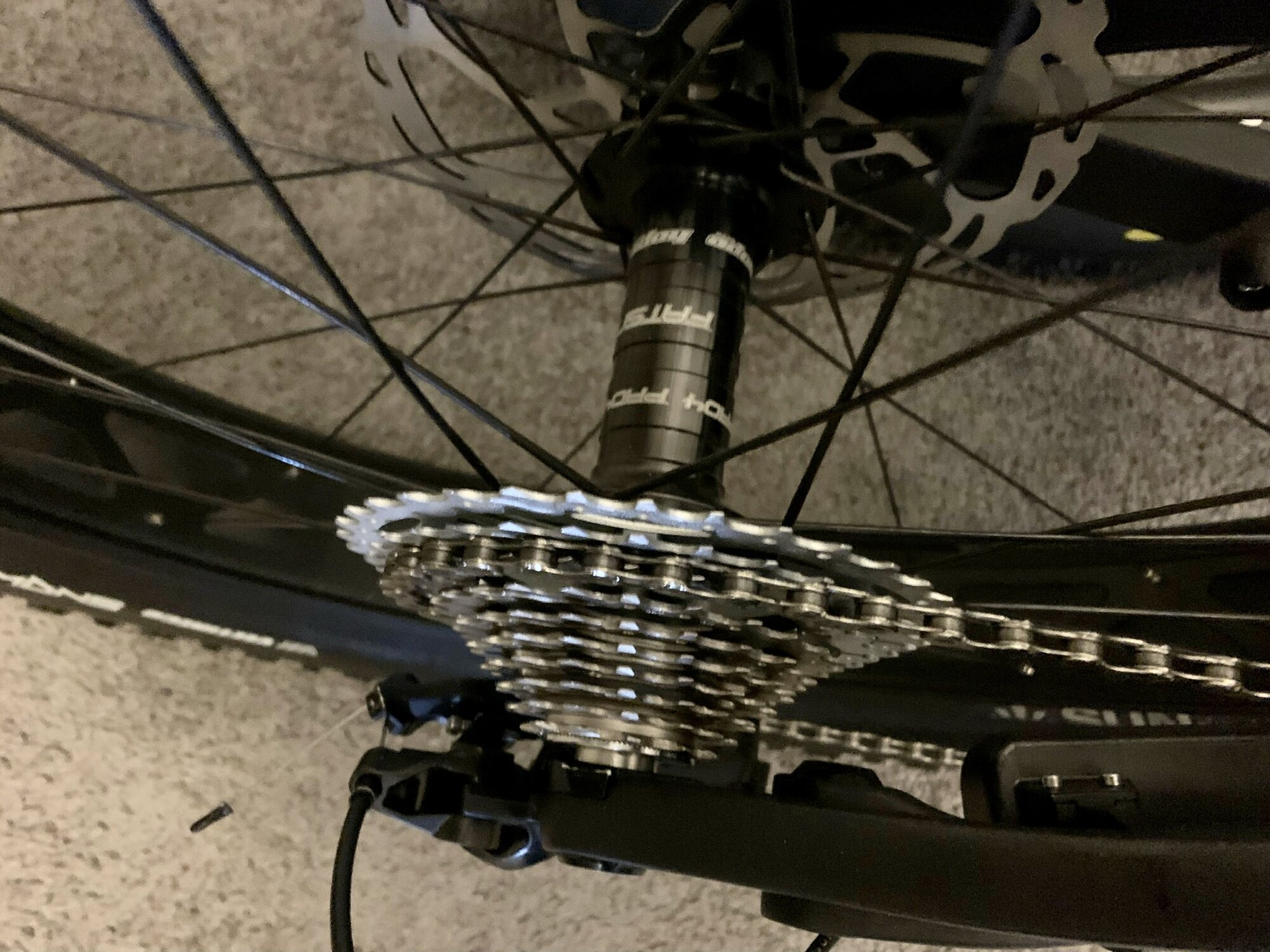

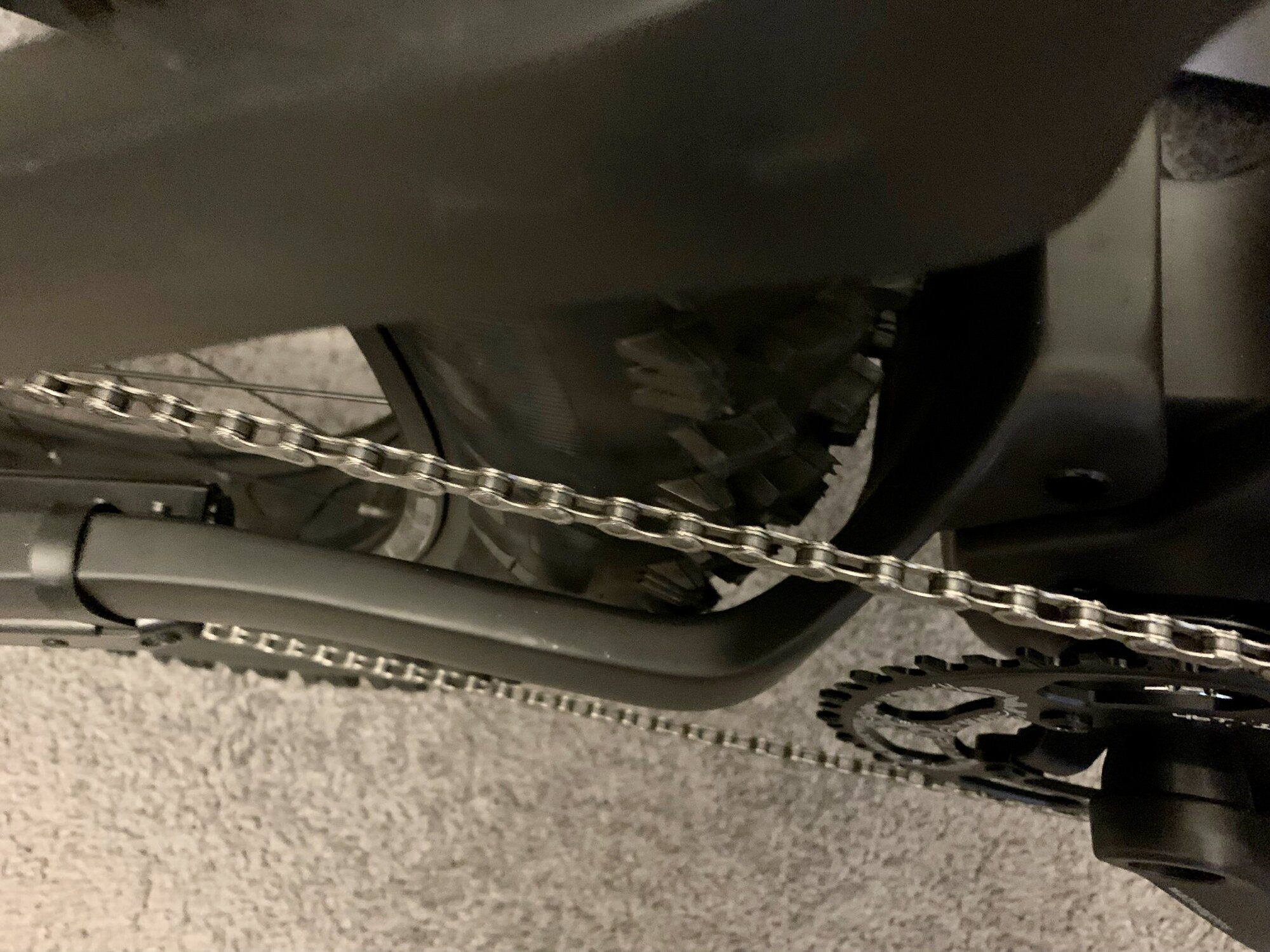

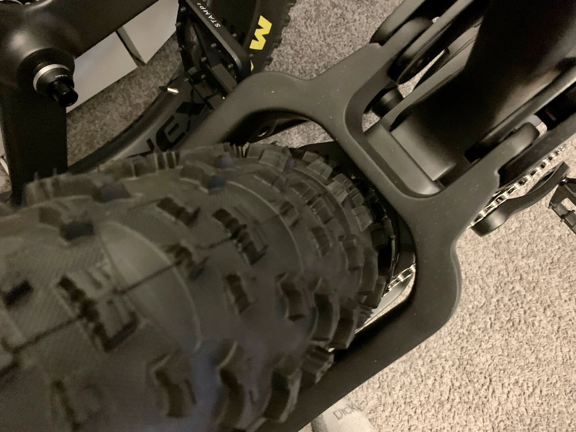

Holy crap they fit! Only issue is I can’t use the last two cogs but removing the first two cogs and spacing the cassette outward will fix the problem. The tires are mounted on 80mm Sunringle Mulfut wheels. This is the widest rim you can use the 2XL on for this bike. They are inflated to 10 lbs each. Need to get some tubes for 5.0 inch wide tires and mount them again. They should seat better with the larger tubes. Once that’s done it’s test ride time.
You're going to need a brush on a rear rack to keep the snow off those things and keep enough clearance! Wild that they fit. Wickwerks makes spacers & bolts for offsetting chainrings. I'm planning on running tubeless on mine but it's impossible to seat the bead without a tube or some serious airflow so I'm getting ready to order a little 1-gal compressor & prestaflator
