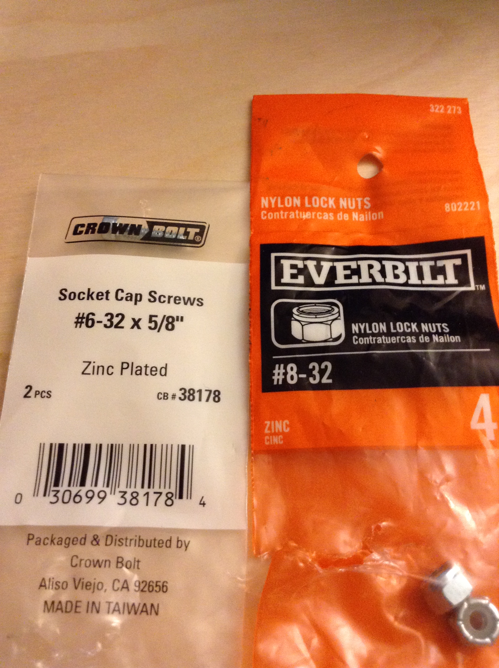

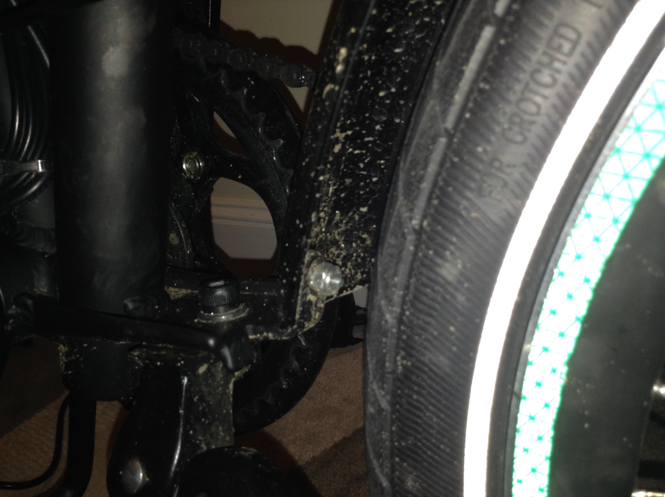

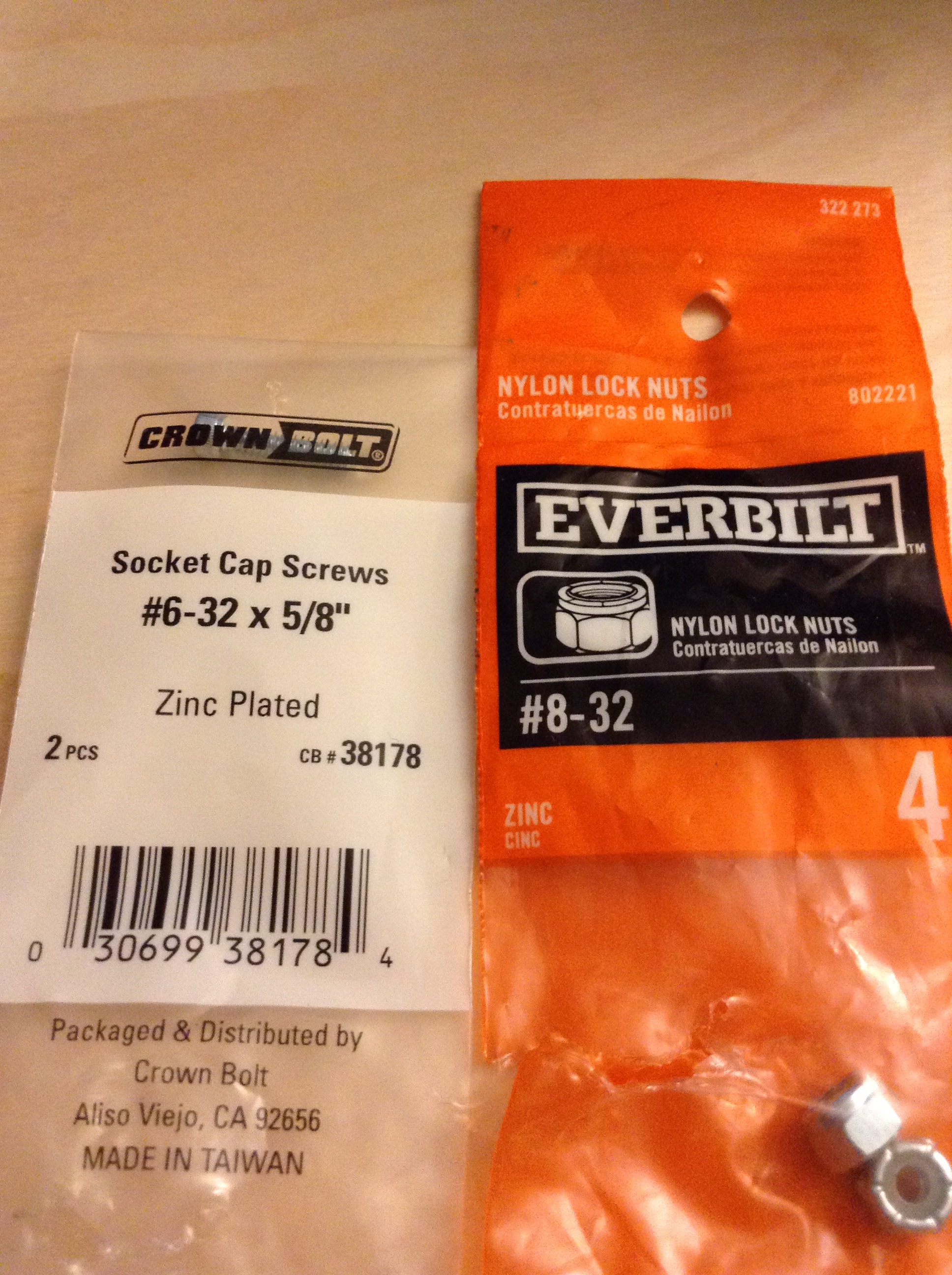

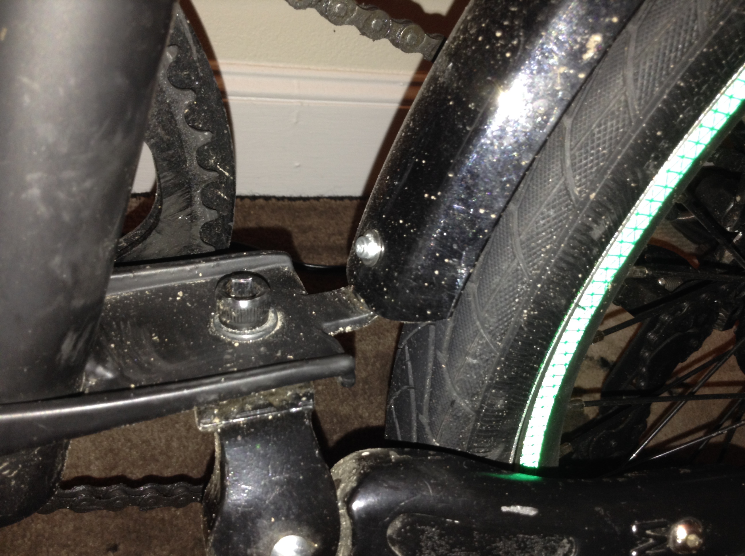

Hi Vandon,
I took the pictures of the parts for you (with sandy details after a thunder stormy day).
I am aware that on one of the pics, the screw's package says size #6-32, while the nut is #8-32, but I "think" that's what fit mine.
The reason why I say "I think" is that I bought sets of #6-32 and #8-32 for both screw and nut, just in case. And, one of the combination worked quite well.
As far as not being able to ship SE with a full fender, I think that is the next agenda for the company to consider. Meanwhile, people can use the hack I came up with. SKS fenders also matches the black color.
