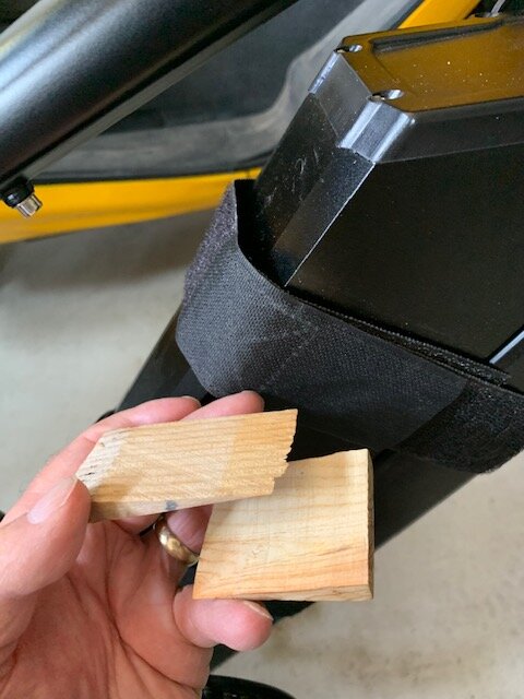

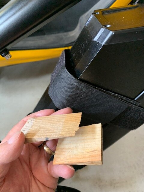

I had some intermittent battery connections issues early on. I salvaged these large Velcro straps and used them for securing the battery. I could not get them real tight so used small wedges under them to tighten them really well. One can buy cedar shake wedges at a lumber supply. They use them for wedging door frame etc.
Never again had a problem with intermittent connection since.

View attachment 65529"I am going to strap the battery. It honestly feels like it's rock solid tight/locked in as it is but maybe it's the microscopic movements doing it so I ordered straps the first set I bought were 14" and it's too short so I am ordering 18" straps now to see if it will work."
That's a good solution too, i use rubber strapes that i can get very tight.
