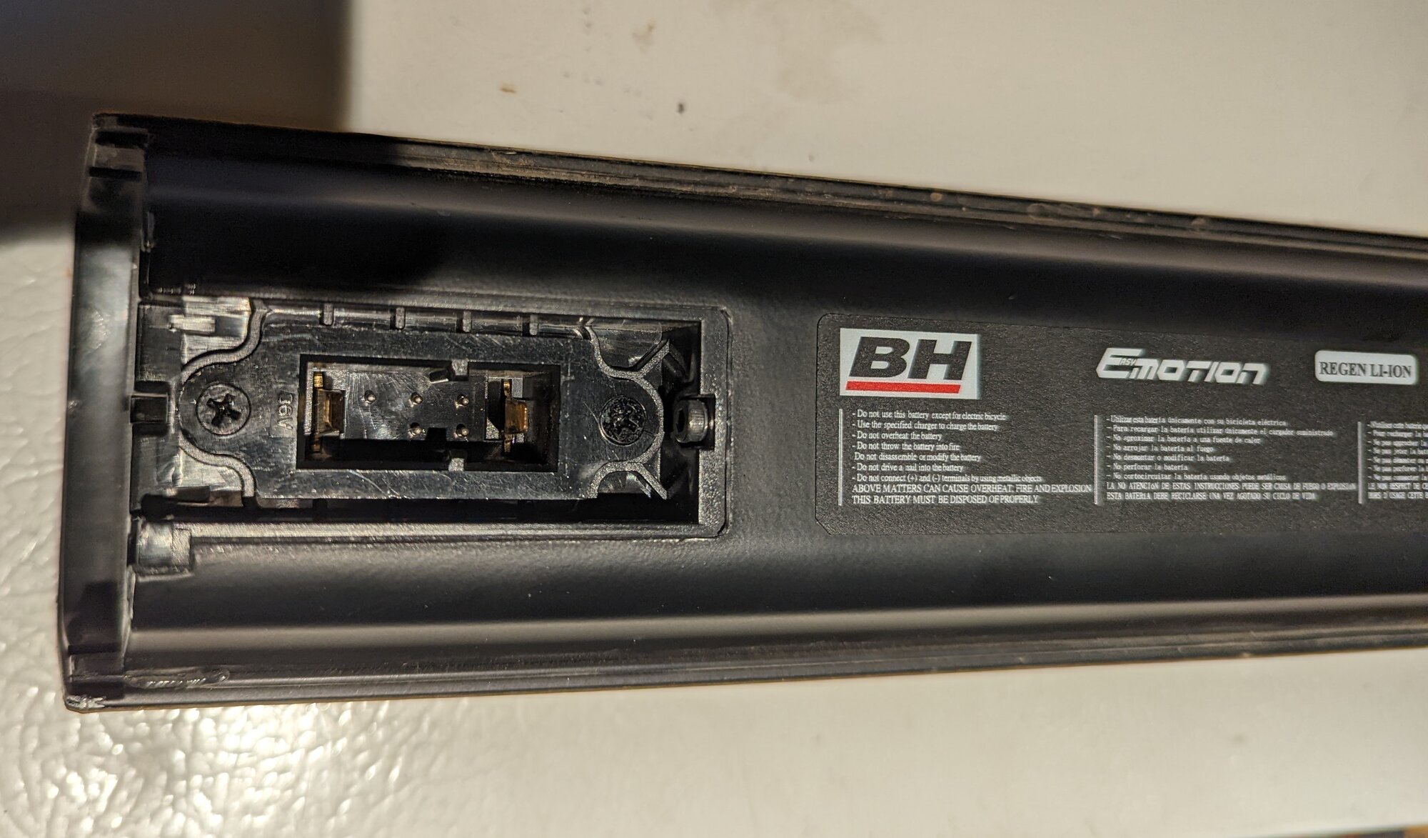

It is a Brose motor. The battery is well and truly dead. Non-responsive even though it is totally cooled down now (overnight). I've emailed to BH in Spain. Heck, we are going to Spain in October, I could bring one back with me, except I doubt if one can bring it on the plane. How do batteries get shipped? By sea only?

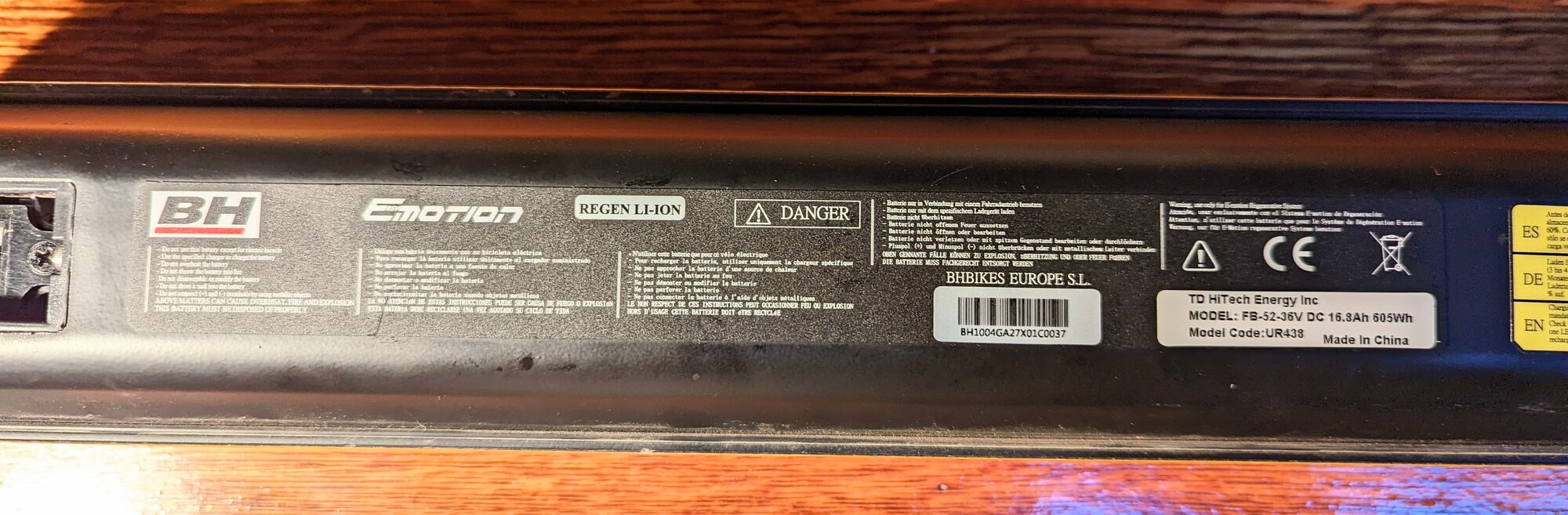

Battery lists TD HiTech Energy Inc as the manufacturer. I have emailed them, too.
