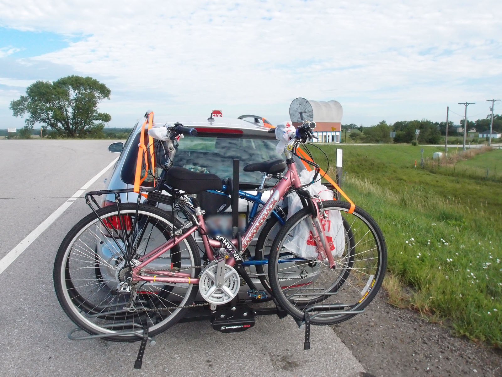

This is my swagman carrying maybe 90 pounds of bike and 2o pounds of locks/chains. The hitch was hitting the pavement when we pulled into gas stations. We went 2500 miles. I took off the seats for the trip home.
