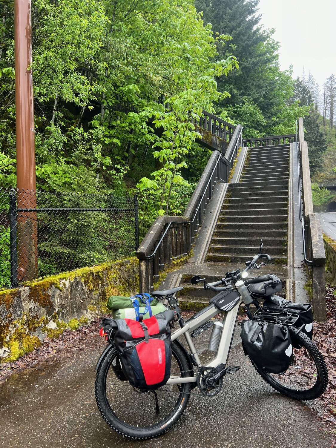

My R&M Supercharger is the best I have ever ridden, with one exception - the Rohloff. It is down for the 2nd time. This time it cut short a solo tour on the Oregon coast after 1200 miles. After 2.5 months, the e-14 electronic controller arrived today, installed and did not resolve the issue. Identical error codes and issues. Shifts through 3 gears only and the gear it is in does not correspond with the gear displayed on the Kiox. Already missed second half of my spring tour, missed my summer tour and now concerned about the fall tour. Looking for a Supercharger with anything but a Rohloff while i try to resolve and sell the one with the unreliable Rohloff. First issue was a leak that was warrantied. Rohloff service in US is very difficult. Propel is doing a good job, but without the bike it is tough for them no matter how hard they try and even though they are clearly expert, competent and eager to help. Just posting to say "beware" of all the hype around Rohloff reliability. Since posting in related threads, I have now seen quite a few with similar experience. My guess is the YouTube videos with the exotic tours in exotic places are sponsored by Rohloff, because I'd have zero confidence in Rohloff anymore.
