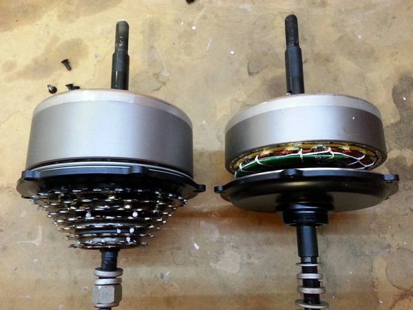

As mentioned, just because it says "750W", it doesn't mean it has real 750W motor.
Motors can be overvolted relatively safely, you might have overvolted 350W motor.
I believe you have Bafang G060, however, they had different variants.
As you can see, when you open up the motor, it is completely different.
Externally, they all look like this:
But once you open it up, Bafang had different variants of G060.
It will usually say G060.350DC, G060.750DC, etc..
The "real 750W" motor has heavy duty magnet, coil, stator, etc.
