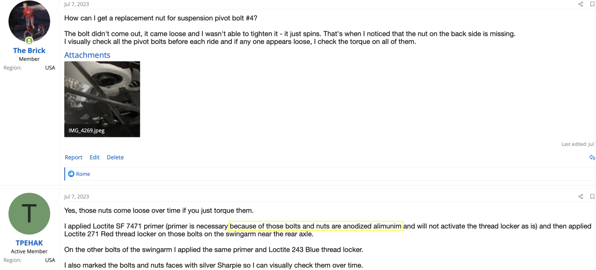

How can I get a replacement nut for suspension pivot bolt #4?
The bolt didn't come out, it came loose and I wasn't able to tighten it - it just spins. That's when I noticed that the nut on the back side is missing.
I visually check all the pivot bolts before each ride and if any one appears loose, I check the torque on all of them.
Yes, those nuts come loose over time if you just torque them.
I applied Loctite SF 7471 primer (primer is necessary because of those bolts and nuts are anodized alimunim and will not activate the thread locker as is) and then applied Loctite 271 Red thread locker on those bolts on the swingarm near the rear axle.
On the other bolts of the swingarm I applied the same primer and Loctite 243 Blue thread locker.
I also marked the bolts and nuts faces with silver Sharpie so I can visually check them over time.

Yes but I was hoping for a quick reply, thus the post here. If I can get a nut so I can ride this weekend, that would be nice.
Edit: I just checked my email and they responded back three hours ago but I missed it. Biktrix is sending me a replacement nut/bolt.
Earlier this year when I noticed that the front lower bolt came loose, just like your's did, I started to visually check them. After I put on the locktite, it hasn't loosened up since. This one never appeared loose but came loose on a ride earlier this week. Without knowing, the bolt fell off. I don't know if the nut is supposed to be anchored in the carbon fiber or not. I checked the other side and it was only hand tight.
I received the nut/bolt/washers/o-rings today from Biktrix. Loctite blue is pre-applied on the bolt.
Yes, but that blue threadlocker on those bolts sucks. The bolts have pretty loose fit and that threadlocker does not work at all. I would strip that blue stuff from the bolts and apply Loktite activator and Loktite threadlocker.
I looked at the technical specs of both and there was one item that didn't make sense. It inferred that the primer/activator sped up the curing process for the thread locker, but it didn't clearly state whether or not curing would occur if the primer/activator wasn't used on inactive metal. So, I called Henkel. Their consumer division wasn't sure so they transferred me to their industrial division who understood the primer better.
The tech I spoke with explained it well. The anodized aluminum nut and bolt will not oxidize, and without oxidation, the thread locker won't work. Any primer that has active iron will oxidize on the surface that it is applied to. Furthermore, Loctite 242 will not cure without a primer being placed on one of the parts.
So, he suggested putting a primer on the nut and the Loctite on the bolt. After torquing to spec, let it cure (1 hr).
