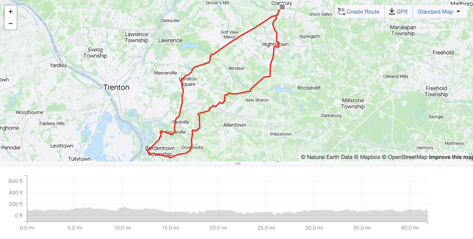

The bike club I participate in had a 40-mile ride this morning. Elevation was 1,000 ft.
So upon starting out I plugged in the specs into Smart Control, 45-mile ride, 1050 ft. elevation, 75 ft. (whatever that setting was), 15% remaining at end of the ride (reserve).
Actual ride stats were 41.88 miles, 966 ft. elevation, 2 hr. 50 min ride time.
Upon returning and at the end I had 40 % remaining on the battery.
A phenomenal experience, absolutely perfect.
You might have returned on 15% of the battery.
Rely more on the Range and Range Trend data on your Mastermind display.

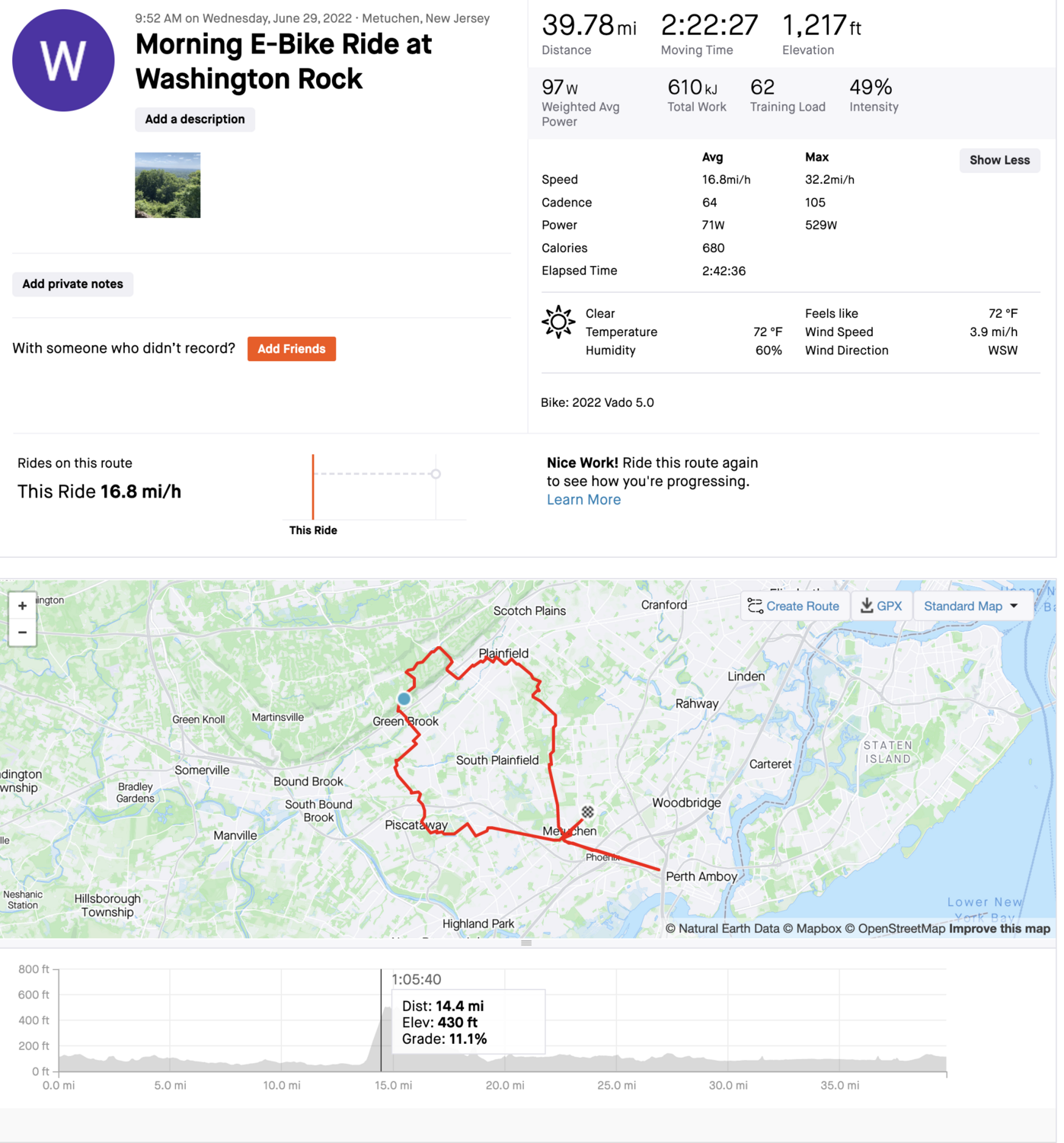

So, as an ongoing experiment, I've been using Smart Control every day, attempting to predict my total distance, etc., and pre-configure the software prior to departure.
Today, I figured I'd do 40 miles, but as a safety zone, I put in 45 miles, 15% remaining battery with 950 ft. of elevation.
I did the 40 miles and returned with 25% of battery.
The very best part of using Smart Control is you are consistently provided all the power needed at almost all times.
Sure, pedal harder when required, consistently shifting gears, but keeping cadence as consistent as possible achieves my most pleasurable rides.
The ONLY time I had to override Smart Control and use TURBO was on the 11.1% grade, which sucked 9% of the battery.
Upon using Turbo it would occasionally kick out of Turbo back into Smart Control a few times while climbing, I kept putting it back into Turbo until I reached the top of the climb.
Smart Control did not provide enough assistance for the 11.1% grade.
I'm not complaining, just sharing.
Overall, the Smart Control is a phenomenal feature that I'll continue to use as frequently as possible.
Screenshot attached.
