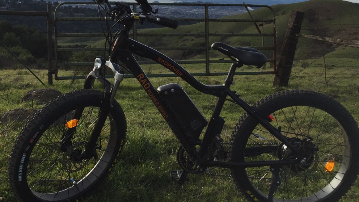

View attachment 13420 Changed out tires for the maxxis minions 26x2.5. Better for mountain biking.
