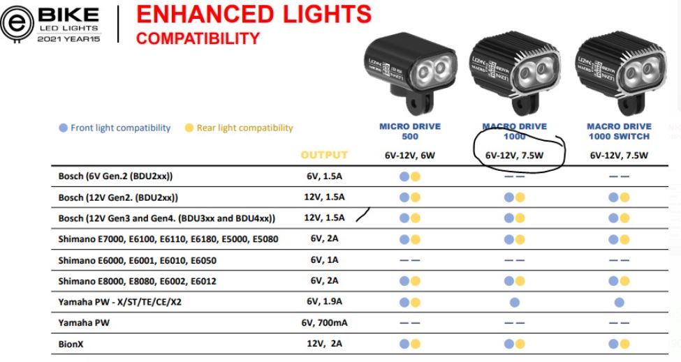

Hi
i'm user of a Bosch G4 625wh bike,
recently my dealer activate the light plug to connect a 7,5watts light
Lezyne E-Bike Macro Drive 1000​
and the config was 18 watts output... this do a reserve of 11% of battery, to big for me.
recently i went to my dealer bosch and change 18 watts for 3 watts output, and reserve change to 3% of battery.
i Think watts only do it´s calculate the reserve, because light its 7,5 watts and it´s working fine with 3w and 18 w config.
could you confirm this?... thanks.
