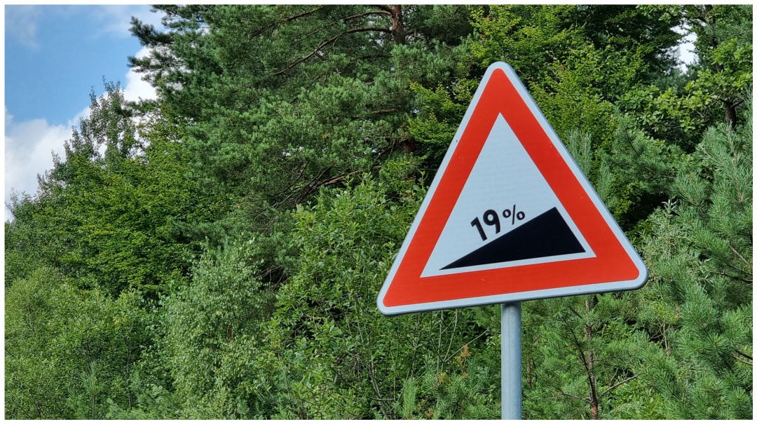

There is so easy technique to downshift when stationary on a decent mid-drive e-bike. While standing and straddling the frame, you pre-downshift with the shifter (good shifters allow three gears at once). Then you lift the rear wheel by the saddle with your right hand and press the Walk Mode button with the left one. The cranks starts to spin, and then click-click-click you are in a low gear.
How do you think I took that photo? Yes, I stopped before the road-sign, and took the photo. How to move my mid-drive e-bike uphill at that grade without the throttle then? Simple. I downshifted while stationary all the way to the granny gear with the technique described, then started riding.
There's also the method where you point the bike downhill, get your balance and downshift to the necessary gear, and do a 180 degree turn....

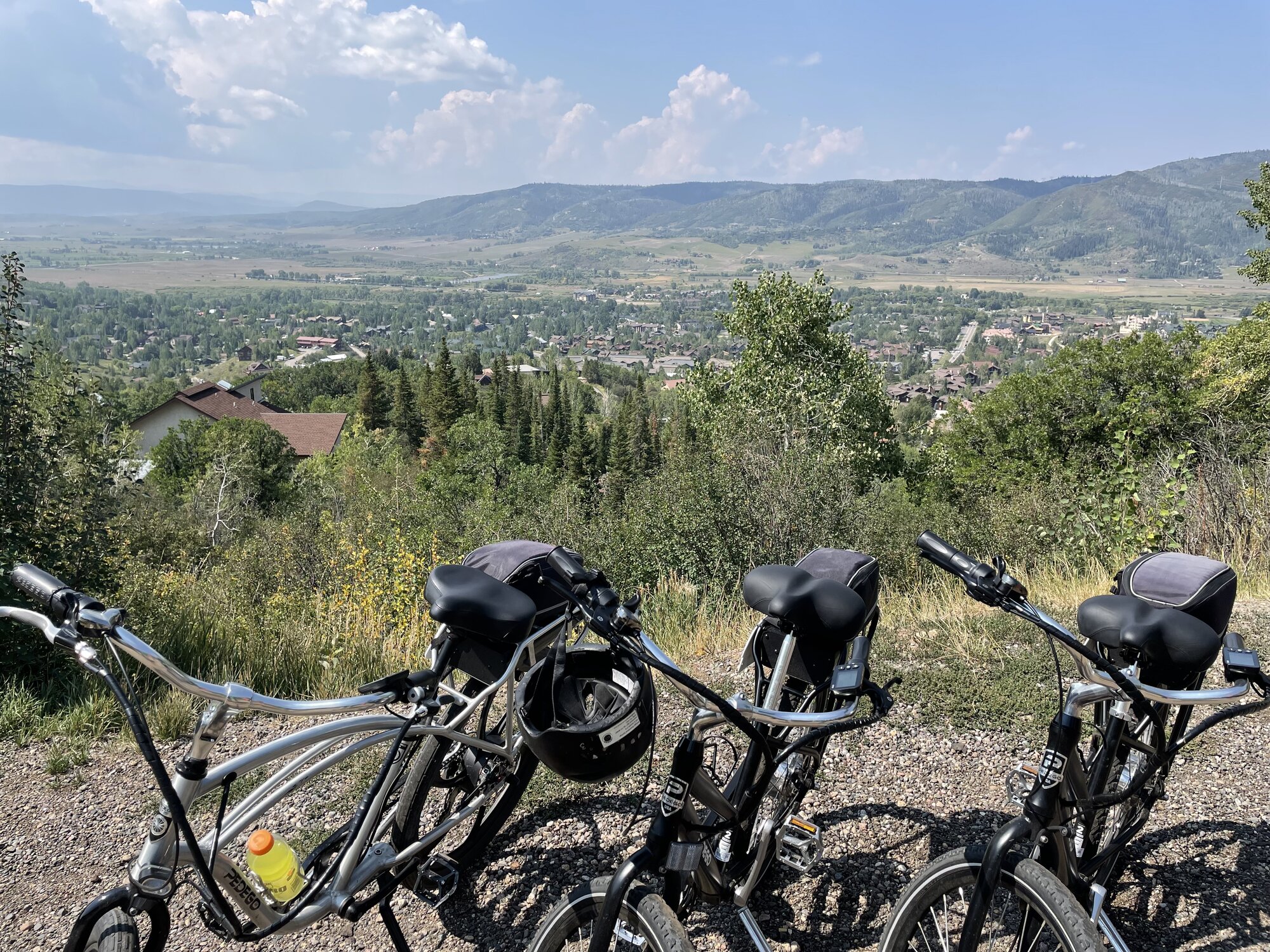

I’m a little more confused now. We rented Pedigos today, rear drive. They were 350 watt and seemed like they had more power plus they had a throttle. I didn’t like the style as well, more of a cruiser style, but the power was impressive. They seemed a little less smooth than the pulls in the way the pedal assist worked. I asked the shop that rented them how much? Maybe a little more than the Treks we were considering but in the same ball park.

Not that it should make any difference one way or the other, but not fond of the Pedigos styling here either. Just to let you know you aren't the only one.....
Also, the battery mounting position so high up so far back. I need to pull the bike over quite a bit in order to swing my leg over the rack and seat. When I do that with a bike like this, the front tire has come right off the ground, while the battery weighted back end goes right down - leaving me standing over a mess, or worse, pulling me right in on top of a mess. Some will talk about "balance" with a bike built like this being an issue. If you were doing just the step through thing, it likely wouldn be near as big a deal, as you would no longer have the reason to pull the bike over when mounting/dismounting.
Beautiful pic. Building the memories already!
As I have gotten older I tend to mount the bike by swinging my leg between the seat and handle bars so not a problem there. I did pick the bike up and it was very tail heavy and seemed heavier than the Bulls.
The pic is on the mountain overlooking Steamboat Springs Colorado. It looks off-road in the pics but this is at the end of the road. We road by multi million dollars home to get there probably gawking the entire way.
