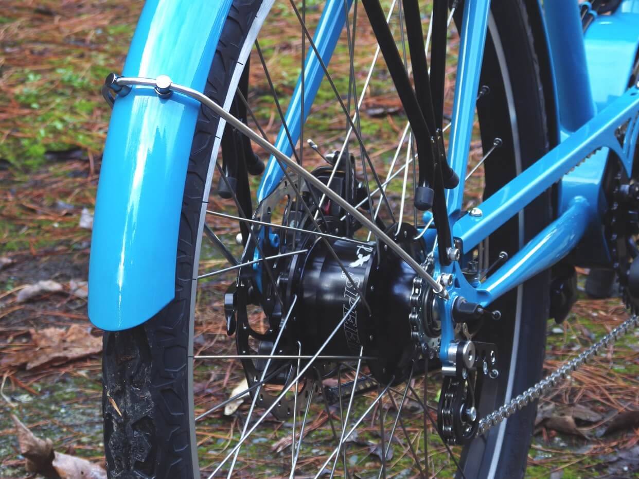

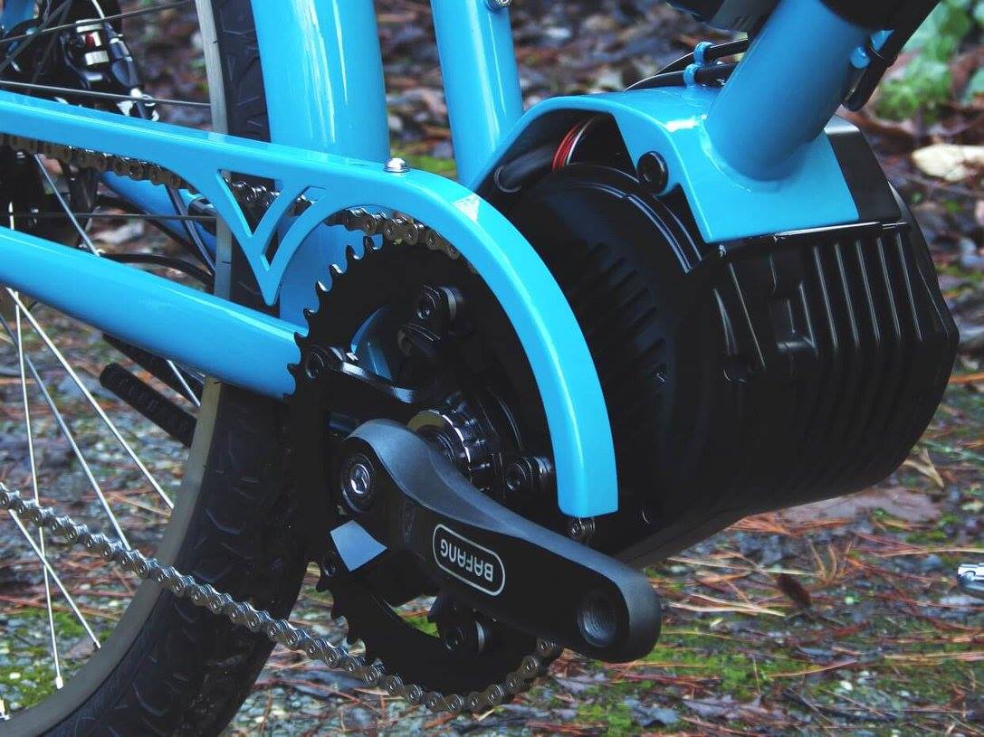

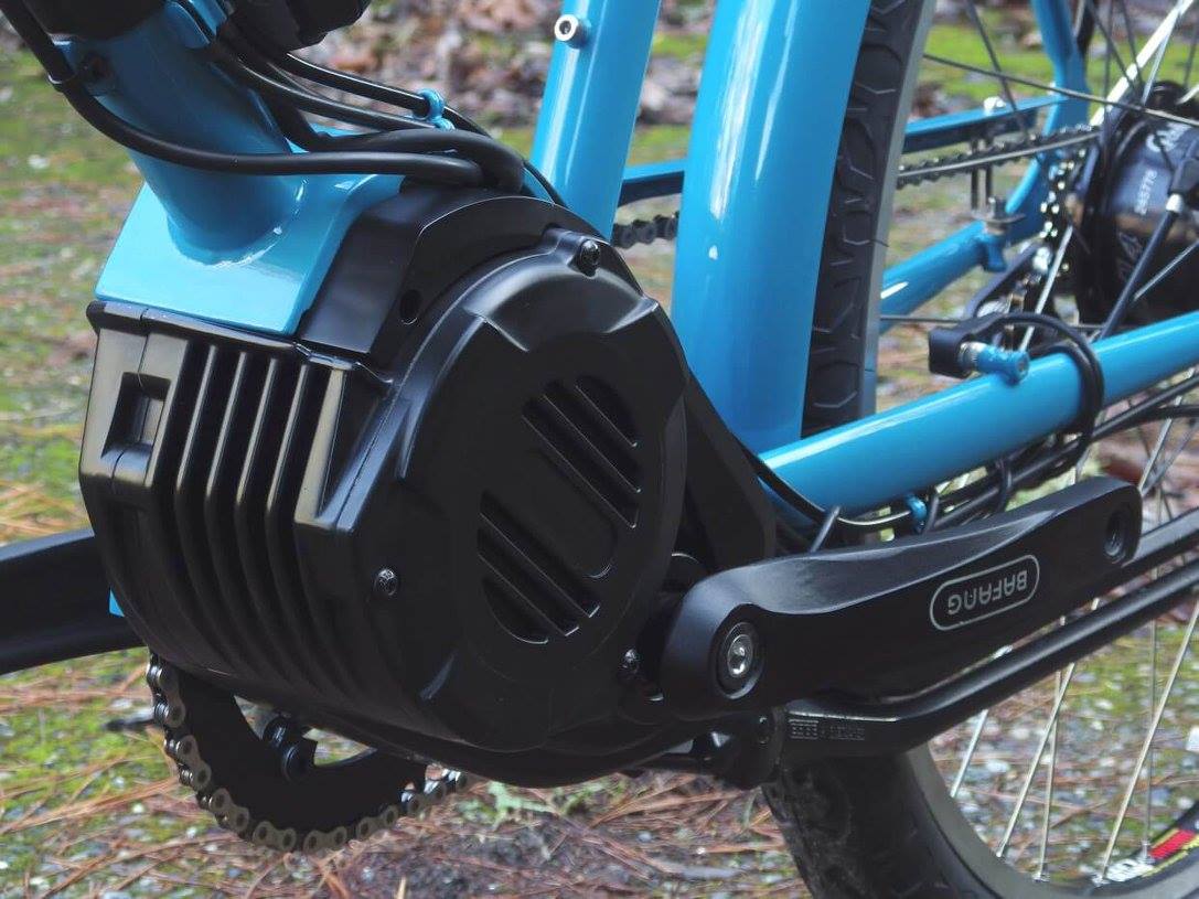

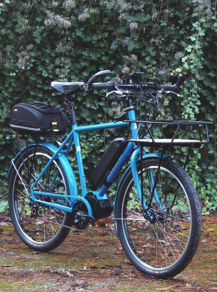

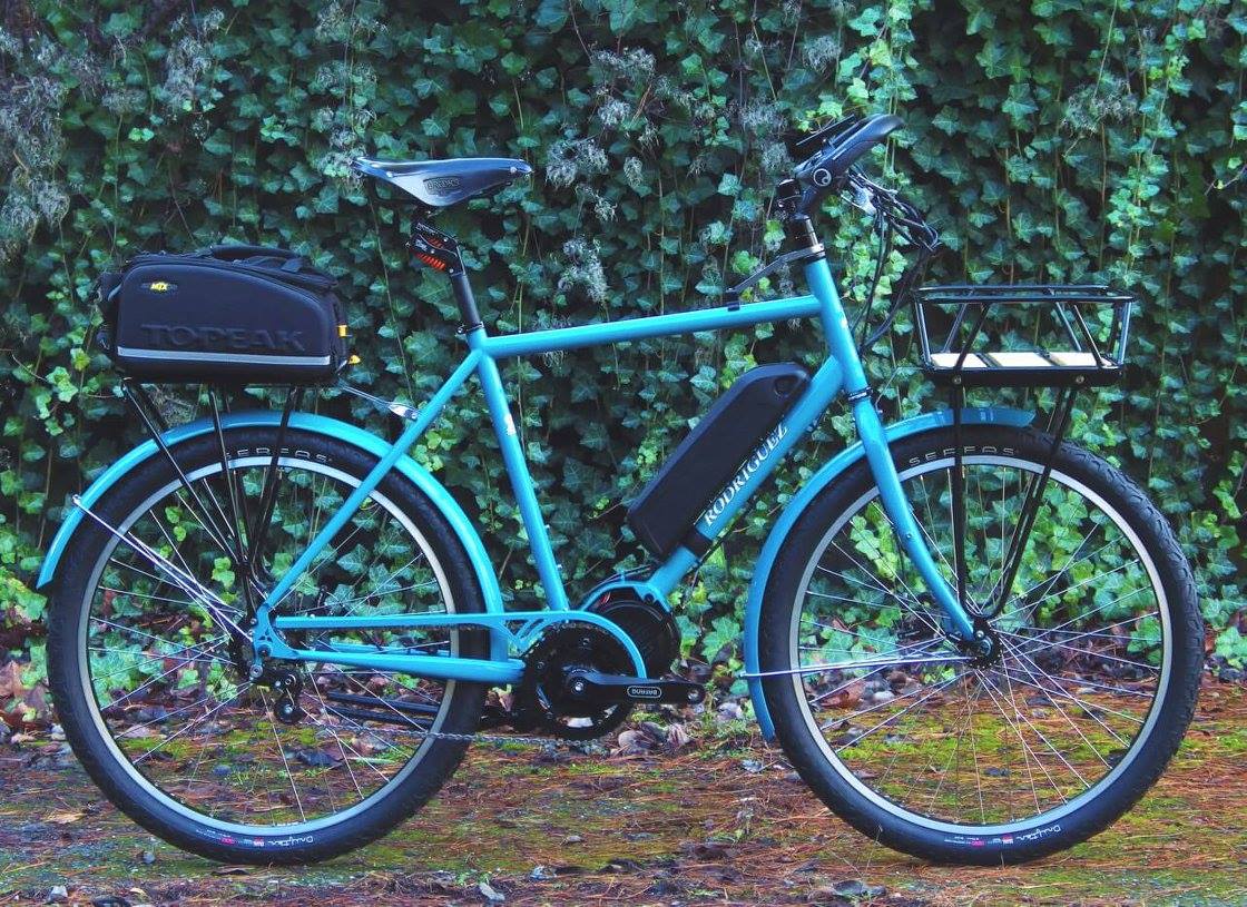

R+E can fabricate a frame that will take a belt drive and Rolhoff. They did it for a chain version and here is a pic.
Apparently there are more pics that are unposted so here they are.
