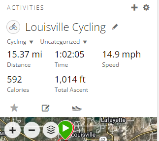

Hills greater than 1000ft in an hour is easily done with a quality hub motor, Pretty much every ride I do is 1.5 hours and 1500ft elevation gain which equate to the same and my 52V 10t GMAC with 30amp limit(about 1500w) handles it easily (a 12t would handle it even better). The climbing is only 1/2 of my ride or less. I am using a cycle analyst and phaserunner with temp sensing and limiting. I do the exact same rides with a 52V BBSHD at 30 amp limit.
Its more about how much power you are putting down with a hub motor vs the hill than a blatant hub motor vs hills analogy.
Same thing with my 52V juiced CCX at 1000 watts. While it got hot at times, after 18 months of abuse no signs of overheating(blackened/smelly coils) when I looked in the innards of the hub motors.
I live in the rockies(colorado) and have never been denied any purchase because of my location
Attached is a simple example. To put it into perspective the climb was only 20 minutes of the ride so thats 1k elevation in 20 minutes. This was a 'fitness ride' with 1.5x assist and motor output usually at 300-500w. No doubt you would overheat if using just throttle at 1500w.
