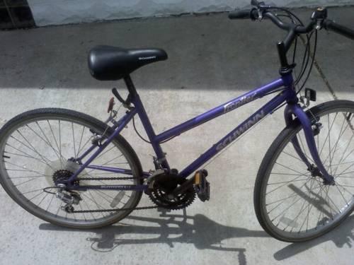

I am looking to convert an old Schwinn Frontier women's bike to an e-bike. I don’t want to spend a boatload of money doing it.
I am concerned that there is not enough room between the top and lower tubes to put a battery there. Also, the bike has rim brakes. Should I be concerned about having too big of a motor?
I welcome any suggestions you have regarding components, kits, etc.
Thanks!
BTW – The bike looks like the one pictured below.

Do a small hub motor for the front wheel. You will end up with a 2-wheel-drive bike that will be surprisingly effective thanks to the rider's ability to add oomph by pedaling the back wheel. Front wheel drive also lets you leave the drivetrain entirely alone. No fooling with the complex stuff necessary.
A bike like this is not suited to anything big and bad. And a front hub motor is also not suited to a powerful build. So its a good fit for a light duty fwd bike. It looks like you have a chromoly fork which is what you want (NOT alloy under any circumstances).
Disk brakes should be considered as required basic equipment, but with that said, you have cantilever brakes on that bike and they should be fine for a light duty like this. If anything they will be more than enough. Especially after you go out and find new, aggressive pads.

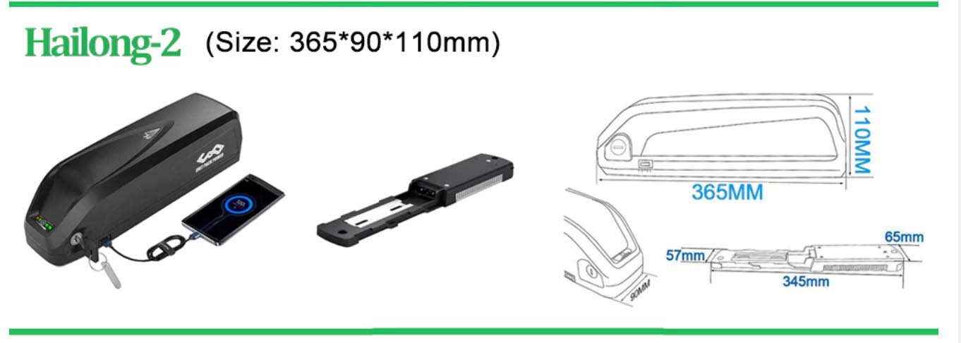

One of the small Hailong-style cases should fit on that bottom water bottle bracket. Batteries on the top are in the way of feet trying to mount the bike. Also you will have to drill the frame to do a decent job of a mount. Before I mounted it up top I would bite the bullet and put a rack on and mount the battery there. Rack mounts are sort of a sin among the hot rod DIY community, but reality is on a bike like this you'll never feel any difference with the pack's weight on the back and up high. This isn't a singletrack bike.

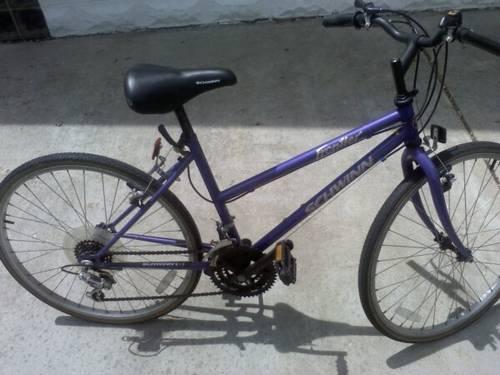

BTW – The bike looks like the one pictured below.zz
View attachment 140208.
The Hailong2 battery case will probably fit, except you'll have to redo the mounts. You probably have the water bottle holes in a different spot, so the battery cradle can be drilled to use them. You probably to use the existing cradle holes for extra strength,
You can get 48V14Ah in that case. Plenty of power, in my opinion.
